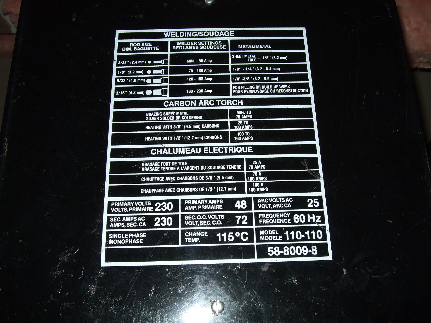

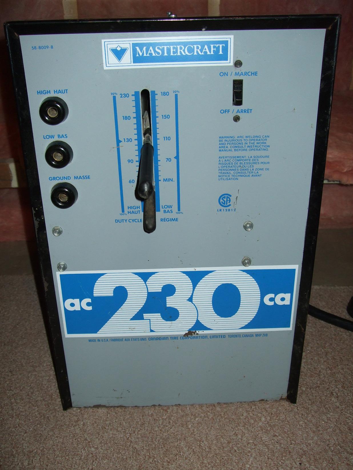

Hey,
Update...I couldn't get that Dayton AC/DC welder.
Anyways...I found a 230A AC welder locally for $75. Good price and looked in good shape but I haven't seen it work / tested it.
The guy said he bought it for his cabin building docks. He hasn't used it in years since that project and was cleaning up. I took his word that it works. Plus I figured that there is not much that could go wrong with it.
The welder I got is a Mastercraft (Canadian Tire) 230A AC welder. I think this might be made by Century for Candian Tire. I want to try and confirm who makes this house brand welder.
I cleaned it up a little on the inside and outside. Everything looks normal inside and I'll try it as soon as I wire in the 50A plug in the garage. I already upgraded my circuit breaker panel the other day and now have a 50A breaker in there for a welder circuit.

I assume that you used the correct sized wire for the 50 amp circuit relative to the distance from the breaker box.
/ My new welder #3
The welder looks like new. PO must have stored it / used it in well protected space. Not much to go wrong with them except maybe a lightning strike that burns out the transformer. If it doesnt smell burnt, then it is likely OK. Congratulations on your find.
/ My new welder #4
That looks amazingly like my old Century ac/dc unit. It died about 3 months back, but served me for nearly 15 years
/ My new welder #5
Yep looks just like a Century, Well sorry the AC/DC deal fell thru, but you should be able to get a lot of good out of this one, especially for $75:)
James K0UA
/ My new welder #7
Nice find for 75$ you can't go wrong.You will get a life time of use and if you want to upgrade you will get what you paid for it.

HOORRAY...It works! I wired the 240V in the garage today and connected the line to the panel. The 50A line and welder test successful.
I grabbed an old rusty piece of steel, a 1/8" - 7014 rod from the open box (came w/ welder) and fired it up to about 125A. I played around laying a bead and making a puddle of molten steel. It has an easier arc strike than other welders that I've used. It held the arc very nicely and was easy to control. Pretty nice with the auto-darkening helmet too!
Now for the first project...a welder cart.
