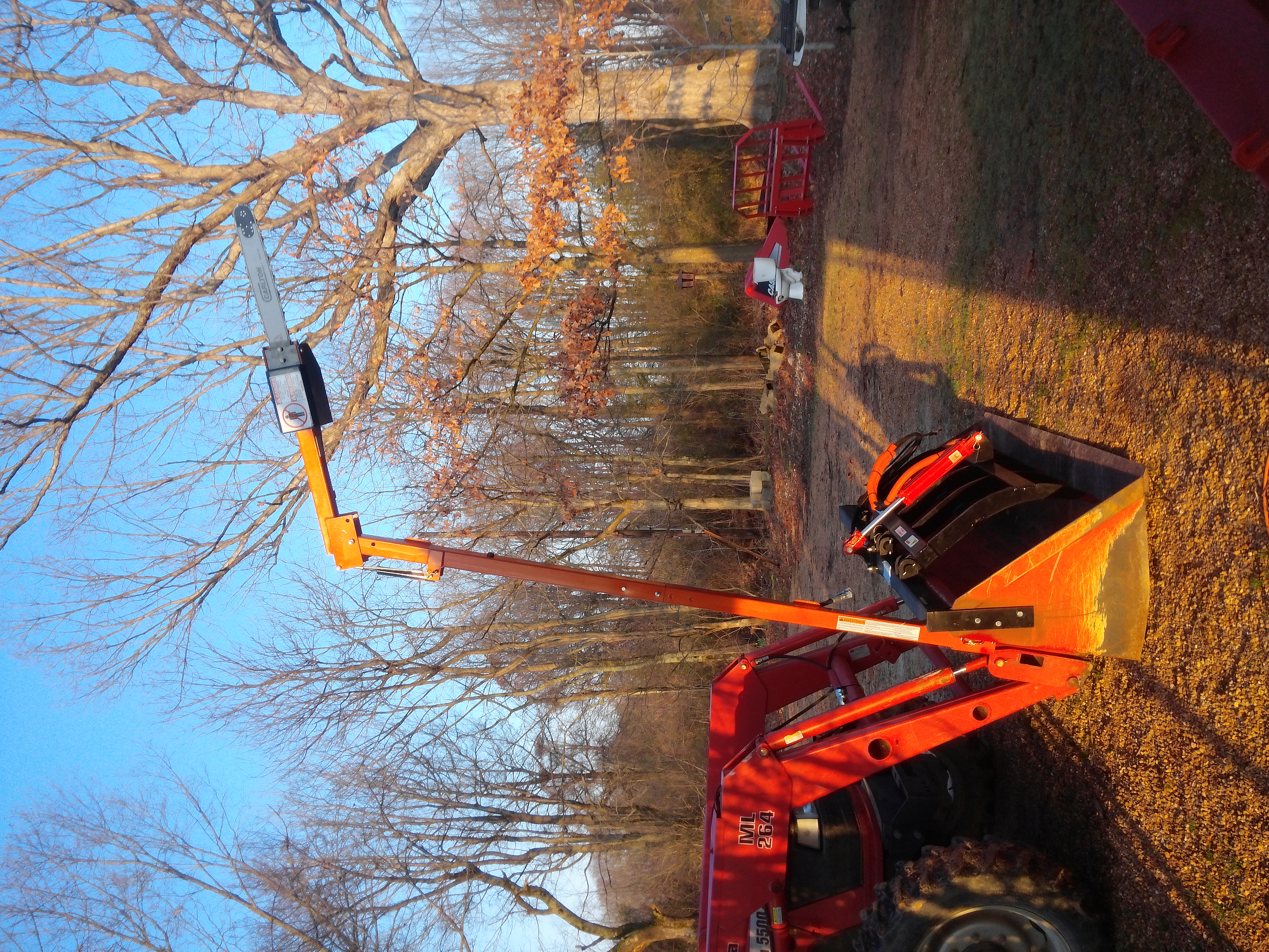

Most of the limb saws I investigated at one time seemed to require only about 6 GPM of flow rate to make them work. Well within the limits of my size of tractor.
/ my new "Limbhog" #43
Email sent to Mr. Capers
Mr. Capers provided a detailed reply, answers to oosik's and my questions:
4.5 gpm required for efficient motor operation
chain and bar made by Stihl
motor made by Parker
receiver dimensions are 6"H x 8"W
needs a "return" hydraulic connection, apparently the hose to the valve spool is OK

Thanks for the information. Not sure I have the hydraulics set up right. I have a front remote with a forward and reverse switch connected to the FEL control. Assume this would work. Anyone know?

In post #37 above, oosik proposed using the 3rd function buttons. Limbhog is less specific and just mentions auxiliary hydraulics. I don't see any reason why you could not use the buttons to intermittently power the chain when cutting and otherwise there is no flow to the saw. I think that the intermittent flow and low flow requirement let the return go back through the valve spool instead of having to return directly to the sump (like Lane Shark stongly suggests). Using the 3rd function buttons and returning through the valve allows you to easily operate the saw in forward or reverse to help "unstick" it.

One issue with using the remote hydraulics or a third function is the abrupt stop action of the flow,
many hydraulic motors need an open flow path between the ports to allow the motor to spin down slow from the built up inertia.

Good point Lou, I need to ask Limbhog about this issue. The Limbhog appears to have two hose connections and if you return one to the sump, then I guess you loose the reversing function.

As the owner of The LimbSaw Company, I can tell you that remote hydraulics or a third function abruptly stopping is not a problem, but actually a great safety mechanism. As soon as disengaging flow, the saw immediately stops, which is safe and designed this way.
