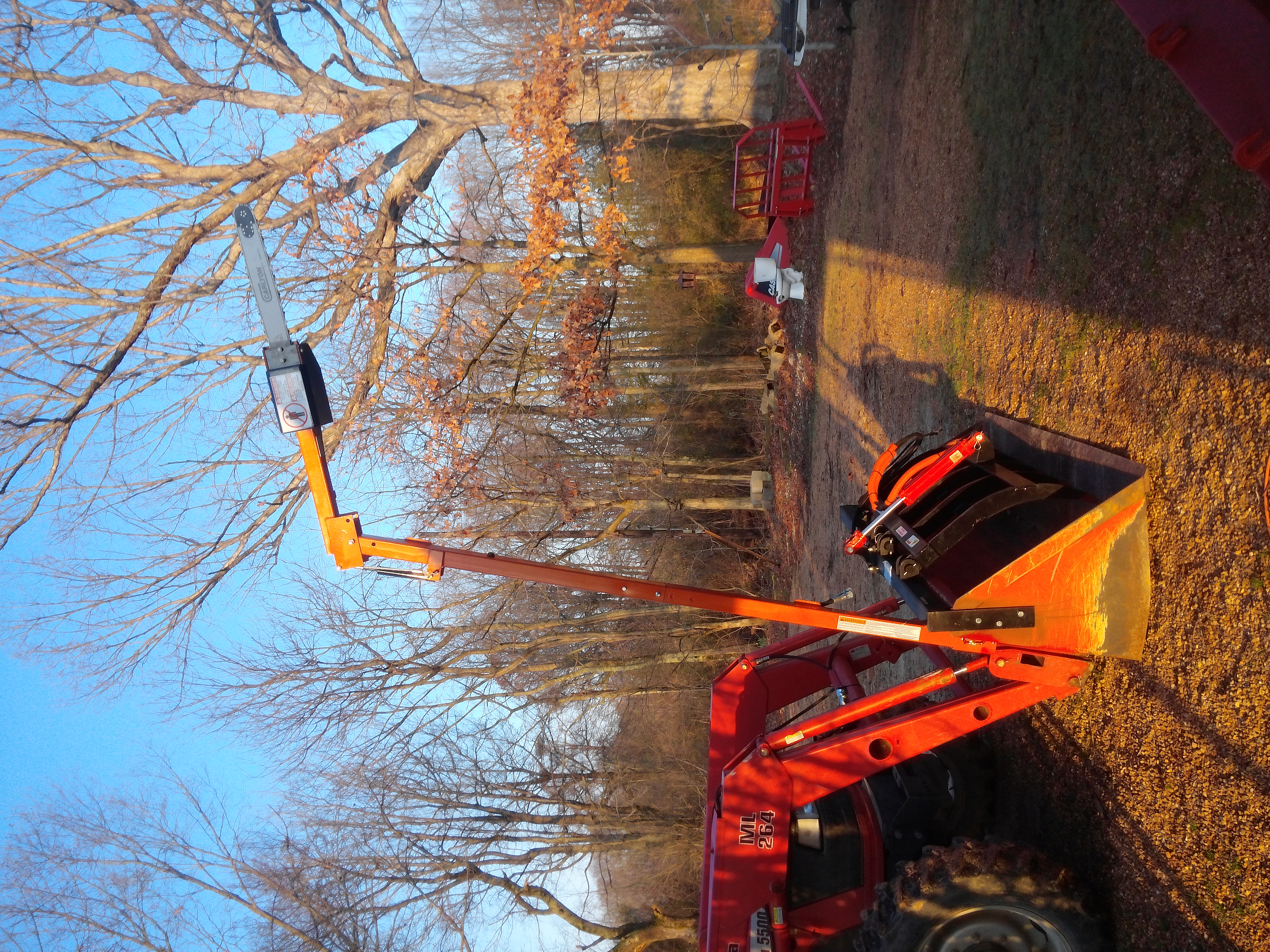

Nice looking tool, I would have it smashed off in like 10 minutes. If I didn't have it busted clean off in like 5 minutes chances are I would pinch the thing and flip my tractor over.
Can I buck firewood with it while I sit in the cab?
Just kidding but I would smash it off in no time, Fred

its tougher than you think with the heavy wall tubing.
i was backing up after a cut thinking i was clear and took out a very large limb with just the mast striking it

I have the Limbsaw, bought at the Farm & Gin Show last year in Memphis from the owner. My unit weighs 90# and works great. Priefert does the manufacturing and he sells them. Very useful tool that will keep woodlines and trails clear up where Chainsaws can't.

the limbhog receiver makes for a nifty spot for a hook when you're not using the tool.

My question is;what do you do if the blade binds in a limb?
To avoid ... Saw from the top not side - a foot or so from the tree ... then do same at tree.
3rd function valve allows you to reverse the chain and back you out
This doesnt help. The chain is not a screw. Neither is the bar.
/ my new "Limbhog" #31
That is how you get it out, have had to back mine out several times before I got the hang of it. It works if not abused. It is a LIMBsaw or LIMBinator or LIMBhog!

The only thing I don't like is that the saw head cant be rotated side to side, up to a 90 degree angle from the tractor seat. Tractors are not as nimble as skid-steers, I'd have to modify that, then copyright it re-brand it re-name it, and call it the Nimble Limble.

"Thanks for contacting us! The LIMBHOG IS $2,195.00 DELIVERED TO YOU?" I pay the shipping on this end. No tax. The unit comes fully assembled and ready to use. The receiver that attaches to your equipment is in the box as well as an extra cutting chain. It also comes with our 12 month unconditional warranty. You can attach the receiver directly to your Grapple bucket and hook the Grapple hoses up to the LIMBHOG. If I may be of more assistance, please call me at 8669546246. James Capers President
Soo... as I would guess. The open/close function of the WR Long third function would be forward/reverse power for the chainsaw.
I'm going to have to contact this guy for added questions.
- will the receiver attach to a standard grapple
- is the chainsaw unit made by Stihl

If you have not already contacted him and don't mind, can you ask the flow rate range, I didn't see that on his website. Also, shouldn't the return dump into the sump or is it intended to only run the motor intermittently?
