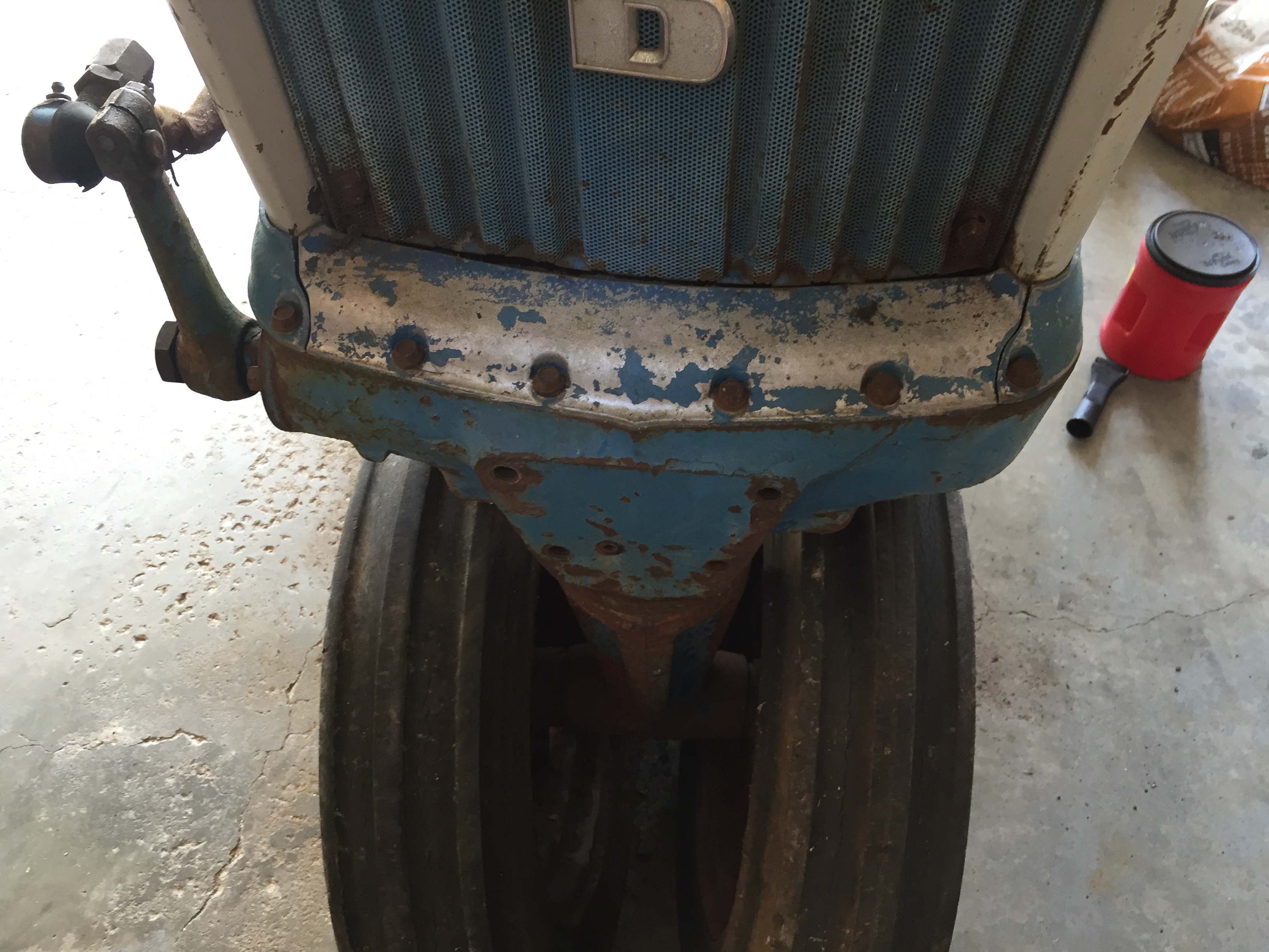

Here is a 1963 Ford 4000 S-o-S. My buddy and I are getting this from a co-worker of his in exchange for some labor around her place, and possibly a little cash. We were at $650 for the tractor, brush hog, and blade. Then she started listing stuff she would like us to do in exchange, so the out of pocket expense keeps going down, which is good.
Here is what we know.
Hasn't run in several years
Has a 6V generator, but a 12V ignition coil, and 12 v battery from walmart
Oil was full, dirty, but no sign of water
Radiator has clear, green coolant.
Was gas in tank, needs to be removed and cleaned
Got sediment bowl off and cleaned. Screen, gaskets on the way
Rebuild kit for carb on the way.
Going to need an air cleaner
Serial Number is 23450
Model 41105
Tires are pretty rough, but hold air
Sheet metal has a lot of rust, gonna be a bear to get off to remove tank.
I have an external gas tank that I threw together to test with to get it running.
Look forward to getting in back in action and working. I have a small place, 20 acres, that I hunt on, and the tractor will be use mainly for brush hogging, discing, and general tasks around the place.
Thanks in advance for any help.

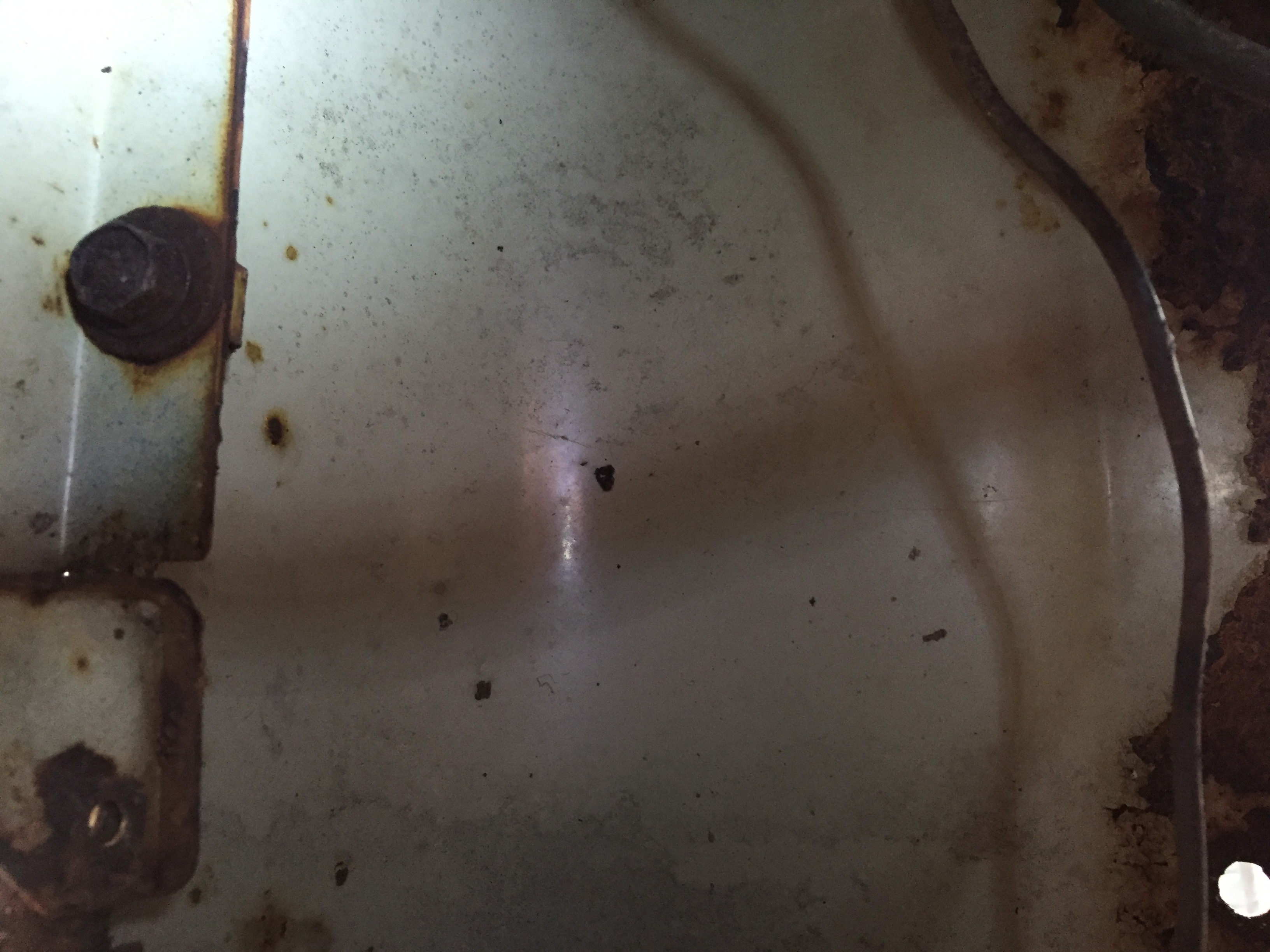

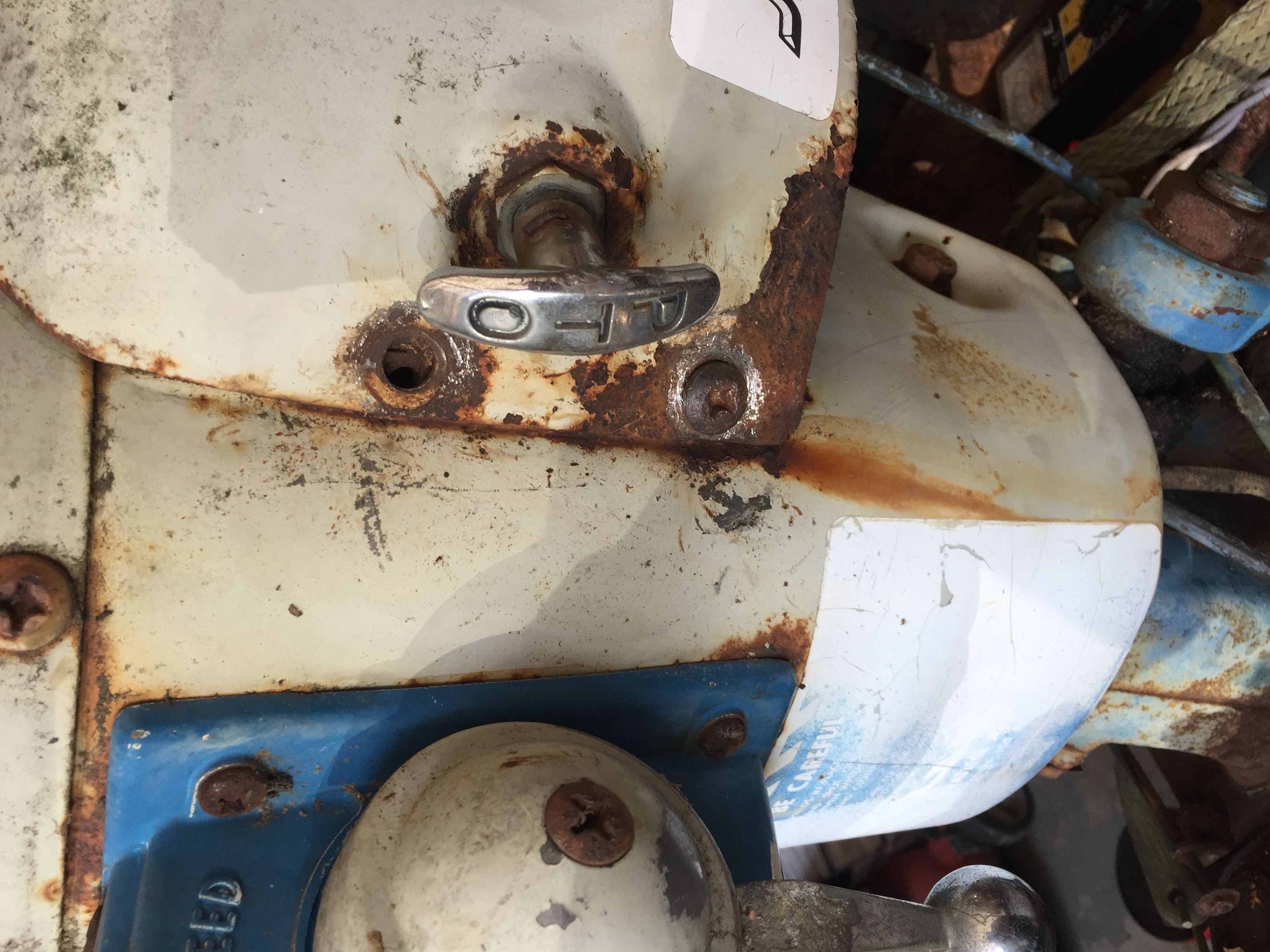

OK, after some reading I think I got the sheet metal removing figured out. We need to take the two large phillips head bolts out where the side panels attach the the dash cowling. See Pic
Then the two bolts inside that are basically behind the air cleaner, these also attach the the top hood panels to the center console/dash/cowling thingy.
Then the 8 bolts that run around the bottom of the dog legs, and in front of the grill? Also being away of anything attached to the hood assembling before lifting it off so as to not screw more stuff up?

You don't have to take the 4 bolts off in the front under the grill to get the sheet metal off only the 2 bolts each side at the bottom of the doglegs.
Kirk

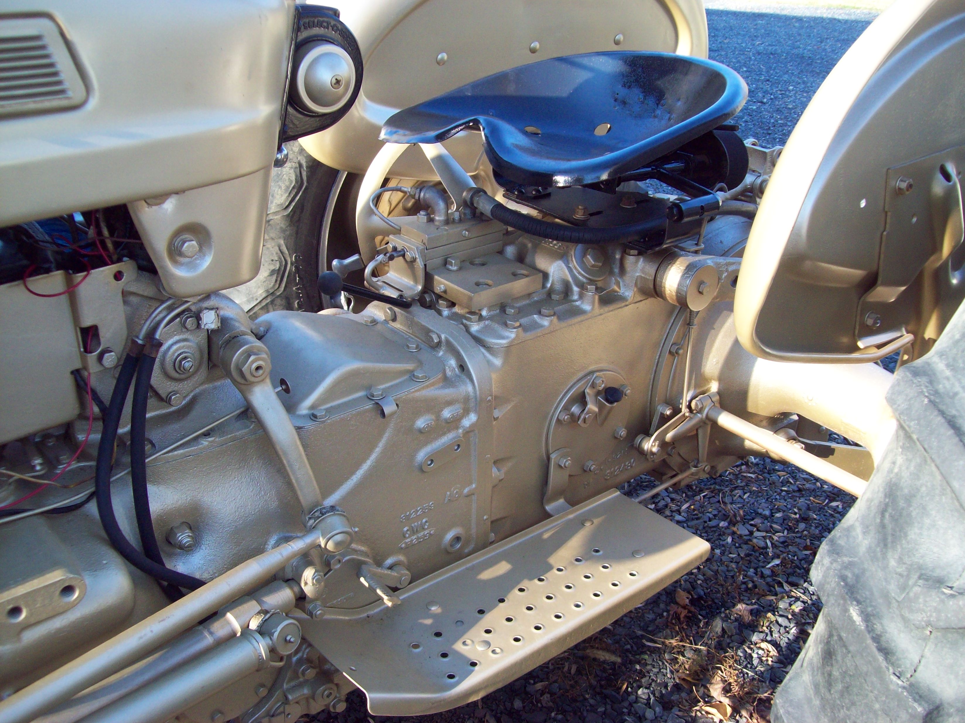

Here is a photo of my 871 inching pedal. Yours should be similar. Possibly someone replaced it with something else. Post a photo if you can.
Yes the PTO will spin when lever for driveline is disengaged. You are disengaging the trans to rear not the pto.
I never cared for ford's gas line routing through the manifold I run a steel line from the tank towards the front of the engine bend into come around over the alt/genny, sometimes will add rubber hose, and easy access shut off. If I remember correctly some of the earlier lines were 1/4 and some were 3/8 depending on the carb/manifold you have.

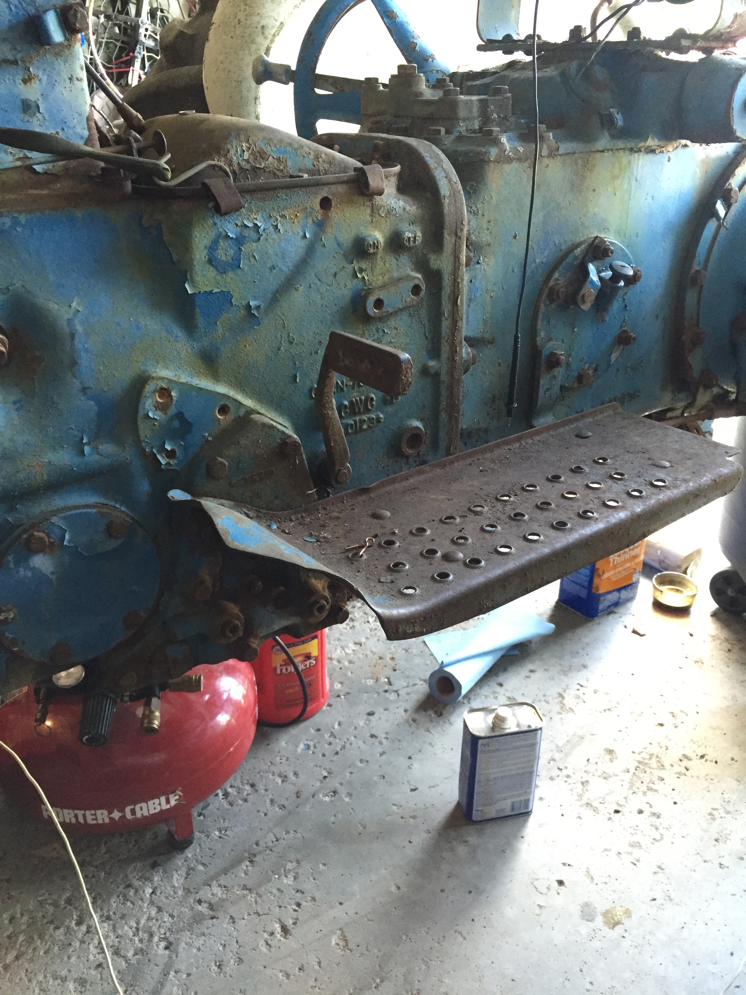

OK,
So you bend your own fuel lines? I can appreciate that, but that really isn't something I can pull off. I just need to determine the correct part # for my rig.

Any ideas on my clutch/inching pedal? Feel very little if any resistance when I press it down
/ My new Ford 4000 #20
For unknown reasons I'm guessing the inch pedal was replaced with a standard pedal. Maybe the inching pedal fell off?
