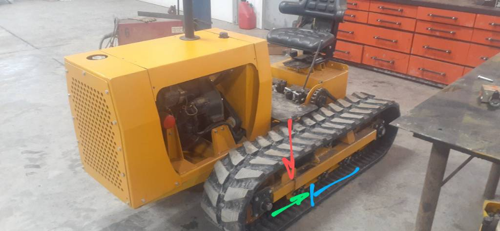

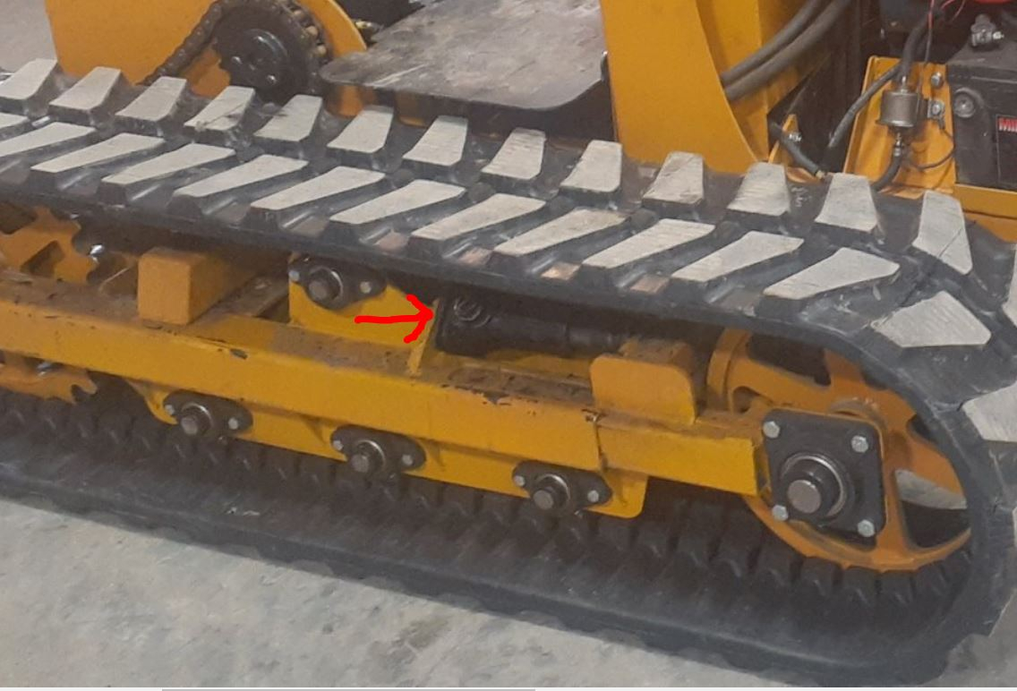

So far not noticeably light in the back. The fuel tank is under the seat and the back and sides of it are 1/4 inch plate also the hydraulic motors add some weight back there. Originally when I started I was planning a front end loader but needed to move dirt on a new place sooner so bought a 2520 JD with FEL so I'm planning a six way dozer now for the crawler. There is an auxiliary hyd.pump built into the hydostat.pump that I will use for the dozer. Right now it's just returning to tank. Don't have a lot of pictures of the build but will send some of various parts.
Grill and some track frame parts.
Fuel tank fan shroud hyd.tank and front grill mountEngine and belt tightened bolted into frameView attachment 692473

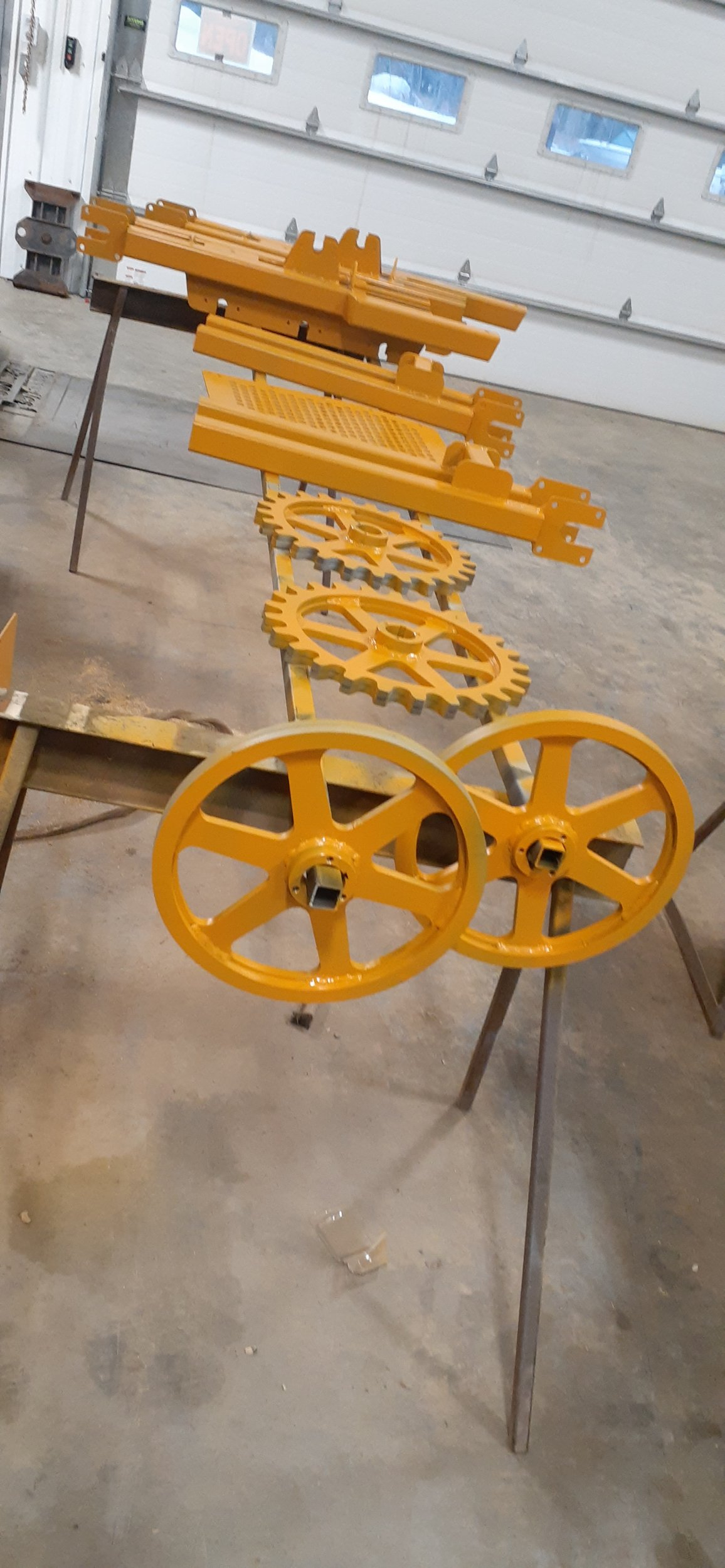

Front idlers and drive sprockets
Did you find drive sprockets or build them yourself?? Tracks are from a??
I looked for sprockets to buy but couldn't find big enough ones so I cut my own. My plasma won't cut 1 in material so I cut 1 main complete sprocket out of 1/2 in plate and another rim also out of the same. Welded them together to make 1 in.thick. Same with front idlers and all the rollers. Tracks are 300 mm width by 52.5mm pitch and 74 link if I remember right. They fit numerous machine 20210122_092234.jpg
Closer view of sprocket build. I used free software called sprocketeer. Very easy to design sprockets of any size or pitch. The trick I found out though is that a 52.5 mm track takes approx.a 50 mm sprocket because the thickness of the track doesn't allow the track to hinge on the center of a pin. I cut 3 or 4 trials out of 14 ga.before I got it right😀
