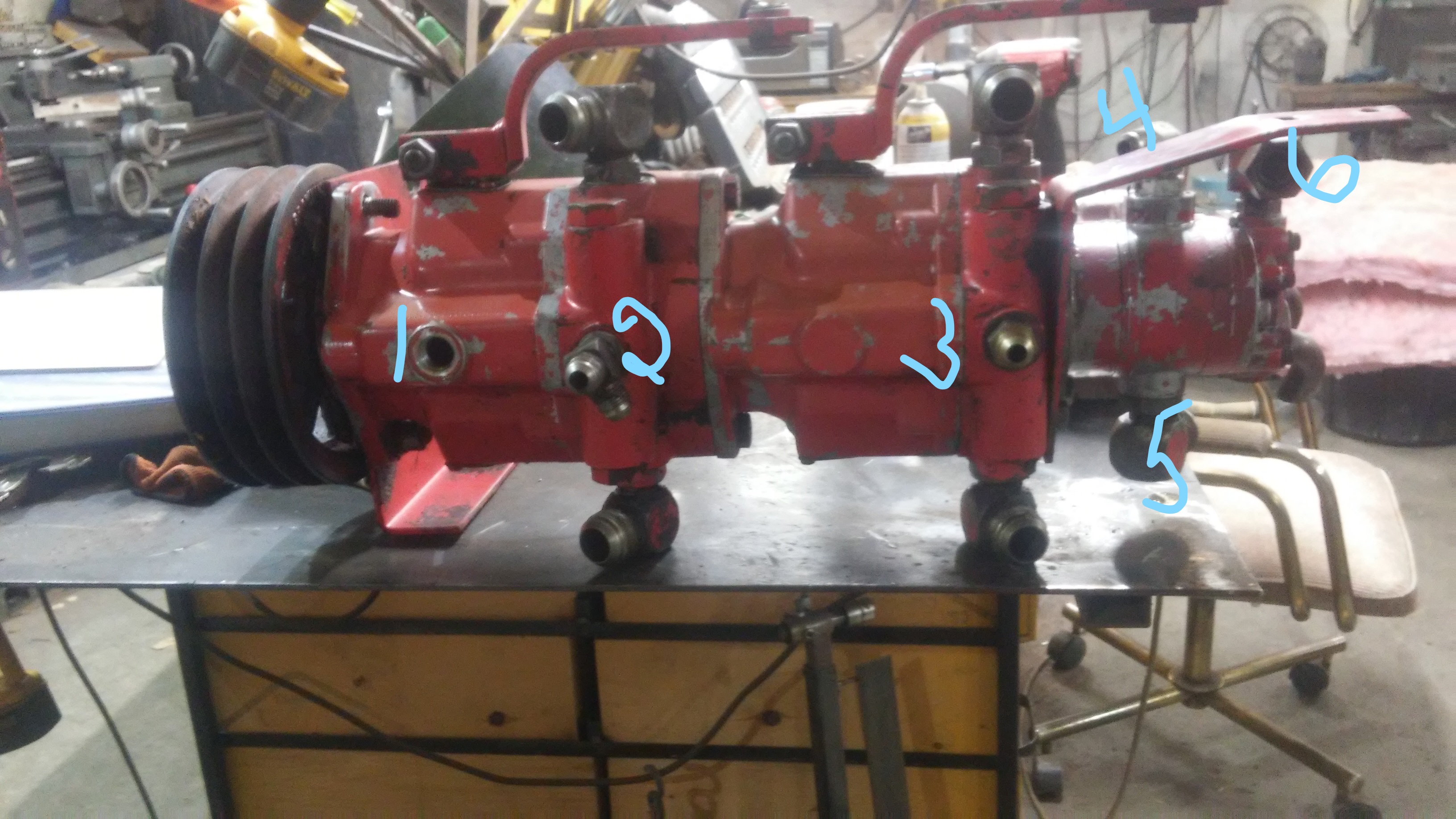

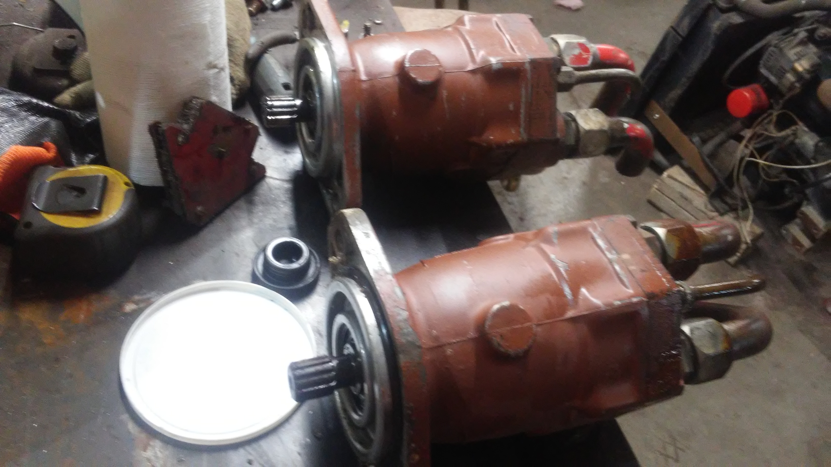

Hi! I have hydraulic components taken off an 855 MF swather. I want to build a mini dozer modeled somewhat after a D4 cat.Can someone help with specs please? Front pump is Cessna 70444LAB 2C47 GLF. the rear one is 70444LAG 2E46GLF. Motors are Cessna 74418DAV I can't find info anywhere. Seems Cessna was bought out by Eaton sometime ago. I need to know pump and motor cu.in. ratings to start with. The motors did drive through 26:1 planetarys which I have also but I think will be to big for my project. Price was right free for removing! I have a 3 cyl. 20 hp. Kubota engine I want to use. Total machine weight possibly 800 lb? I realize the hydraulics were driven by at least a 125 hp. engine in the swather but it also weighed 4 to 5000 lbs. I'm thinking of running the pump around 1000 RPM which is 1/2 engine speed. I know the 2 big ports on each pump went to a hydraulic wheel motor the other pump ports are case drains? The pump on the end is a charge pump? Just wondering what the working principle of this system is? Thanks in advance.

From memory I believe the pumps & motors are around 40 cc but not 100% positive.
Also Don稚 remember exactly but believe rated for around 3,000 PSI

The two front piston pumps are 1.24 in per rev. Built in geroler section for charge.
The rear pump is a standard gear pump config with a built in priority valve flow control. Not used for drive but for aux hydraulics.

So it looks like I was wrong about a built-in geroler, that model has no geroler and uses charge pressure from an outside source (likely from port#6) and plumbed in to #2 and #3. #1 is definitely case drain, #5 is suction from reservoir, #6 priority flow to charge ports. #4 to aux circuits (lift cyls, tool circuits?)

The pumps listed are 70444 while the parts breakdown posted by wdchd shows 70144. Which number is correct?
Messisks has a parts breakdown of 70444-RAU which shows it being 40.64 cc.
I cannot find any other document showing model code breakdown for the 70444 series

The 70444 is right so it looks like pump disp. is 40.64. Now for motor disp. I have looked all over and found lots of used ones available but no specs anywhere. Motor #744418 Cessna or Case D74973 interchanges with Cessna. Thanks for the help so far.

Nice, I've been looking for one of those motors for months now. They cross to a new Eaton 74318DAP 40.6 cc motor I believe and you would want to sit down when you get the price at a dealer.
