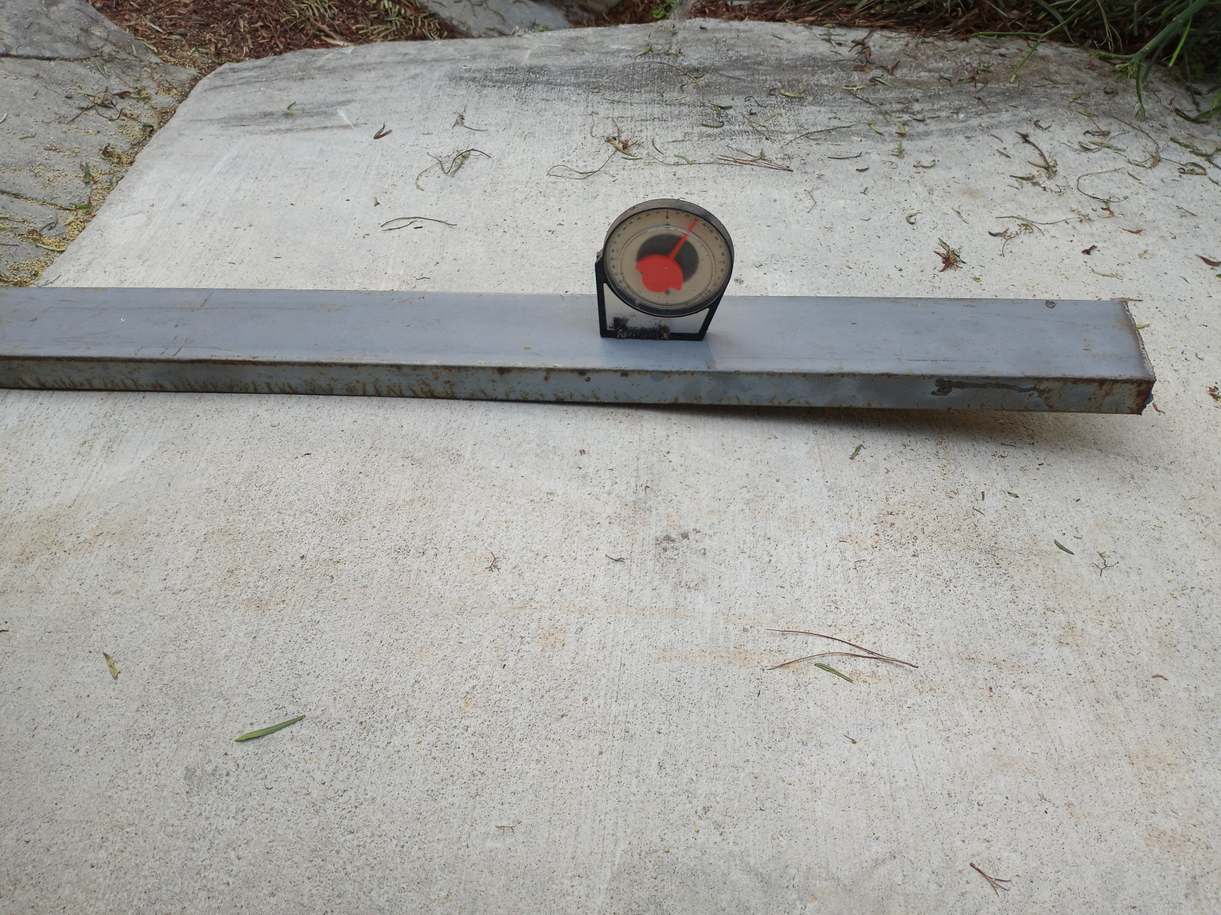

ok just curious but
My issue now is I cannot crawl up a steep 50 degree incline as I am with my other silver machine. The system pressure will not rise
are we really talking degrees here
like should I be merely really impressed by your skills or should I change religions and worship your skills?

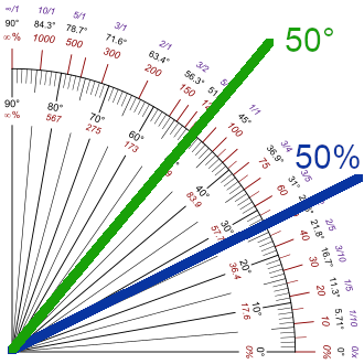

   / My Homemade Skid Steer Machines #15

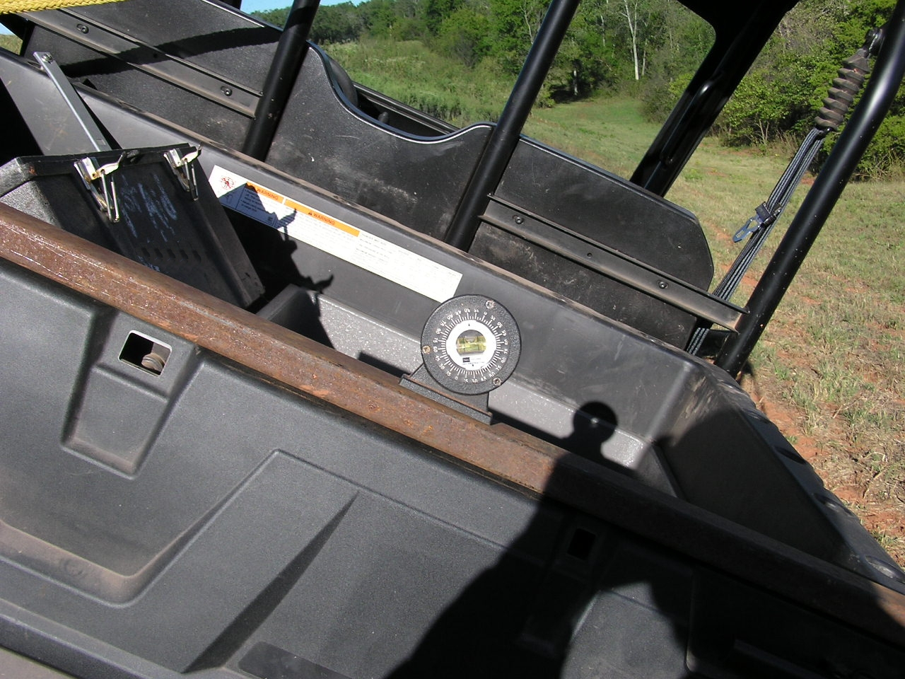

I'm sure it's useful to somebody but i wish the percent system for slope didn't exist. 😂
Yep, I can directly measure degrees on a slope:

Wow I was waaay off on my degrees, more like 30. I'm adding another oil tank after noticing foamyness. Will keep ya'll posted, thanks for all the input

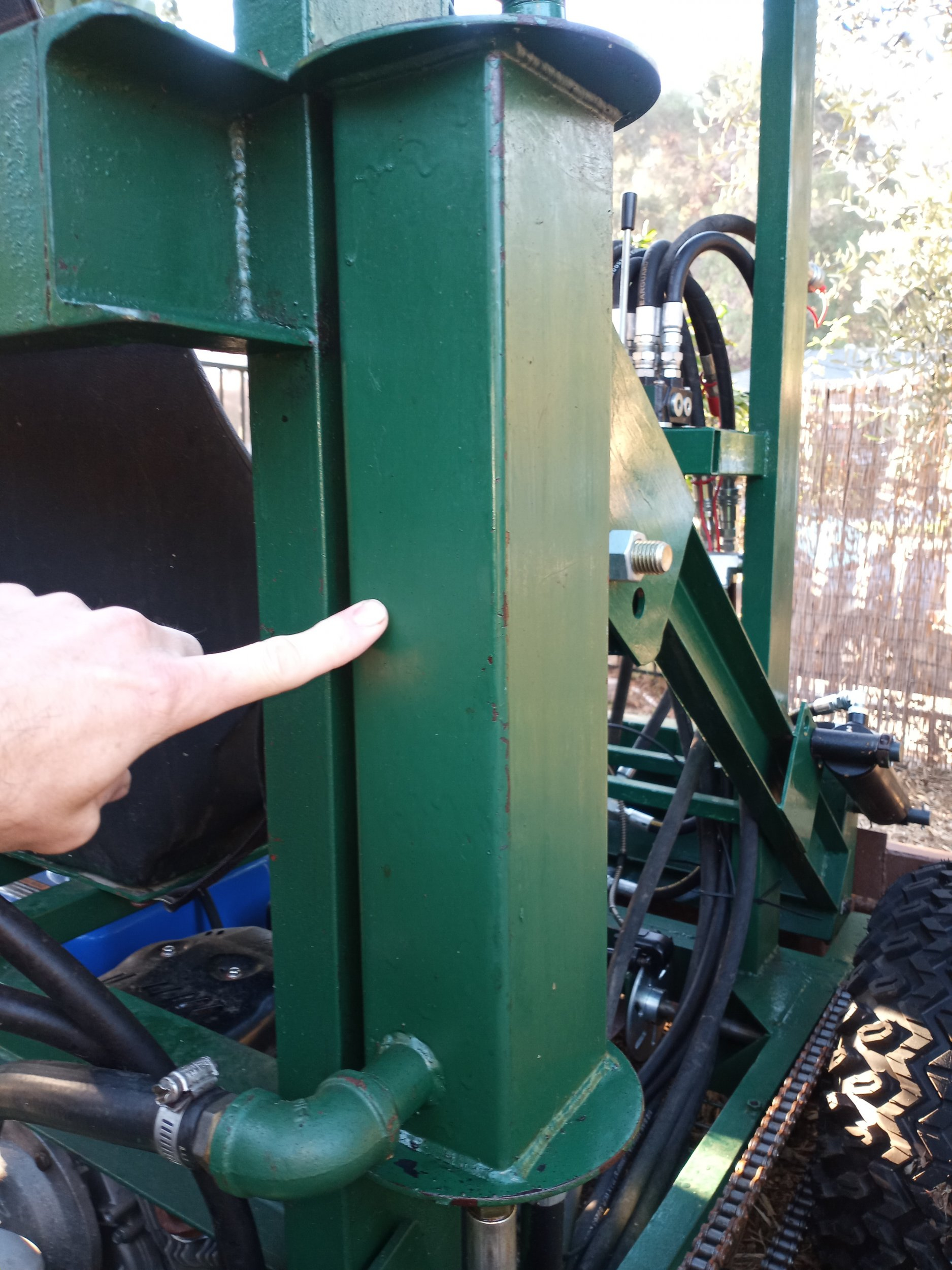

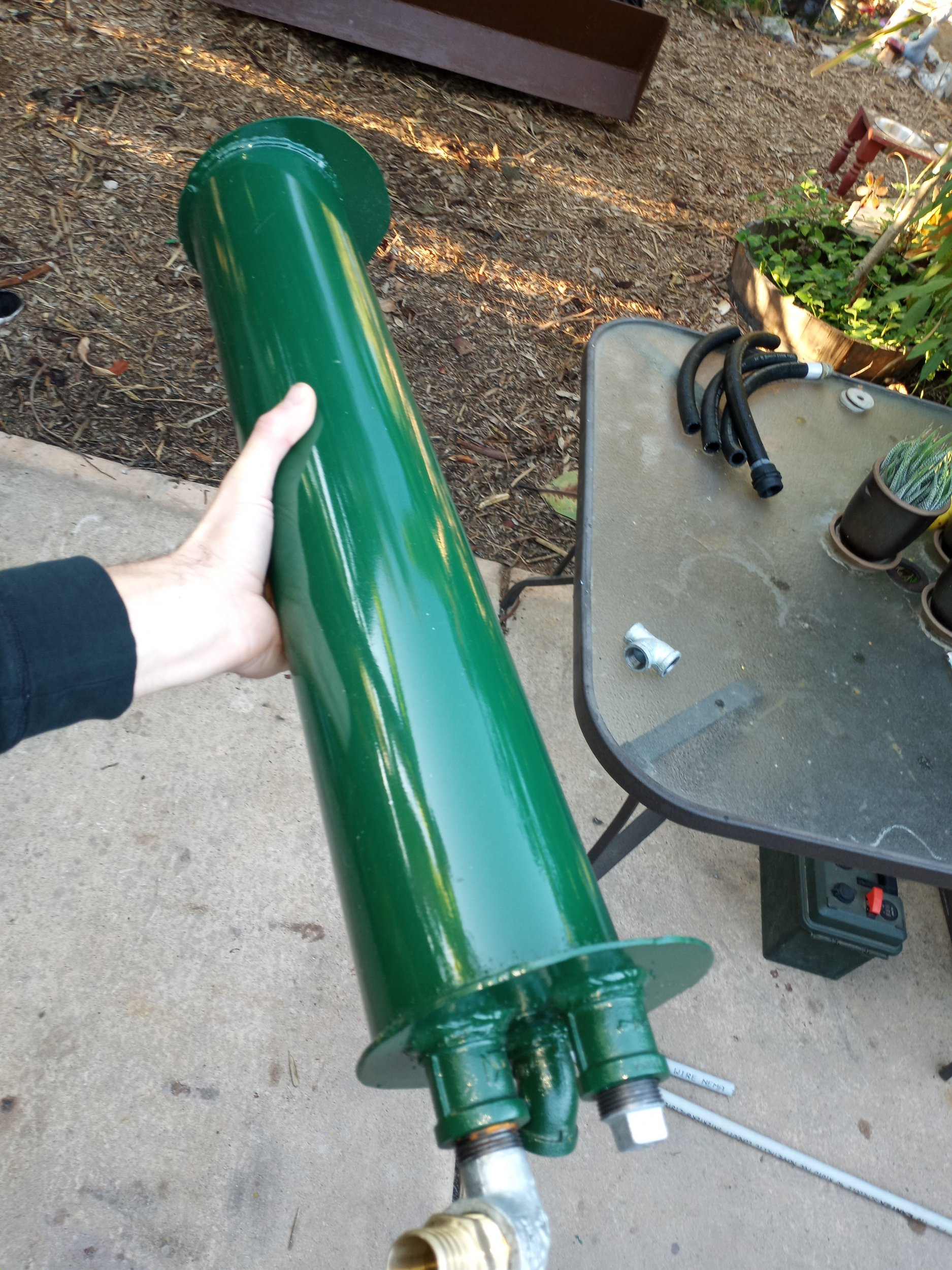

The tank is quite small, maybe 3 gal, see attached photo. I used all 1/2" lines, and way oversized cylinders for the loads required so I feel like overall capacity is decent if you take all that volume into account? The return is on bottom and the suction is about 2" up from that. With cylinders fully extended the fluid level was very low, i think it was simply sucking in a little air when trying to crawl up hill. The Temps are fine and I have always just used trans fluid. I just welded up this extra tank which I will add to the rig. I will tee from both tanks for pump inlet/ returns and have some kind of balance line. Stay tuned, thank you

Anything that you can do to keep air out of the suction line will greatly extend the lifetime of your system. If you can, try to have at least five or six inches of coverage on your outlet.
As a rough temperature check, after you run your machine for awhile, can you put your hand on the tank and keep it there?
