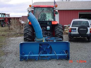

I thought I'd take a couple of pictures for all to see. The Lucknow looks kind of small compared to the 5030. The car is the size comparison. It's a bull in a china shop. /forums/images/graemlins/grin.gif
My 1085 Massey is in the background.

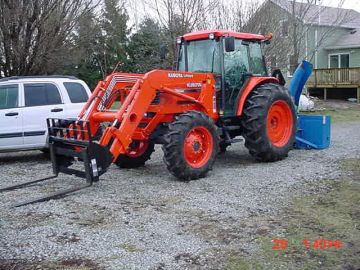

Here is the side view....note the mud on the tires, this tractor gets used just like all of mine and it's MUDDY here.

Daryl, now THAT is a proper tractor! I love what 50 HP can do, so I can only imagine how nice it it to have 90 HP when you need it. You could drag my tractor around with that thing and not even know it was there! Very impressive.
I saw an M9000 in person when I went up to New Hampshire to check out a grapple for my chipper. I visited these two guys who did light land clearing using a pretty big JD skidsteer with a Dynax shear on it, and a big Bandit chipper that they fed with a Farmi 3861 grapple mounted on a Unimog. They had an Implemax grapple on the back of their 9000, and there's a picture of one of them on that tractor in one of the "Americans on Kubota" catalogs. I'll scan it and post in when I get back to my shop.
They told me that price, quality and the locking front differential were the things that sold them on orange vs. green. (I think the intercooler helped too.) How did Richard (one of the land clearers) put it? .... something like, "I never thought I'd be sitting on anything orange, except maybe to mow my lawn". How wrong we can be. /forums/images/graemlins/smile.gif
Enjoy that beast - I just wish I could hear that turbo sing!
Take care, John

I'll still have a raffle for the payment book if it's okay with everyone. After I took the pictures, I gave it a bath.
One drawback to the M9 and the same thing on the 5030 and Kubota fixed that problem on the new M's is the front light placement. They are too low and the FEL gets in the way at night. I think I am going to mount another set up top so I have 4 facing forward plus the two on the grill and 2 more in the back.
The exhaust system is stainless. I was going to put a straight pipe on it but I can't bear the fact of destroying the underhood muffler. Turbo's sound sweet with a straight pipe, in chrome of course. /forums/images/graemlins/grin.gif
The loader is awsome. I picked up my neighbors Chevy one ton and lifted it off a rock his kid had high centered it on. Just slid the forks under the front and told him to sit tight. Never even felt light in the back though I did have the FWA engaged.
I'm getting used to the size of it. The only time I really notice the size is when I park next to a car and look way down.
No getting this tractor in the shop or garage...too high.
