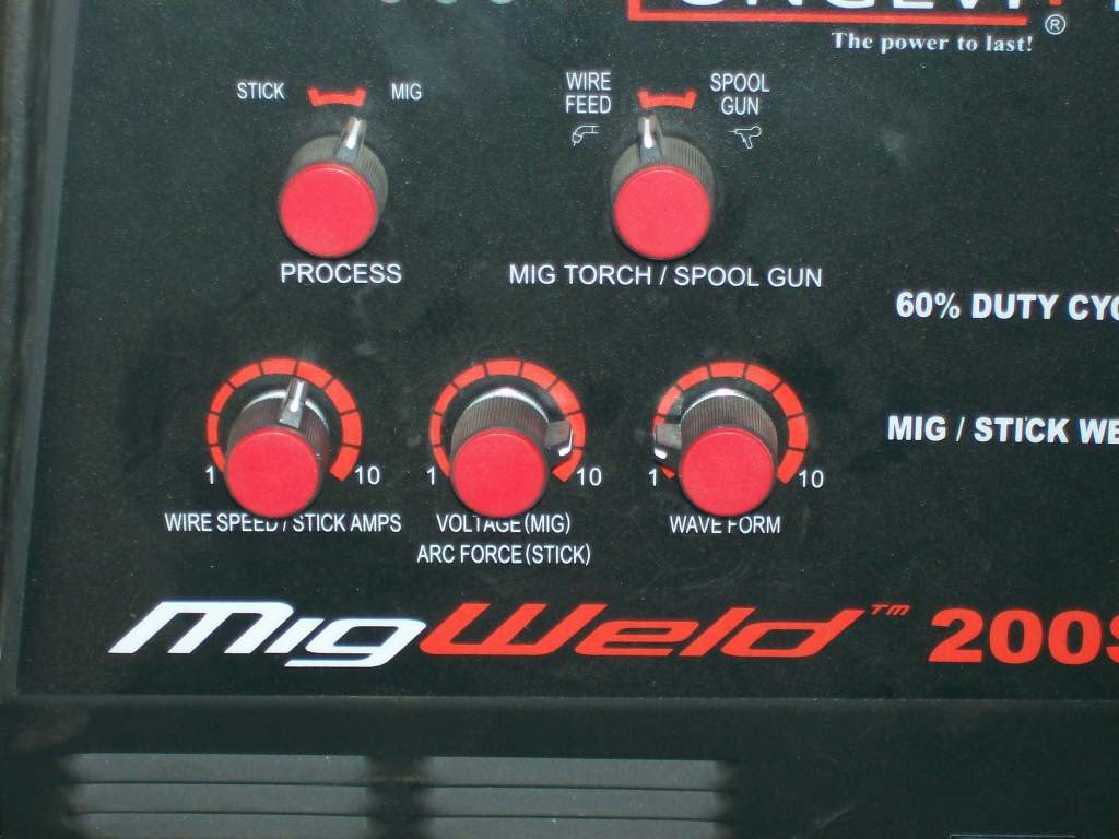

Front panel

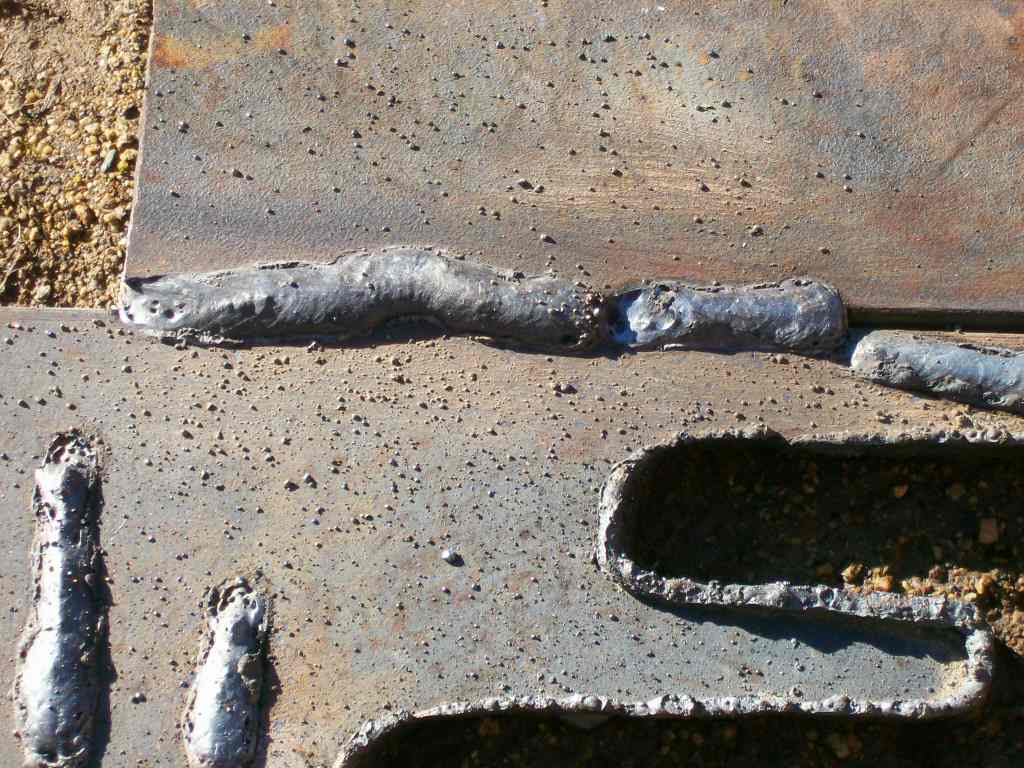

Short bead on right was first , then moved left with each bead , was welding away from me , " Push "???

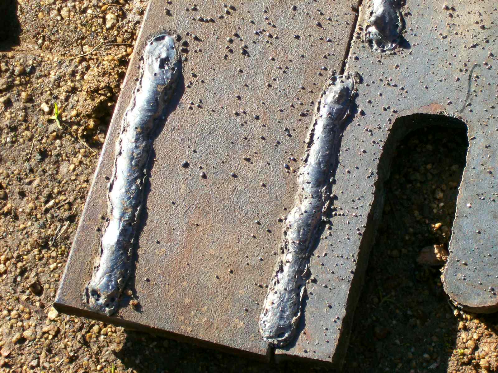

Bead on left was first of these 2 , had both wire speed and voltage turned up to were voltage is in picture above . Small weld on right was with wire speed set were it is now ??

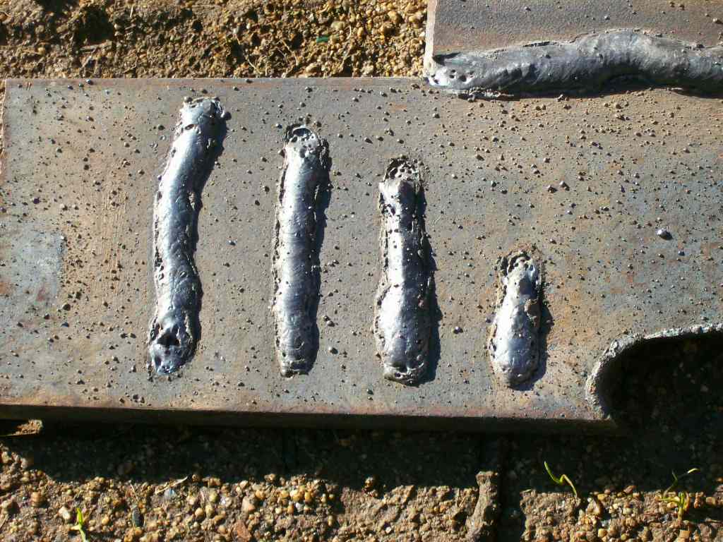

This 2 beads were last , I Think . 1 on right first , then 1 on left , with controls set were they are at in picture above .
I Think only 1 weld was made from side to side , most were push away from me due to time and not being able to set - up accordingly . Basically , Just plug it in and shot few beads , Which By the Way ,

Wave Form , Never Touched . Will have to check out the cd/dvd that was included and the video's on it . Tried before going and playing , But Grandson had other Ideas so only was able to read a little .

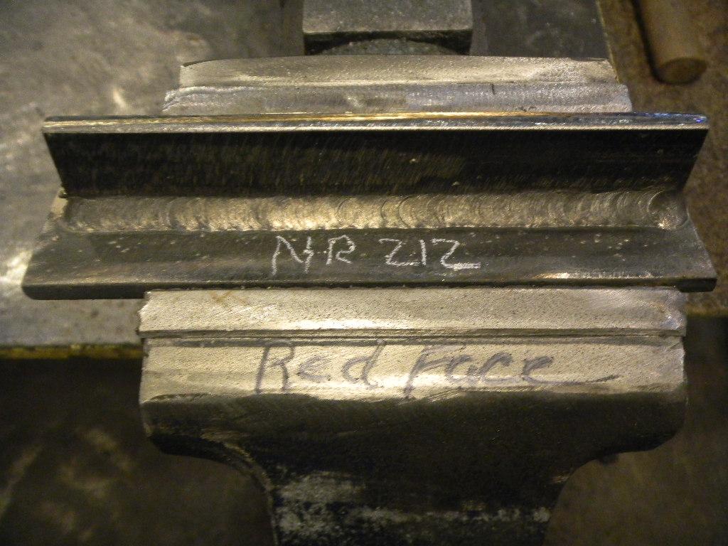

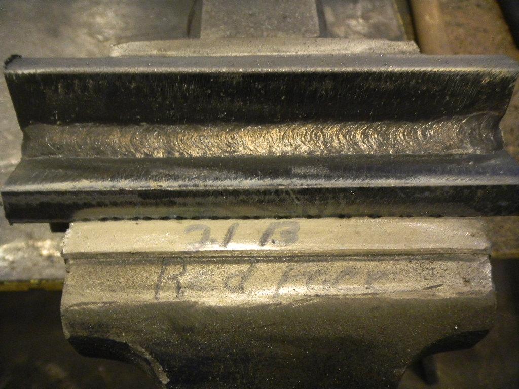

I wonder if the wave form is like an inductance control? If so, when welding flat I'd turn it down. This will give you a flowing / wetter puddle. For vertical up welding I'd turn it up, this will give you a dryer / stiffer puddle. Now I'm only guessing on what it is.
Looks like most of your welds you're running a little slow, or you could turn your voltage up some.
What brand of flux core are you running?
I like Lincoln's NR-212, and Hobart's Fabshield 21-B.

I was going to ask the same thing. Wave Form on DC?? Must be inductance. They should change that so they have common verbiage.

Think I was running slow 'cuz I could'nt see . :ashamed: I was amazed at how much garbage was built up . My wife was laughing at me , when I took a finger and swiped at the front and it left a clean streak down through it . Never even crossed my mind as I could see before striking a arc , ( Least I thought I could ?? ) .
Wire is some of a 8" roll I had of Harbor Freight E71T-GS that I had taken off my little Lincoln for some reason quite awhile back , Think it was because I did not like the way it ran on it .:confused3: In Looking at the way it ran here , Thinking it won't be ran on this welder either .:thumbdown:
Normally do run Lincoln wire , should of took the roll out of my lincoln and tried it instead . Have a new roll of lincoln .030 solid that I will load up then try with gas next weekend . See if I can do any better .

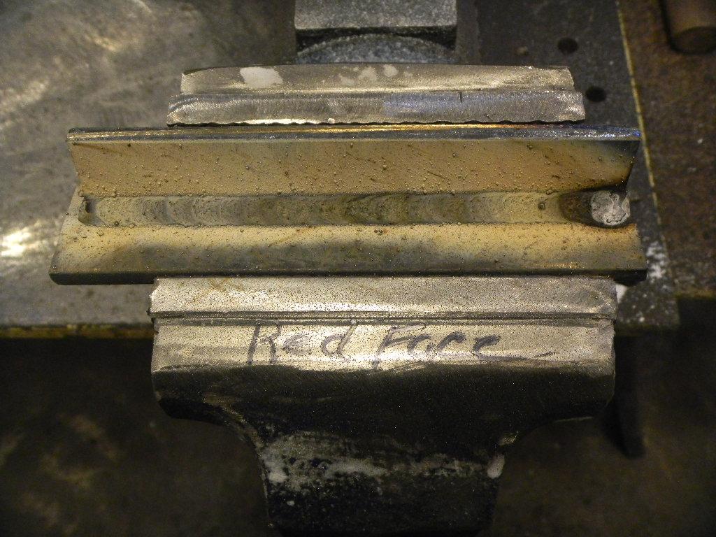

Just a suggestion for practicing your welding, it is hard for anybody to make welds look good on a flat plate. Maybe think about picking up some 1" x 1/4" flatbar cut it into 6" long pieces. Practice fillets, and lap joints. If you think about it, when building things how many times do you actually weld on a flat plate? Just butting two pieces of plate together is better practice than running beads on a flat plate.

Was Reading on the Everlast site in one of their manuals and You are spot on in your description of the Wave Form . Have a Bunch of 1.5" x 1.5" x 1/8" up to 1/4" angle in a pile out back , so Your Suggestion will be Used . In re-looking at those welds , I also know why I dumped that H.F. wire out of my lincoln some time back ! Although I use Flux core in my lincoln , I normally use lincoln wire and that H.F. spool seem to have at least twice the splatter beads every were .

If you didn't wire brush those welds off, that is a bad sign having the slag hit and miss like that. I've run 5/64-inch NR-211 at well over 400-amps, and that will happen! You want complete slag coverage over the weld like this.

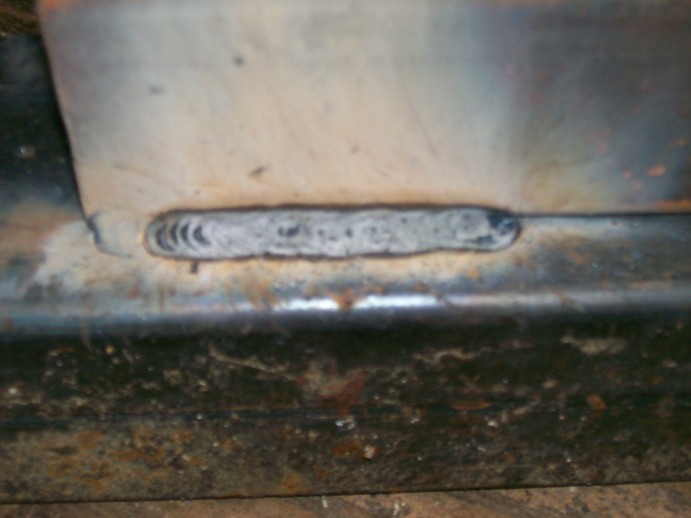

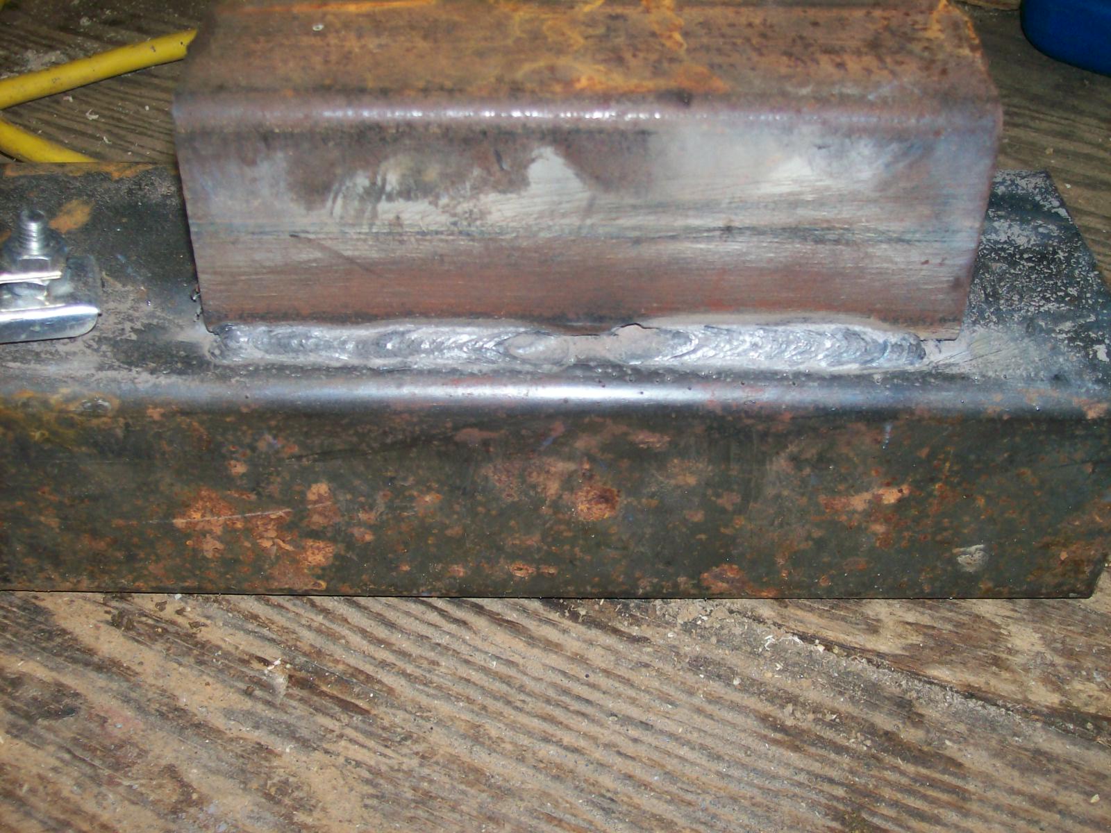

Got home this afternoon and ended up building a new computer for BOL , But While windows was loading went out and played with a couple of pieces of tubing out of the scrap pile .
Above is before cleaning slag
These 2 were first and had welder a little to hot / high , was burning through the tube :ashamed:
This was after cleaning slag and getting adjustments a little better .
Have to for sure retool my brain from welding with my 110/120 lincoln to this welder . :ashamed:
Hopefully get to town in morning , want to pick up some rod to see if I can rekindle any brain cells from my high school days on stick welding . That could be Really entertaining !!;)

My pictures Suck !! I can build computers from scratch , but trying to take a close-up without blurring , UGH !! :confused3:
If I take my time , set up every thing " Right " , ( Clean dust off glass of helmet also helps :ashamed: ) , I am still a hack , but am able to stick things together . Last weekends 5 minutes of play was the first welding done since last spring's Land Plane build , It comes around with time .

Well , Headed to town yesterday for some metal from my supplier . Couple of pieces of 1/4" plate and was also looking for some 1/4" square tube , maybe 2" x 2" but ended up getting a section of 2" x 5" or 2" x 6" , ( forget now ) what it was . Anyway , shot over to a welding supplier and picked up a 5# box of 6011 . Got home and ran 2 rods through the 200S . Welder works fine in arc mode , ( Meaning the MACHINE!! ) . Me on the other hand , ugh !:( . First mig welding requires 1 movement , Horizontal , But Stick / Arc requires 2 movements , Both Horizontal and Vertical , ( Feeding rod is the vertical movement ) . Sorry People , Way to much Strain on this Brain at this point in my life :confused2:. Did it years ago in high school but older now and Seriously Doubt Wiser , so I am reverting back to my favorite acronym ,
KISS , Keep it Simple Stupid . ( Stupid meaning me ):confused3: . 1 Movement easier than 2 , Likely Why I don't Chew Gum either . Never would be able to walk any were .:thumbsup:
Fred H.
P.S. Actually did better than I thought , never stuck the rod , Just Never burned more than 1" off the rod at a time either , So Shield Arc is right there also , " Moving to slow " .
