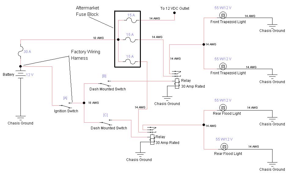

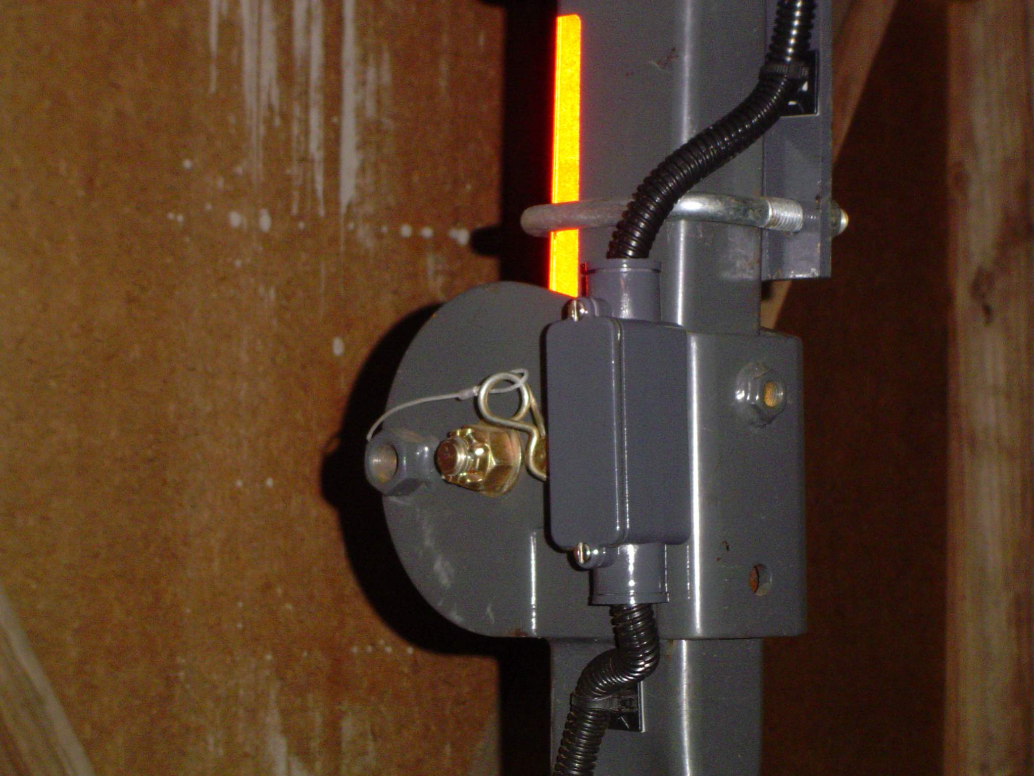

Update.... things have been quite hectic around here lately so not much time to work on the tractor, but here are a few pictures of the progress so far. First one is the SunGuard canopy and the front lights mounted (although not wired yet).
Used a piece of angle iron, mounted to the bolts for the canopy to mount the lights to.
No power yet, but the fuse block is in and wires routed to the rear of the tractor where they will be wired to a six plug connector and then onto the canopy.

ok that wiring job just looks way too neat and tidy
/ My Kubota lighting project #27
Very sanitary.......Good job.
