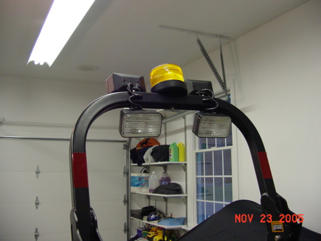

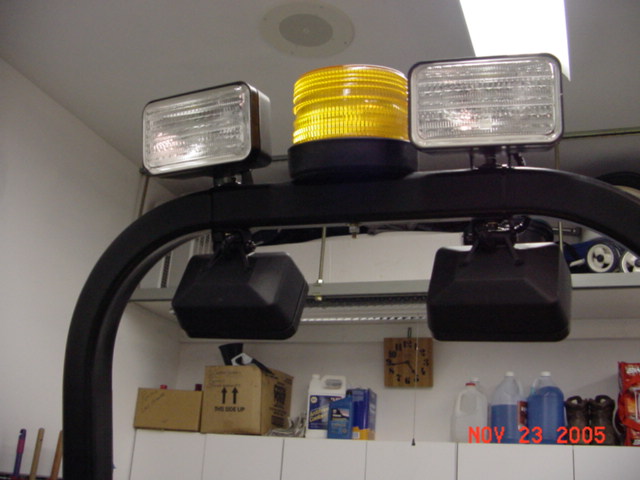

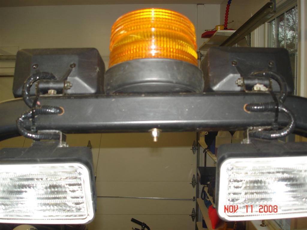

I thought I'd start a thread to document my lighting project on my Kubota L3400 and ask a few questions along the way. I'll post pictures as they come in as well.
The project it so mount 2 utility lights facing forward, two facing back, a single strobe beacon and possibly one work light facing either side of the tractor. There will be 5 switches to run all of the lights, one for the back lights, one for the forward, one for the strobe and one each for the two side facing lights. I have a canopy to arrive in a few days to which the lights & switches will be mounted.

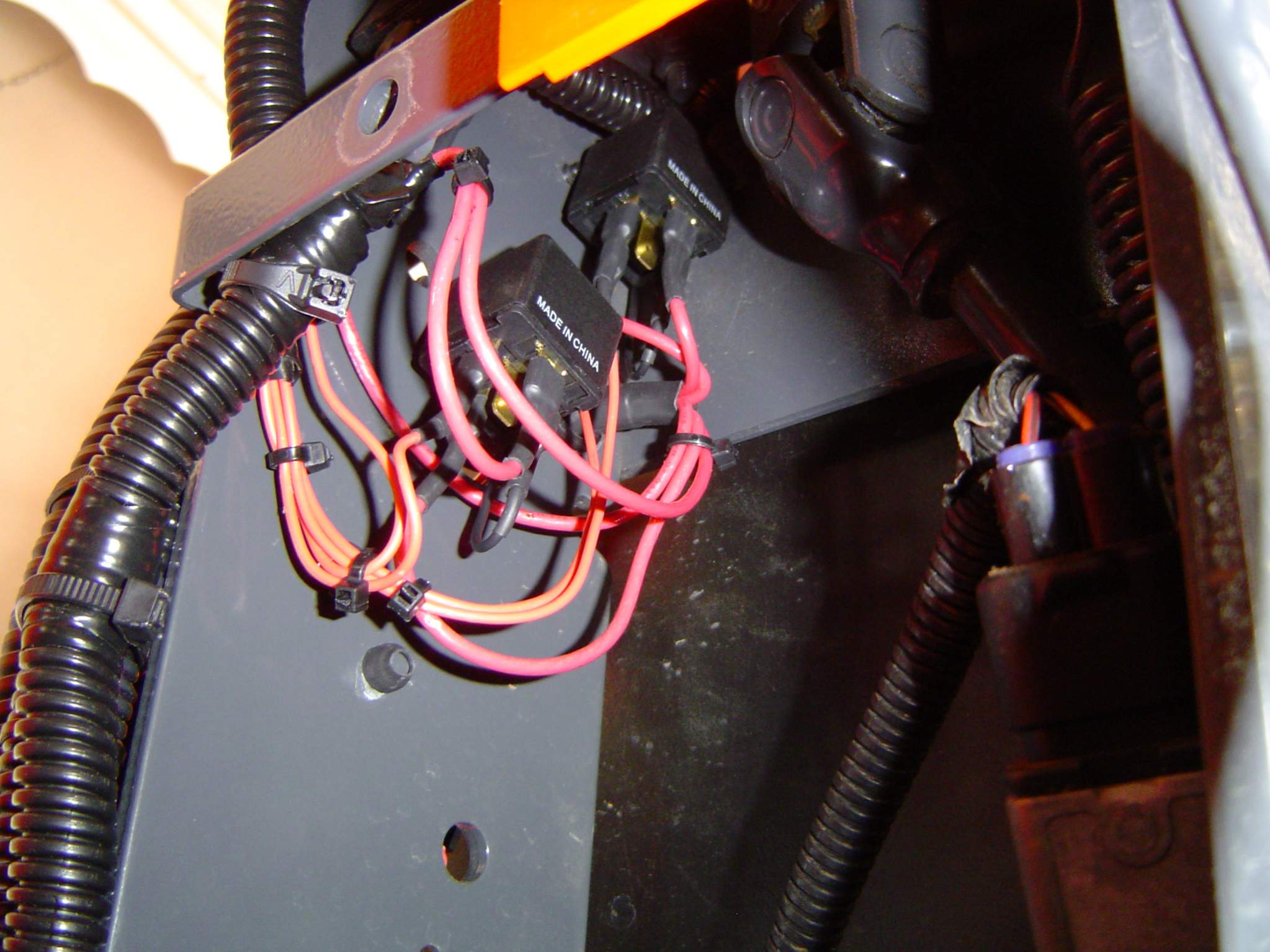

So lets start off with the questions. First, I will need to use and mount 5 relays to run all of the lights. Where do I put them??? For those of you who have the L3400 Kubota, you know there isn't a whole lot of room under the hood. I am thinking my best bet may be to mount them to a piece of flat metal and then mount that right next to the battery? Seem like a good idea.

I did my setup (except for the side lights) with one 30 amp relay. A good quality switch will easily handle two 55w worklights.
The relay is connected to the battery and only active when the key is on, so I basically created a new 30a circuit.

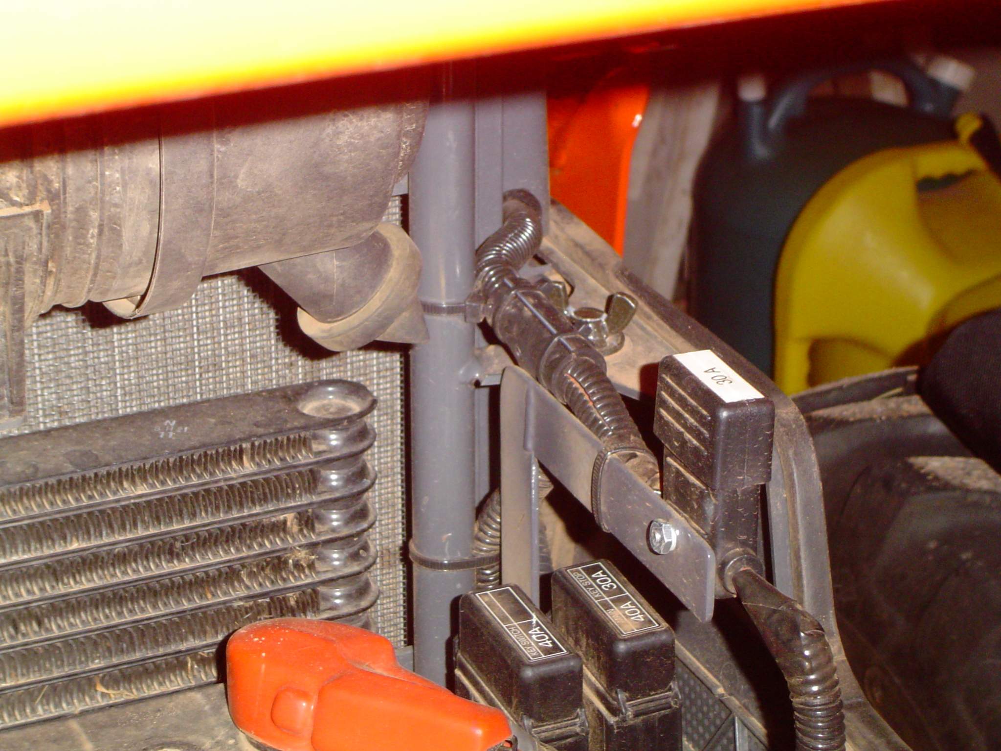

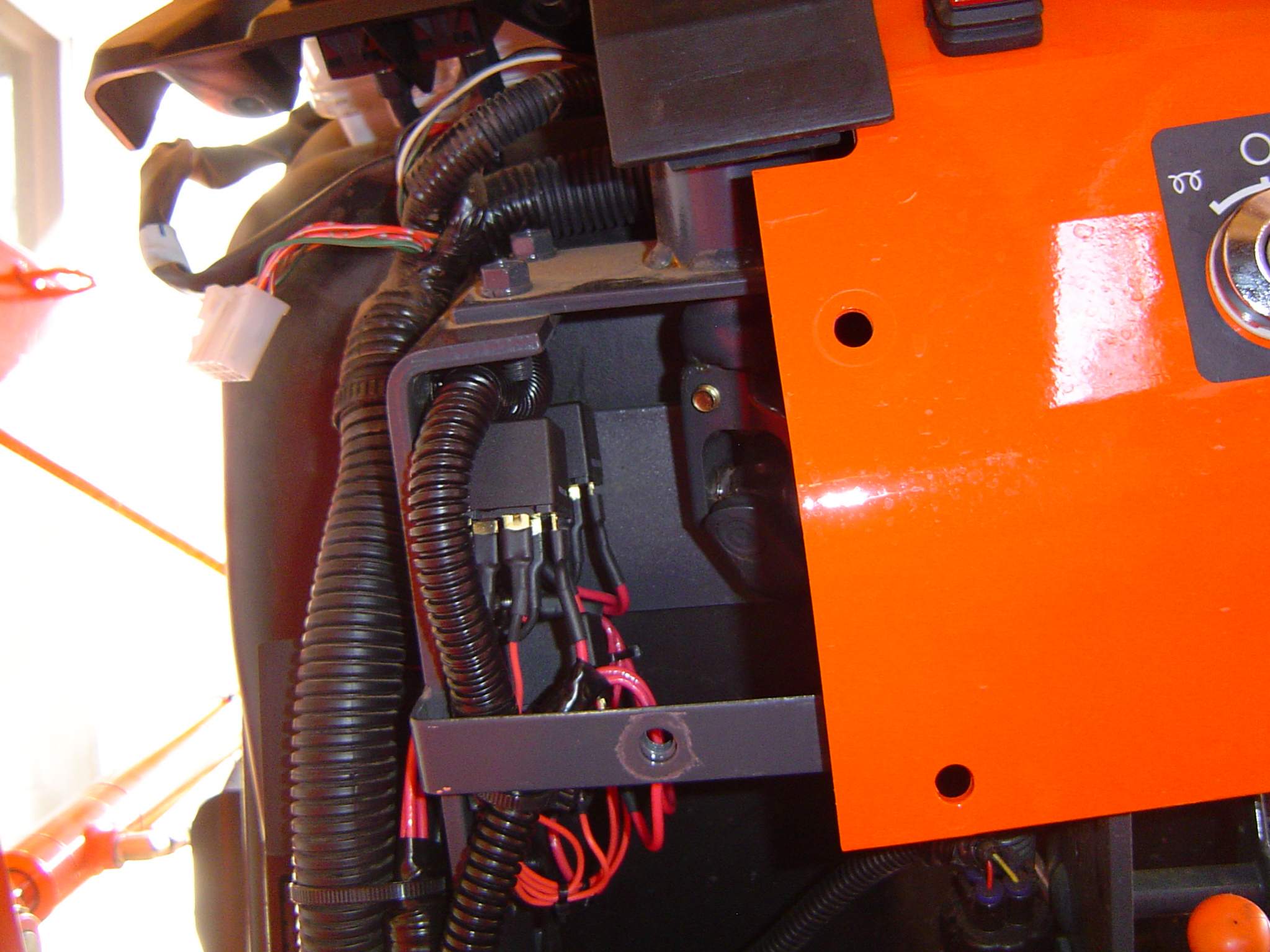

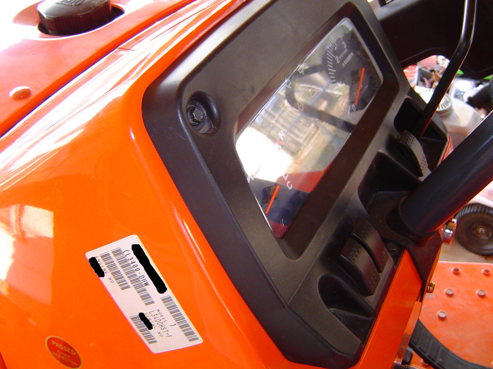

Here is where I mounted my relays, switches, and inline fuses.
I have three relays mounted under instrument panel. Five would probably fit. Switches are marine grade.

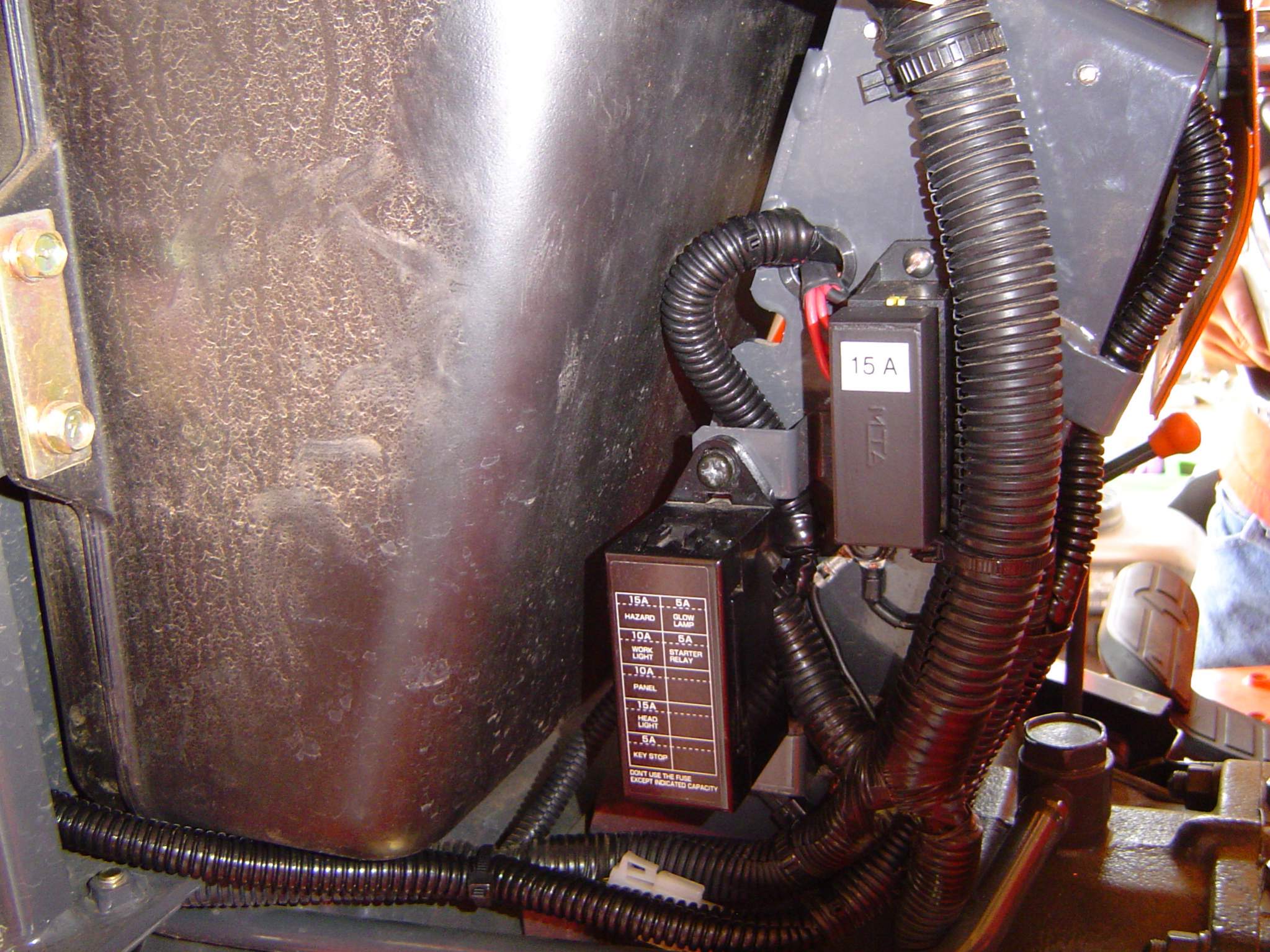

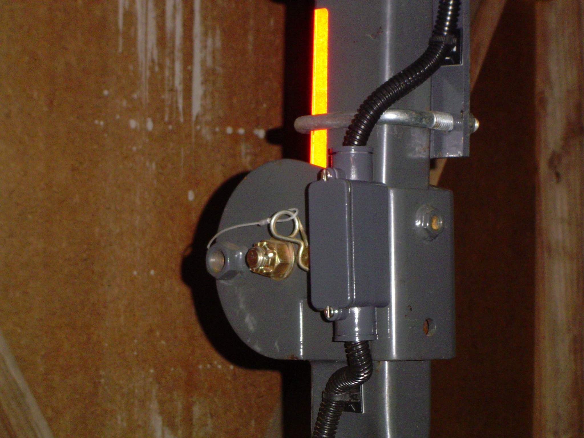

Ok, so here is what I'm thinking as far as wiring all the lights. Let me know what you think. I will mount a 6 circuit fuse block somewhere near the factory block. It will have a 10ga wire feeding it and then 14ga wire from the circuits to a "trailer connector" just below the fold in the ROPS (this is so I can remove the canopy & lights if need be). Wires then go to a switch box mounted to the canopy and directly to one 16amp switch per circuit. This setup would not use any relays for the individual circuit.
I would like to put in a relay that is tied into the ignition somewhere so all of the lights turn off when the tractor turns off. This would need to be prior to the fuse block and thus would be on the 10ga wire. How big of a relay would this need to be?

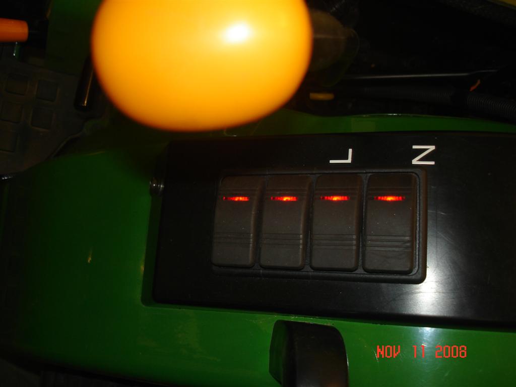

Emmy71, I recognize those switches. They mount extremely nicely and easily in perfectly rectangular holes. How did you cut your dash? Xacto knife? They're also amazingly cheap for the quality of the switch. Non-waterproof Grote toggle switches cost more than those do (at least where I've looked). Where did you source yours? How much, if you don't mind me asking...
