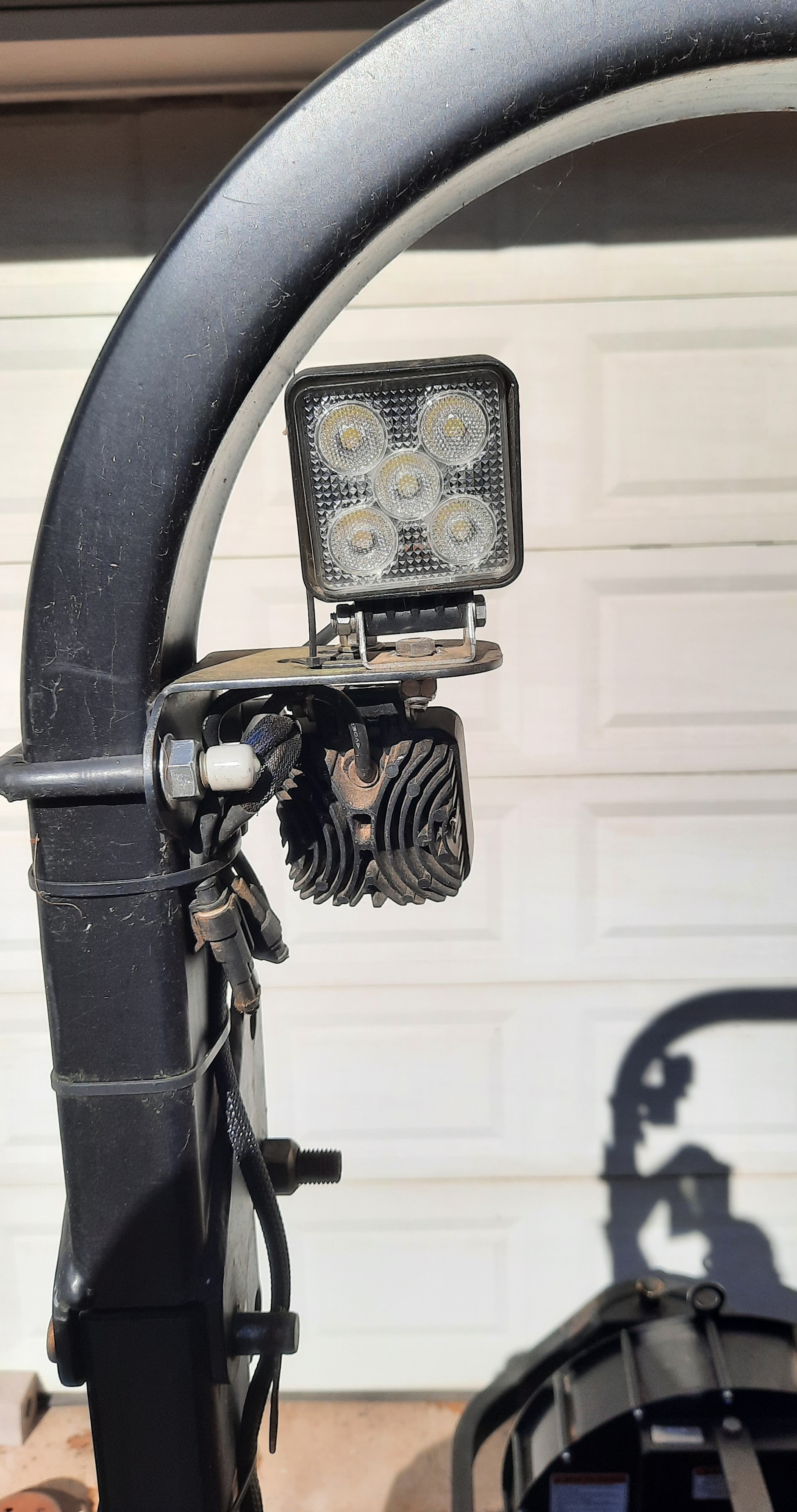

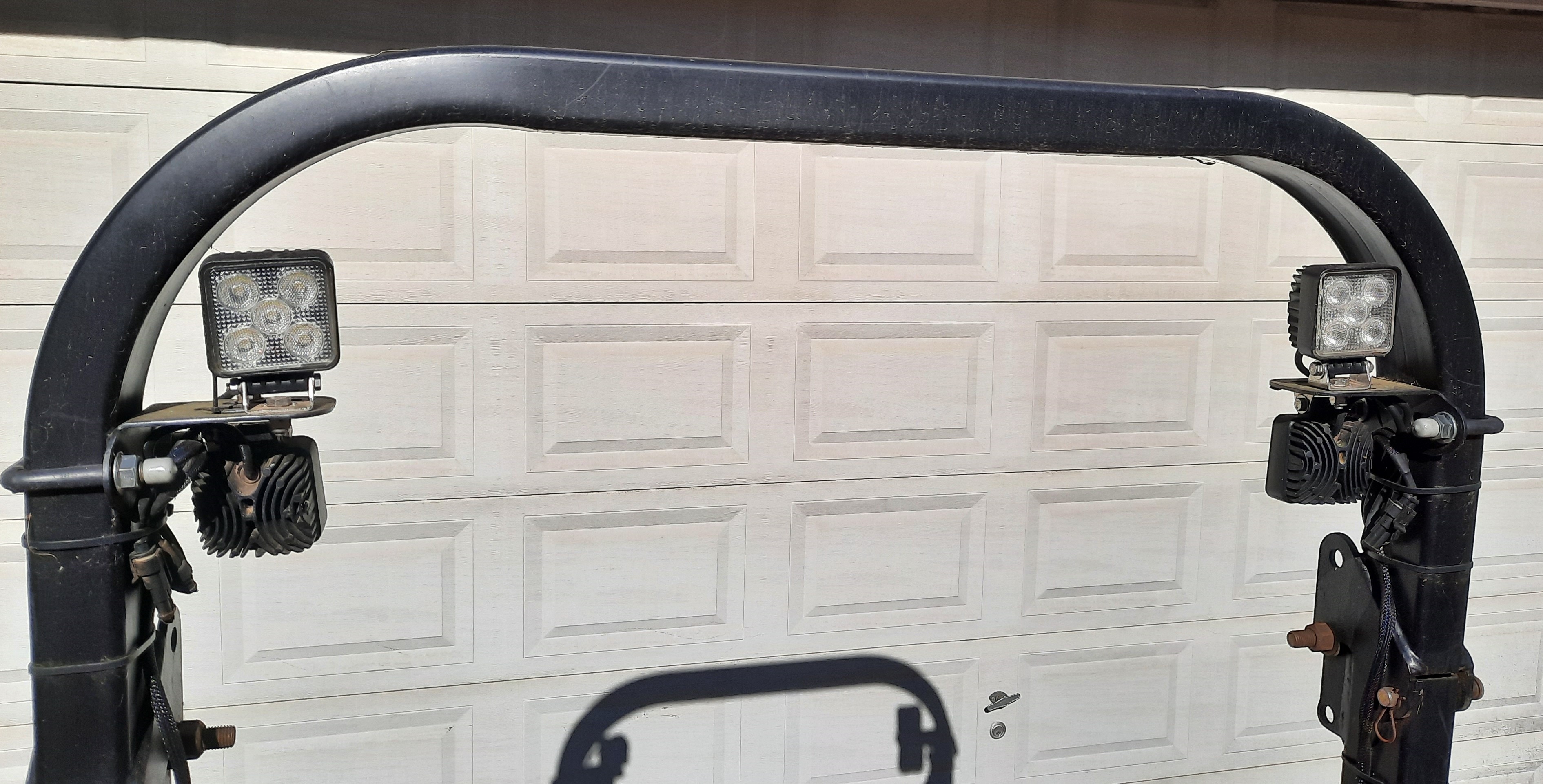

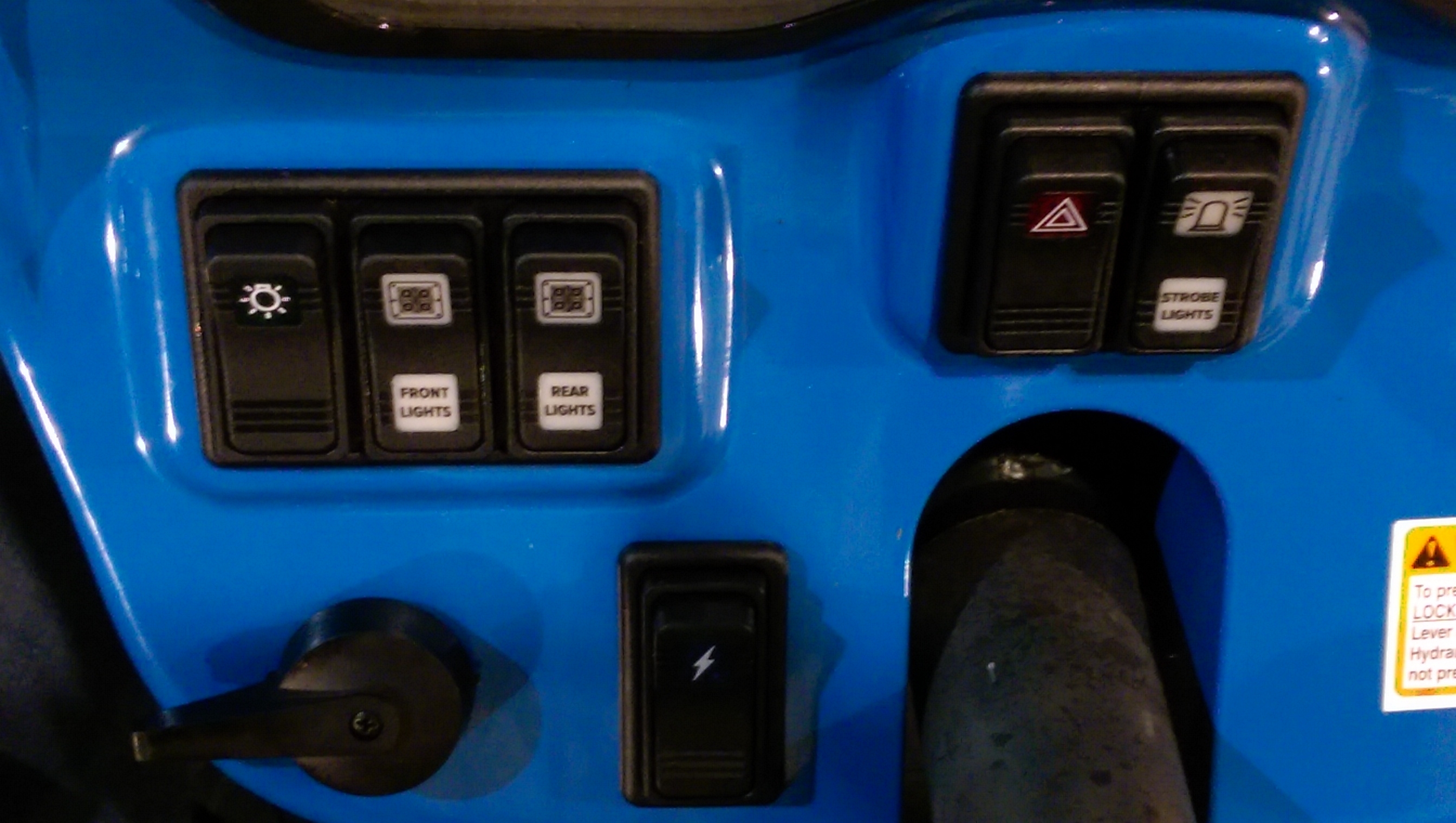

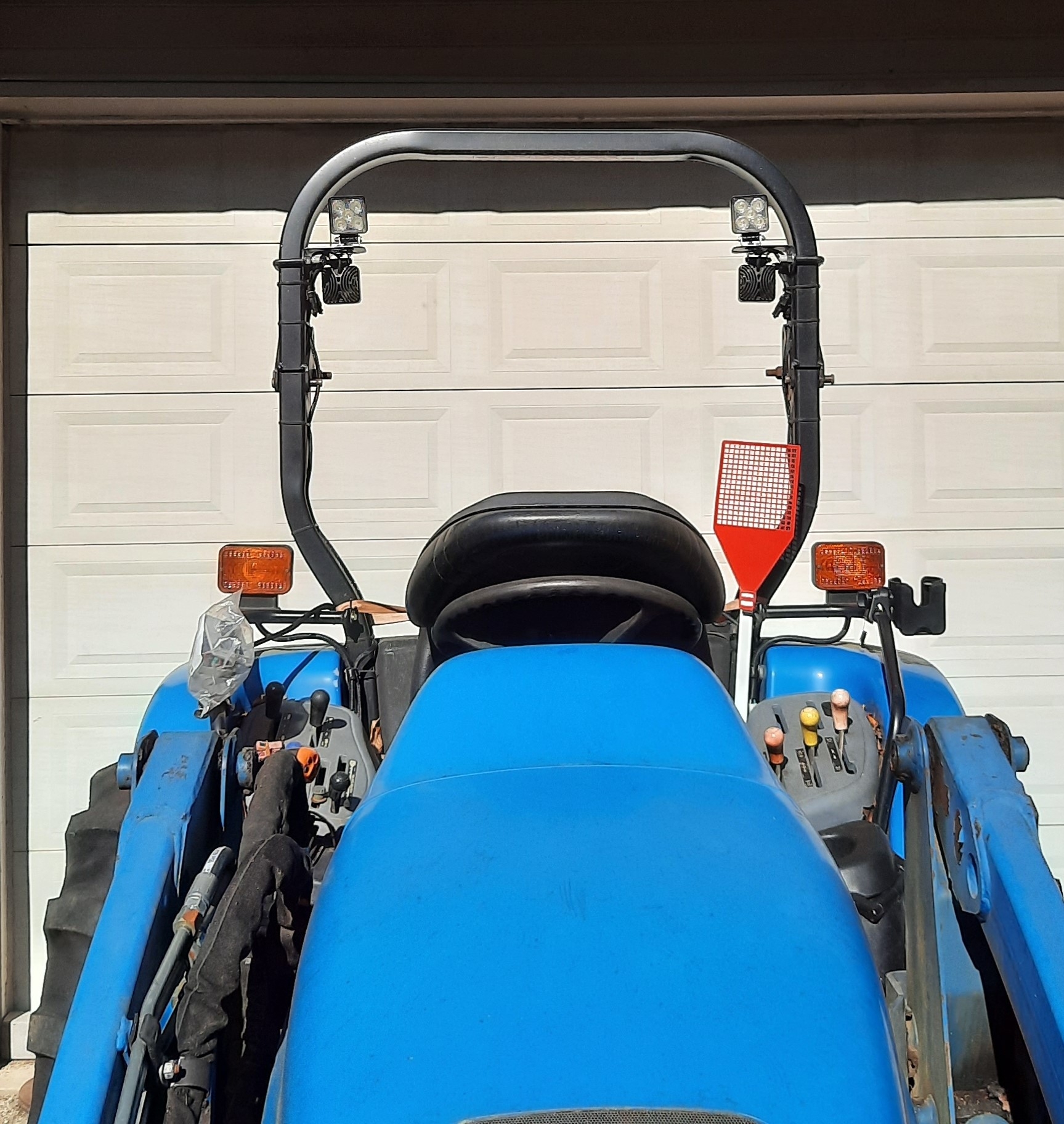

I added (4) LED lights to ROPS on our tractor, (2) forward & (2) rear facing; & the only thing I regret is not having done it sooner. I wanted the lights to be to the inside the ROPS hoop so they would be less likely to be caught on something (branch, tree, etc.)
I was originally going to make brackets to mount the lights, but found some brackets fairly inexpensive & with a couple modifications, we have been happy with them. Also added (2) independent switches to control the front & rear lights separately.
ROPS Aux Lighting pic - 5.jpg ROPS Aux Lighting pic - 2.jpg Aux lighting switches.jpg

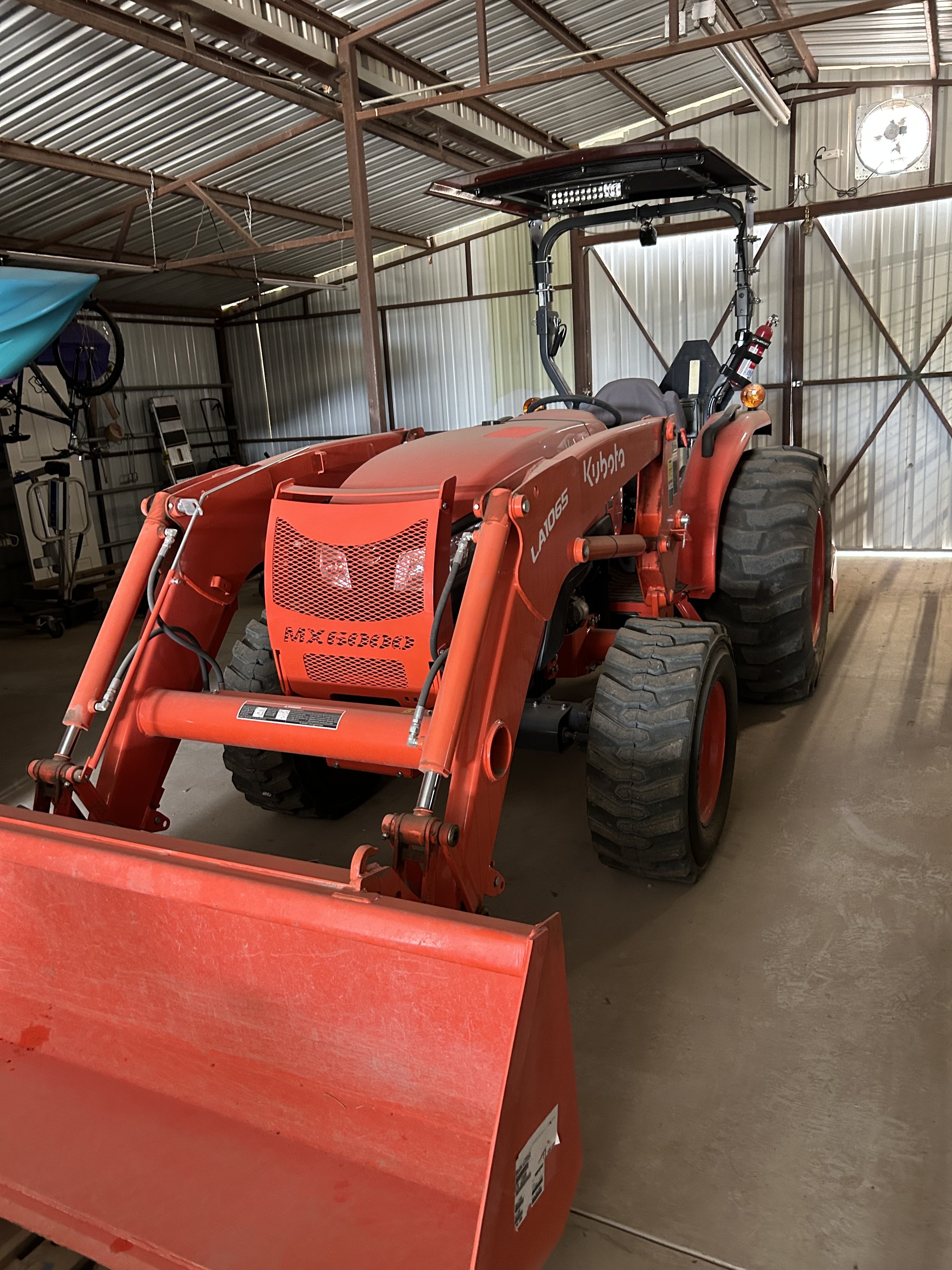

I have a steel canopy on my tractor and I mounted a foward facing light bar and a rear facing flood/spot light to the underside of the canopy.
Nice. I just ordered this one for my tractor. Used the lights last night and they illuminate the back of the loader bucket :rolleyes:
/ Ideas for lighting on a ROPS tractor #10
You will like that mounted high. It’s very similar to the 8” light bar that I have. I also mounted a small rear facing light.

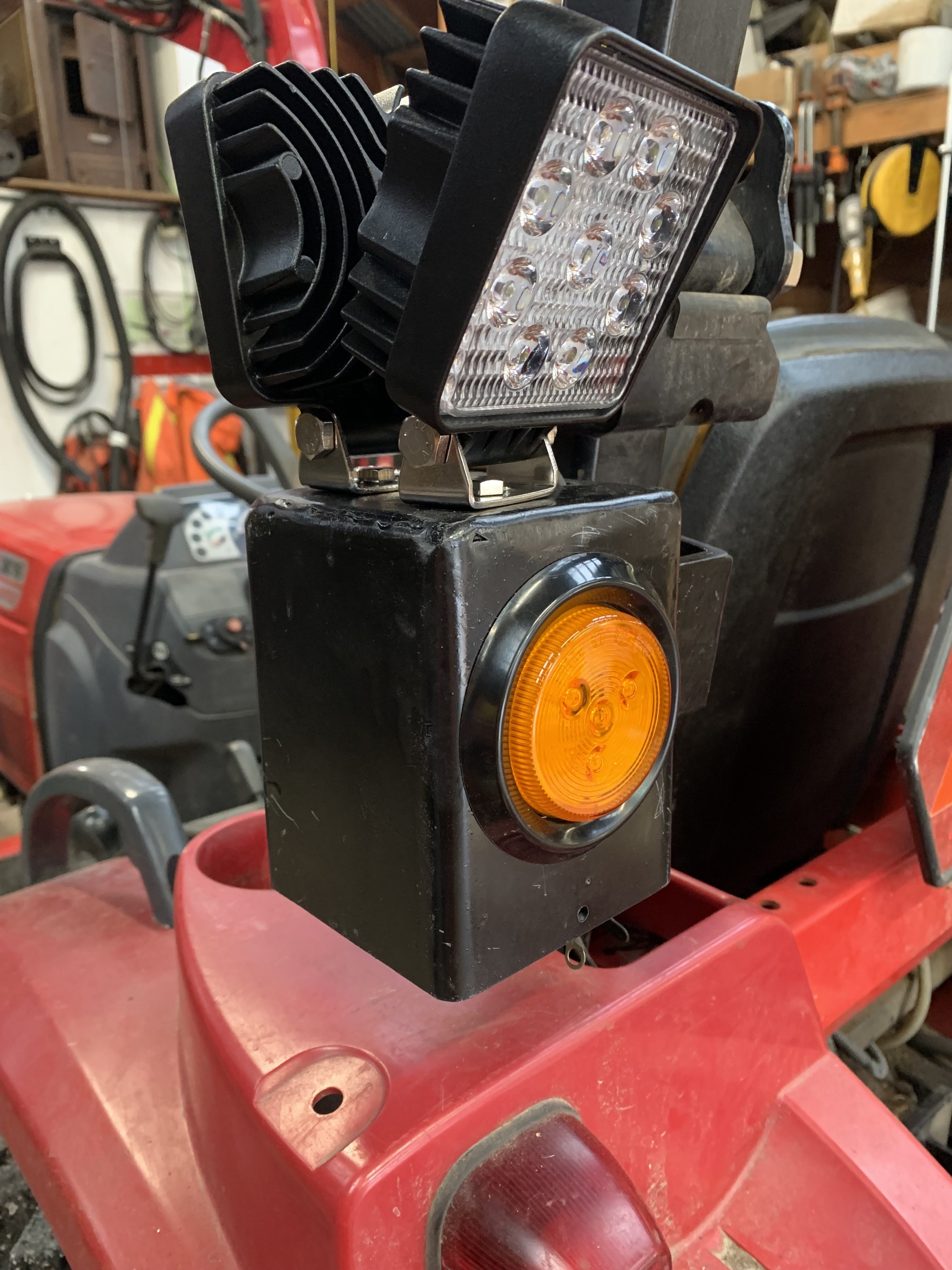

My tractor had plastic turn signals stud mounted on the rops just above the fenders. After I broke the second one, I made 2 steel cubes about 4” to mount on the turn signal tabs and mounted a couple of 2” led clearance lights on the forward and rearward sides for signals. I then mounted 2 led work lights forward and rearward on each side. I find they are perfect for lighting the work area.
Edit. Found a picture

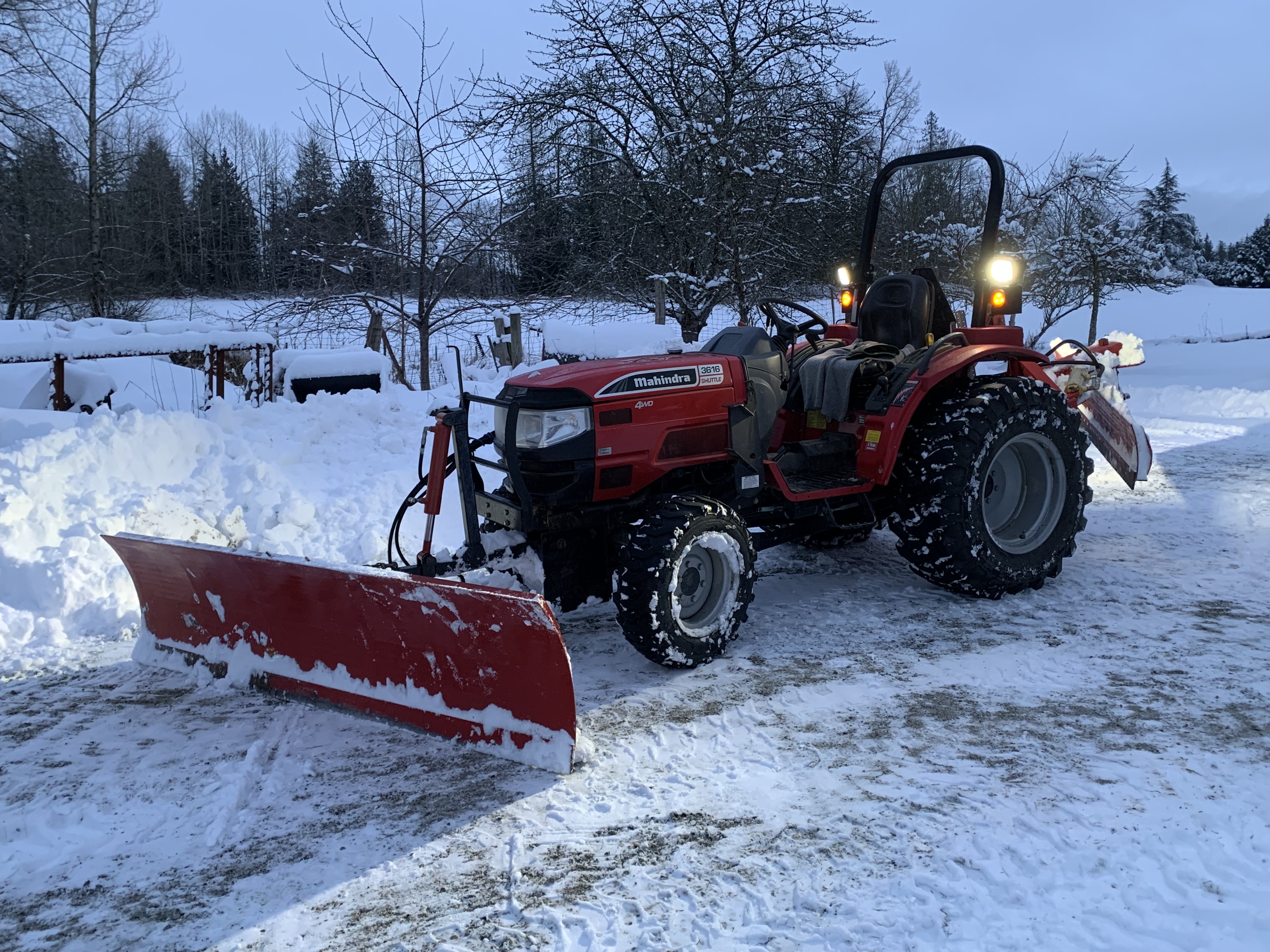

Snow plowing is also usually when I use lights as well.

I have my lights about eye level while sitting on the tractor. It’s true they are kind of annoying and can be blinding. I don’t feel I have a better place to mount mine so just learned to deal with it.
