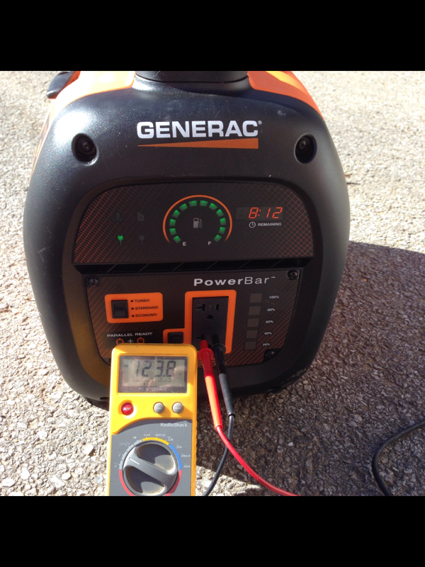

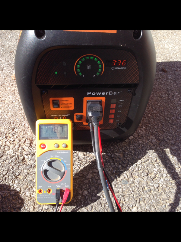

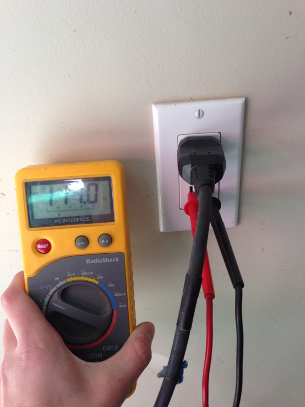

I went outside and tested my Generac generator. It runs amazingly constant, but doesn't handle high start up loads well. It runs with about 1 volt either way of variation which is pretty darn good for a generator. It puts out about 123 volts under no load. Under 80% load which was a 1500 watt heat gun it maintains about 119 volts. My house outlets maintained 117 volts with the same load and about 125 volts under no load. What kills the electronics was start up voltage. The generator dropped to about 110 volts by unplugging and plugging the heat gun up. That is acceptable, so I decided to try a miter saw. This miter saw was rated to pull 10 amps, but start up must have been much greater. My generator is rated to produce a tad over 13 amps continues. Starting the miter saw dropped the generator down to about 40 volts. After about 3 attempts to start it it tripped the overload on the generator. I have a cheap, extremely loud 3,500 watt generator that I'm going to test later. The miter saw dropped the house outlet down to about 100 volts. We recently ran the house for about 5 days with a 8,000 watt welder/generator that had about 10 volts variation. It was loud and very thirsty.

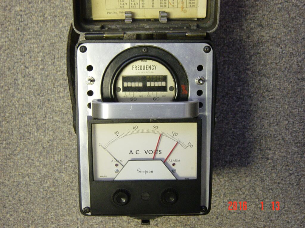

One of many things I built after my experiences with the BIG ice storm. DVMs tended not to have frequency functions back then.
It's big and clunky (the way I like things) uses no batteries, and has no computer. The nicest thing is, you can easily adjust the two red lines with the knobs and have over voltage and under voltage alarming. LED or buzzer.
