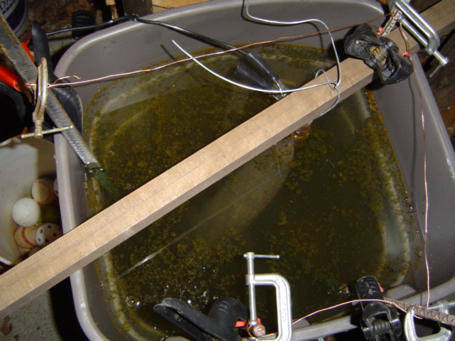

I'm not sure what size garbage can that is? it appears you may be a bit low on the soap strength. if that is 40 gallons then I think it is something like 1 cup for 10 gallons of water. so maybe add at least 1 more cup for a 40 gallon can... looks to be bubbling some though :)

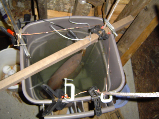

The can holds 34 gallons. A little small for this project, but only cost $20 and I can use it around the house when I am done with it. Currently it has between 25 and 30 gallons in it.

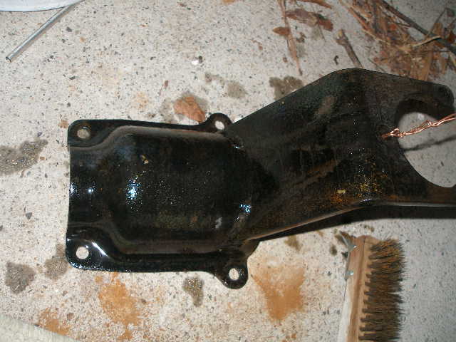

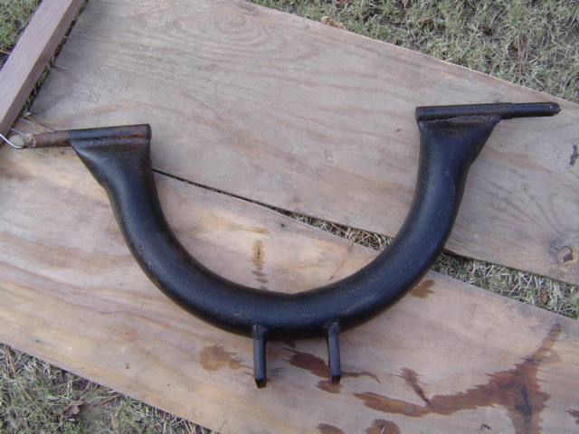

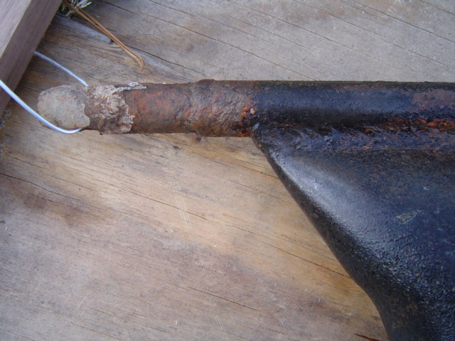

Time to check on the big piece. The charger has run about 6 hours (my guess since the thing runs about as well as Eddie Walker's water pump). Here are 2 pics of the 'yoke' before pressure washing. Note the one pin that was not submerged in the solution.
/ My electrolysis experiment
#25

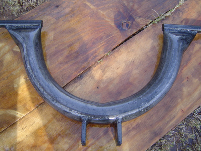

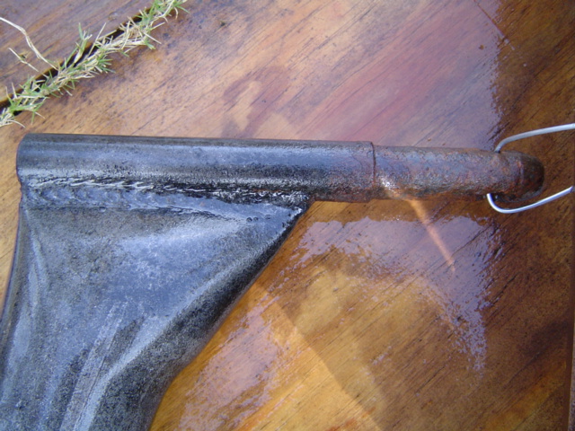

same 2 pics after the pressure washer. I turned the piece over, so now the dirty pin is in the tank and the clean pin is out of the solution. I also used the pw to clean off the rebar and angle iron. Very interesting to see how those pieces are being used up. BTW I am now running the charger on the "start assist" mode since my charger is a "smart" charger and turns itself off after a while on the charge mode. Charger gets warm, but no where near hot running like that for a few hours at a time.
Still have to do the gear head and the boom piece, then it will be time for the rebuild. So far so good. Should I do the auger? It is 12" and has the same amount of rust as the rest of the post hole digger parts. The rust is everywhere on the auger, not just where the business of making holes is done.

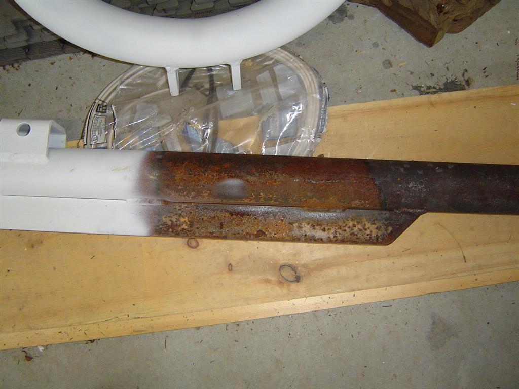

Here's the latest pic that shows an obvious oversight on my part. My trash can isn't tall enough. Oh well - I'll hit the middle section with the wire wheel on the grinder and hope it works. Left side has been primed, middle is still rusty, right side is after electrolysis and the pressure washer.

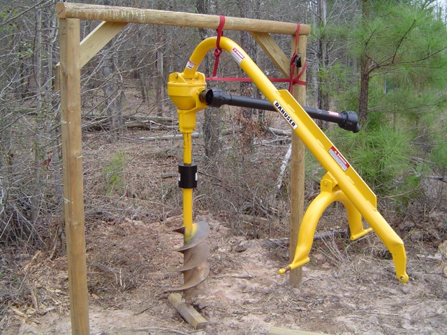

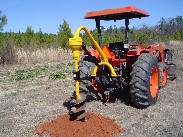

Been a while, but the project is complete. Here's the finished product.
Free tip of the day... Spend the extra 20 cents on nylon locking nuts for the shear bolt. The regular nut supplied with the shear bolt worked loose and fell off after 4 holes.
