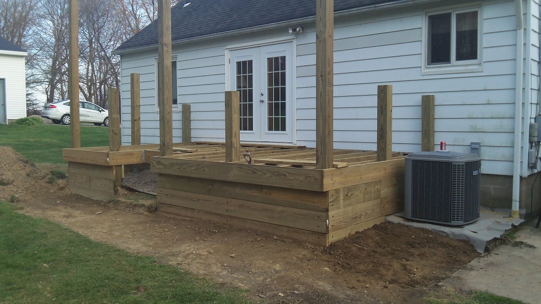

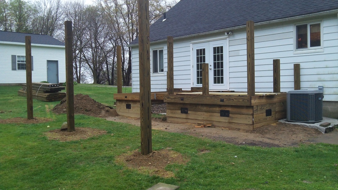

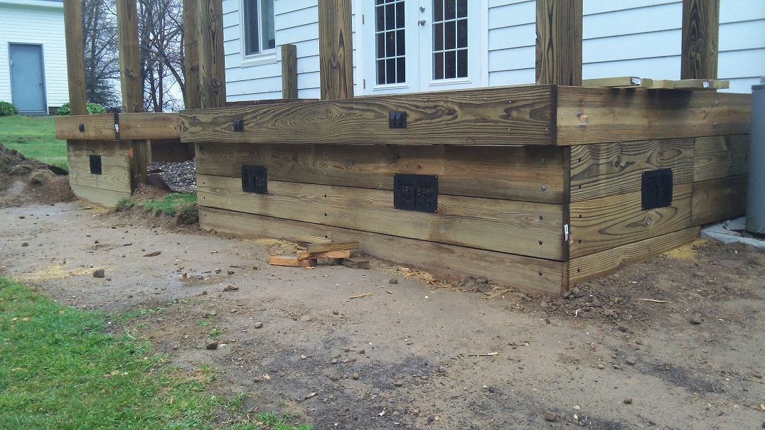

The header beams are 6x6 beams/posts 10 foot span between posts.
When I mentioned the header, I was referring to the header over the door, shown in the first two pictures you posted, not the header beam(s) for the deck roof.
In ohio,code does not require notching the post and two lag bolts per post is code.
It may be minimum-code (in Ohio) to use only two lag bolts, but more than 25 years of experience has taught me that it's much safer to notch the support posts for the beam, because anything less (IE: two lag bolts) puts the deck at risk for a possible collapse.
I suggest that you refer to the International Building Code (Also known as the Uniform Construction Code), which is likely to be more up to date with the latest reccommended best-practices.
For more information, see the following document from the American Wood Council, which is derived from the International Residential Code, and is the source of the pictures (page 8) I posted previously.
Residential Wood Deck Construction Guide:
http://www.awc.org/Publications/DCA/DCA6/DCA6-09.pdf

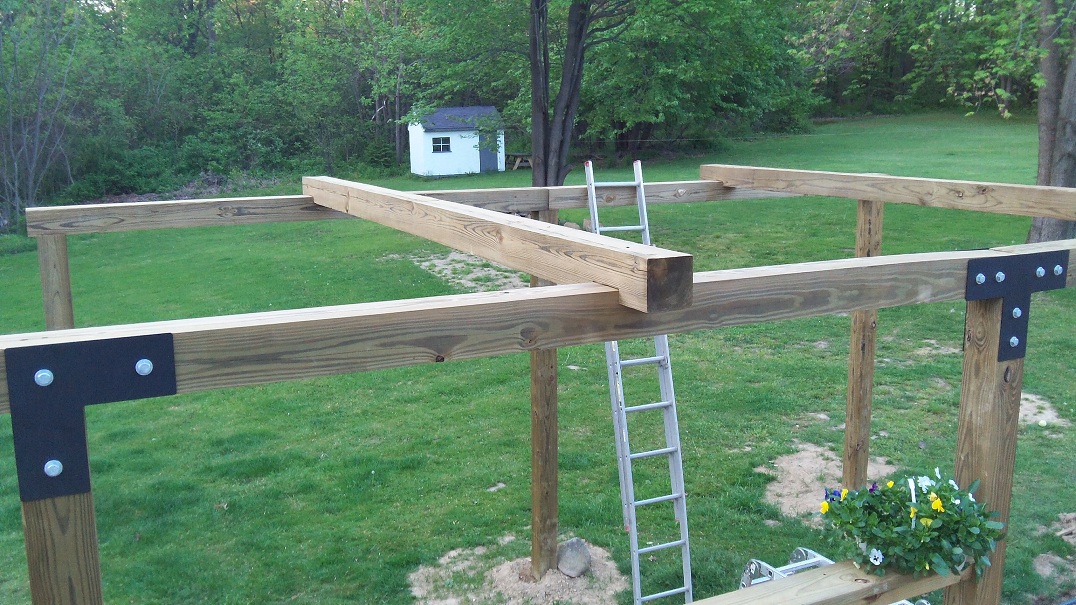

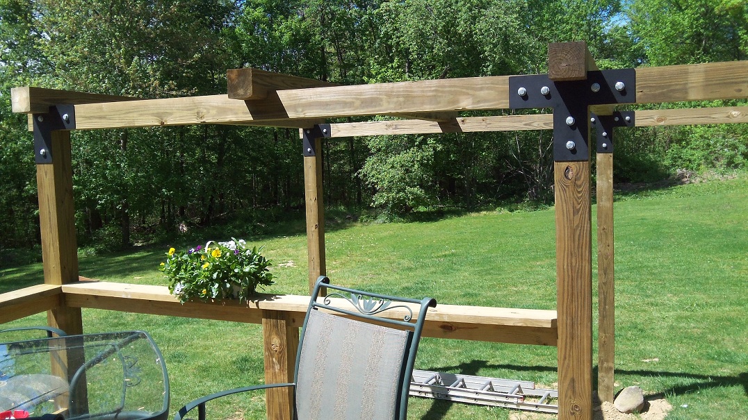

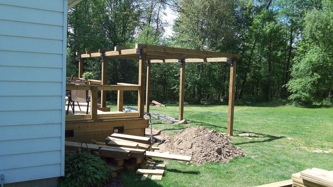

Bolted up 6 of the brackets and set two of the beams today.I hope to get 6 more brackets and the remaining 3 beams done tomorrow.

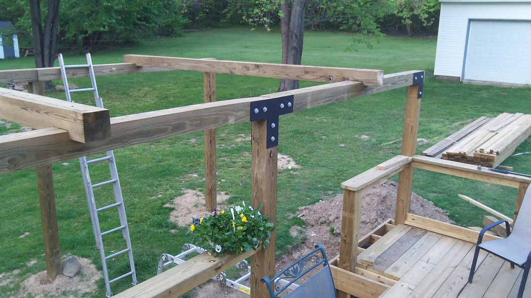

I like your brackets, I need to make some of those for my porches.
Thanks Motor
I had these laser cut and they are 1/8" thick, I think they should really add a nice look to the deck.
/ my deck/patio project
#66

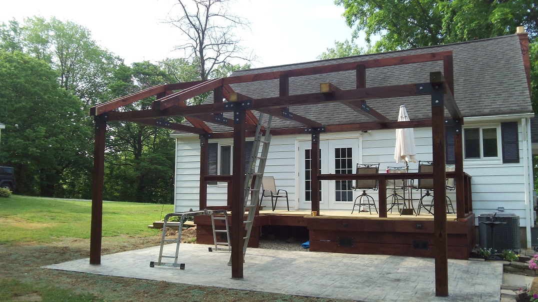

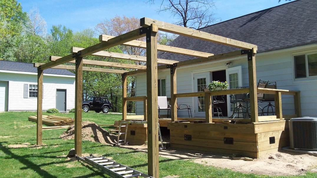

Progress for today,all beams and brackets are up ,so now I will be starting on the roof.

I hate to rain on your parade, but are you planning to put some kind of balusters on the space between the railings and the deck? Most building codes require a suitable railing (including balusters with less-than-four-inch spacing) if the drop-off between the top of the deck and ground level exceeds 30 inches (used to be 36 inches). It sure looks like more than 30 in. to grade, at least on the downhill side.
#68
Baluster will be the last thing on the list , I will be staining everything before I install those.
Balusters http://www.decksdirect.com/traditional-baluster.html

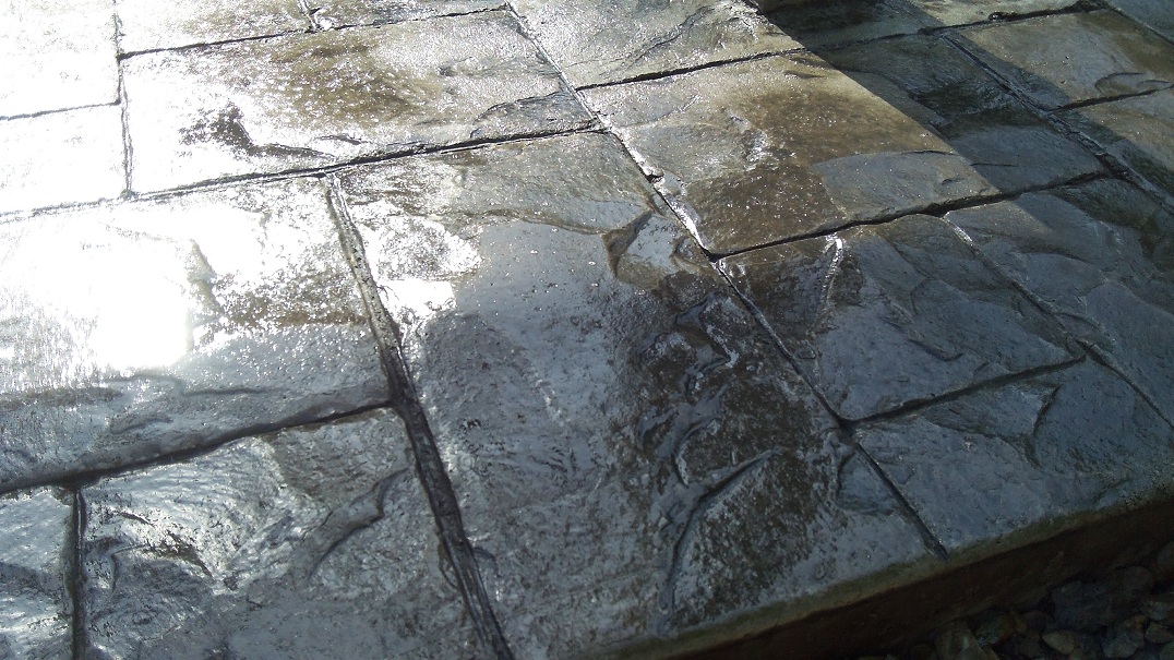

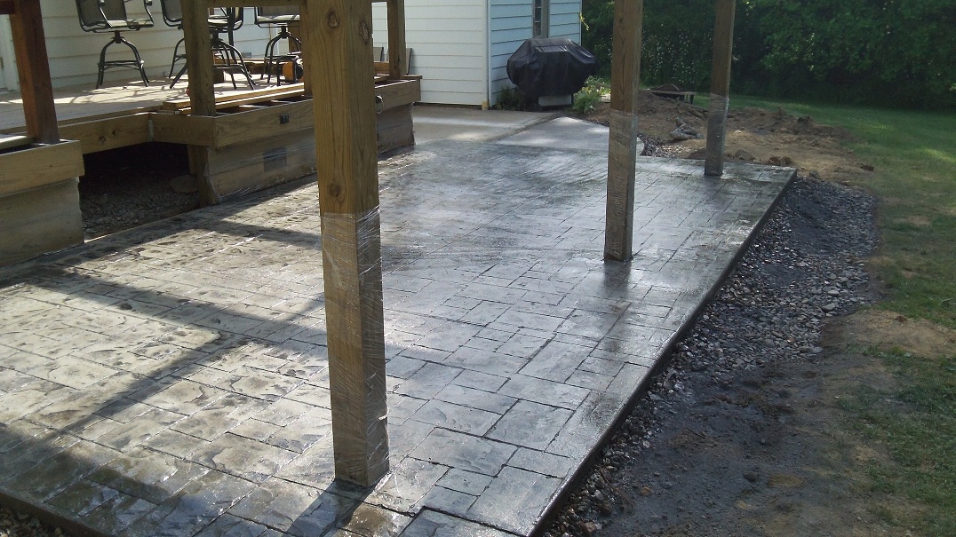

concrete is done.

That looks really sharp! Was that something you did yourself or did you hire it out?
/ my deck/patio project #71
I'm loving the concrete!!!! That just looks amazing.
Eddie
/ my deck/patio project #72
WOW good job!! :thumbsup::thumbsup:
#73
I was a part of doing it, but not the brains of it.My daughters boyfriend has done many of these and he was the one that did the majority of the work.I also had two other friends helping out.

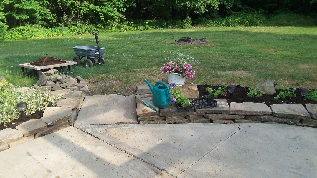

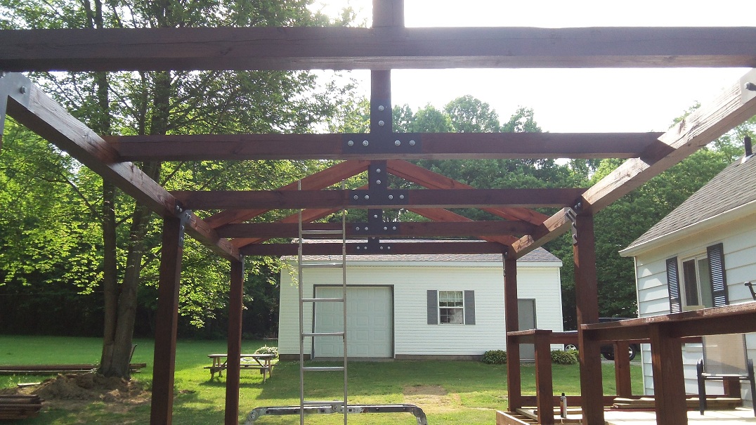

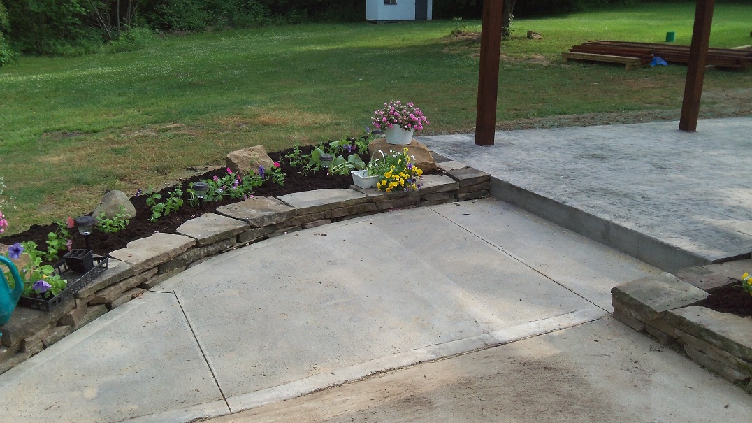

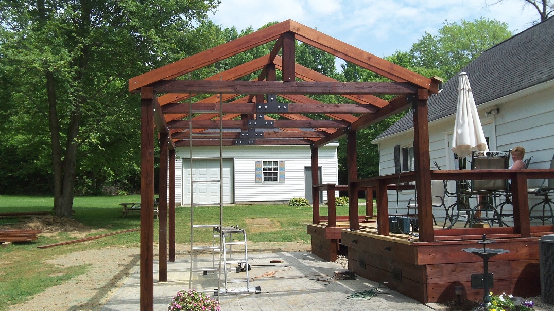

The wife and I have been busy,we have the majority of the staining done and some landscaping in.I started on the roof yesterday and hope to finish it this weekend.

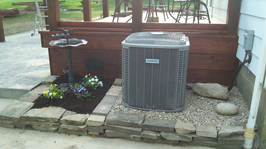

A few more pics.

Everything looks great! I really like the rock landscaping as it ties in the stained wood and stamped concrete.

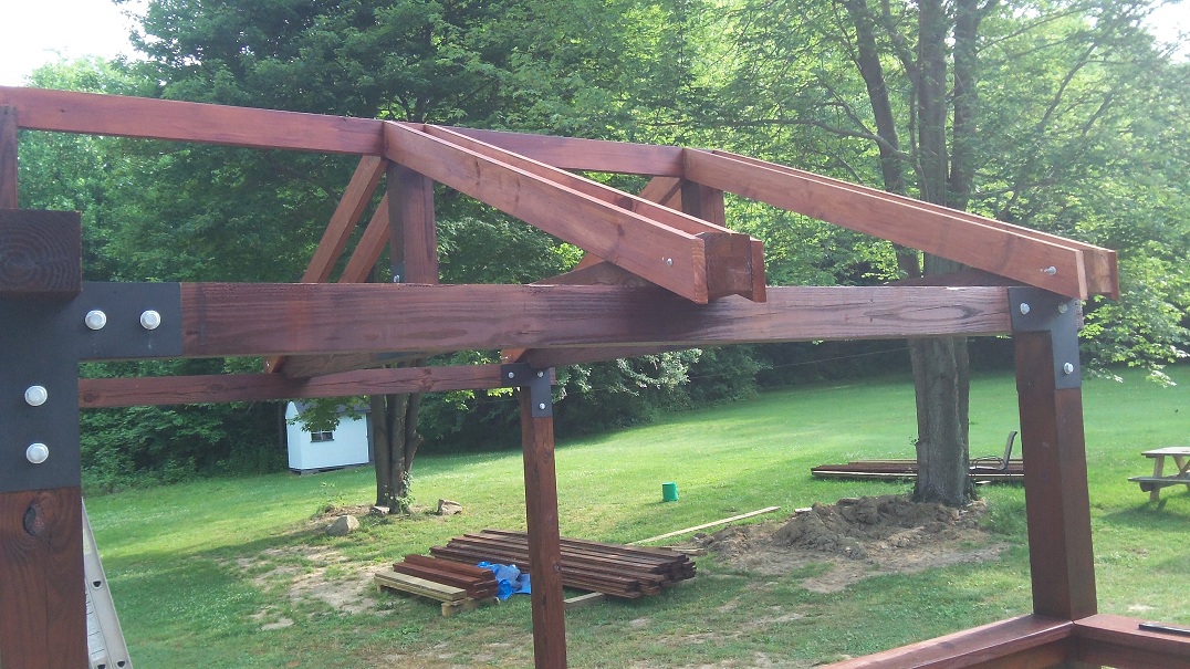

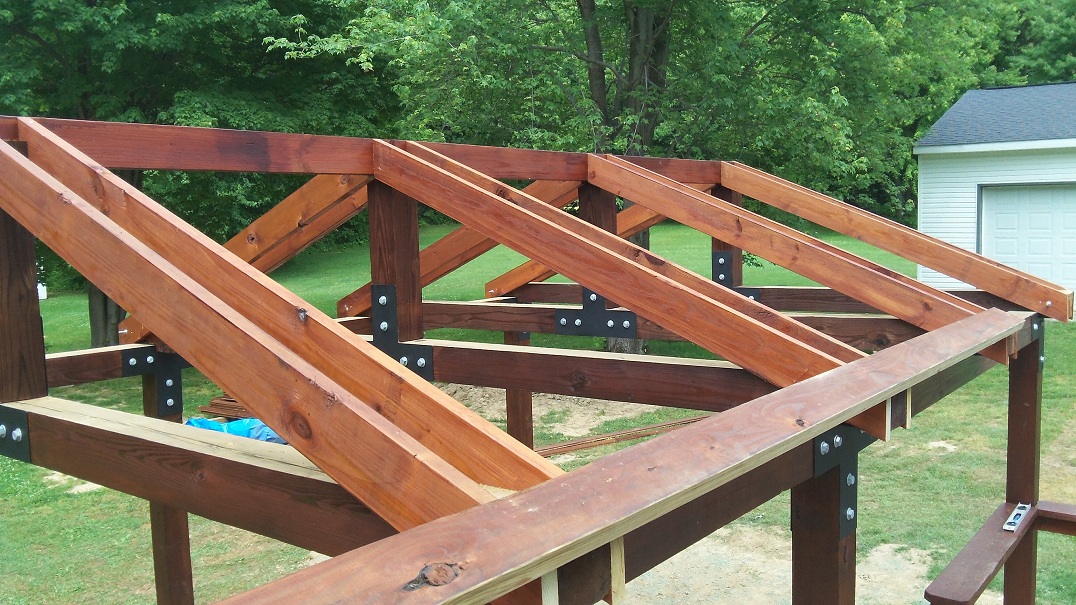

Finished up the roof trusses, now its time for the tongue and groove.
The heat is horrible rite now,so I am waiting till this evening to go back to work. :(
