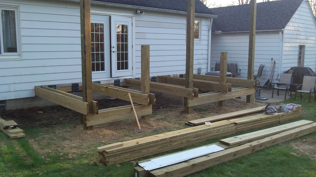

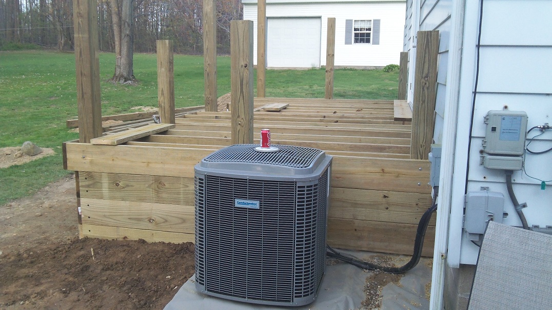

Looking at your pictures again, you may have to put a noise barrier around the AC unit. My house has a small alcove for a back patio which I never liked. I poured a slab extending out and along the back side of the house. This was great but the AC, placed similar to yours, was really annoying each time it turned on. I finally got tired of the noise and moved it around the corner of the house. The original AC was really noisy, the newer replacement is a lot quieter, like yours, but still would be a distraction.
BTW, my project looks similar to yours. I have four 14' pipes sticking up out of the ground.
/ my deck/patio project
#22
I agree,I think I may need to do something about that.I checked to see what it would cost to move it ($300.00) so I dont know if that is an option.
Good luck with your project!!!

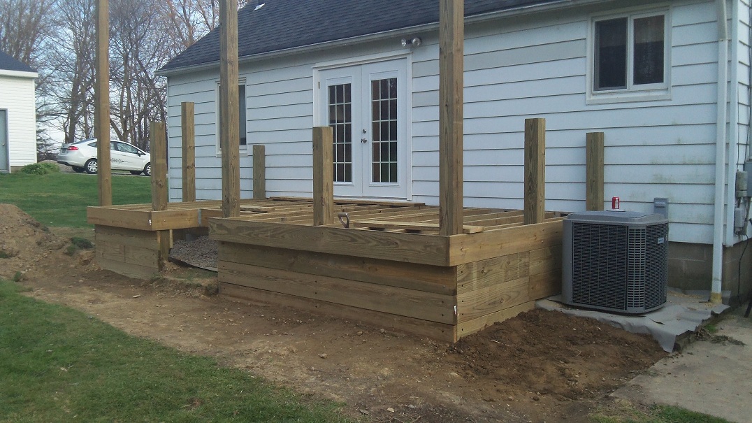

I had a good day (got started at 10:00 am).completed everything I wanted for the day and best of all,I spent some more quality time with Dad.
They have changed the forcast for tomorrow,so I hope to get some of the
skirting up.

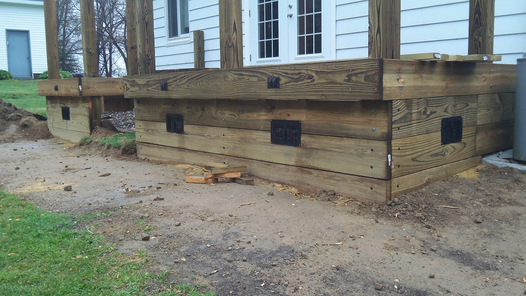

Front skirting is on and will be finishing up the side skirting during the week.

This might not apply to you since I've never lived there, but here in the south, you absolutely HAVE to have air flow under a deck to stop mold from growing. Once moisture gets under the deck, the air flow is the only way to dry things out and keep them dry. That skirting looks like it will stop the flow of air and create the perfect environment for mold.

Good point,these boards are pretty wet,I assume they should shrink and create gaps for venting.I will give them a year to see how much shrinkage I get and if they dont gap,I plan on installing two vents on the sides.

The more I think about it,I am going to go with Eddie's advice and put six vents in.I am looking at foundation vents, that I think will work just fine for the deck.

I had a client that had a big deck that was all sealed in. I had to get under it to run some wiring and found that it was soaking wet in there, and covered in mold. I showed them the problem and that the reason was because of no air movement.
They are terrified of snakes and wanted it sealed up to keep them out. While that worked, it created other issues.
They came up with a really nice idea of cutting stars into the wood and attaching screen to the inside. I wasn't there to see them do it, but I did see it after they had finished. Each star is about a foot across, and they are about 4 ft apart.
Best part is that it solved the moisture problem!!!!

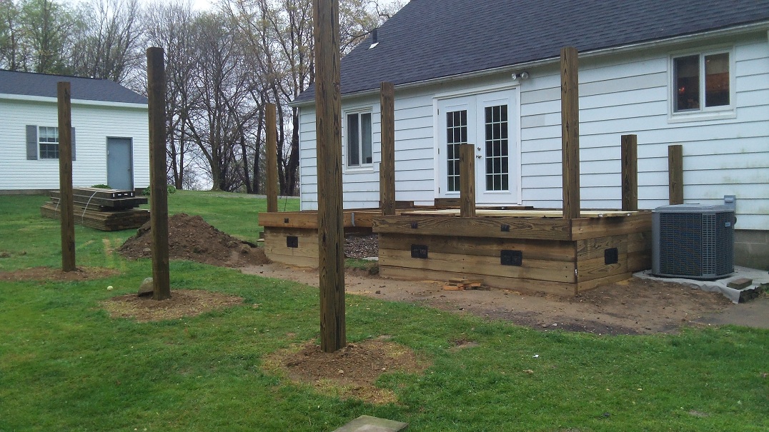

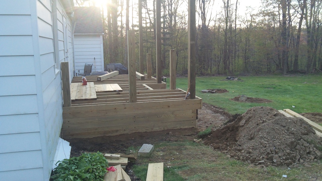

Finished up the other end tonight.they are calling for rain and thunderstorms tomorrow,so it will be a good day to go buy more supplies.

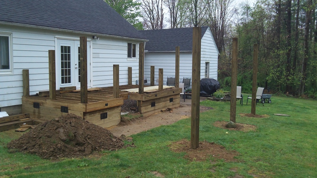

I was able to get a little more work done on the deck/patio.I put the last 3 posts in for the patio area,I also put 6 of the 7 vents in and the electric.
The forecast for this week is not looking to good,so I dont think I will be getting much done until thursday.

You suprised me with those posts out in the grass. How far is the roof going to go and what's happening in front of the deck?
Eddie
#40
Eddie
Eddie,the six taller posts will be getting a roof attached to them.that area will be the patio/pavillion area.I will be pouring a 24x15, stamped concrete pad there.
The roof will be made of 6x6 treated lumber (for the beams) and 1 1/2" thick treated ,tongue and groove.I will then felt the roof and put a tin roof over that.
