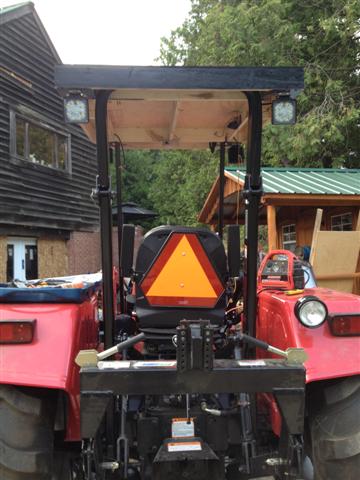

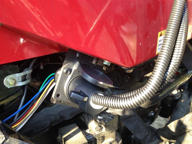

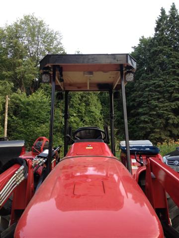

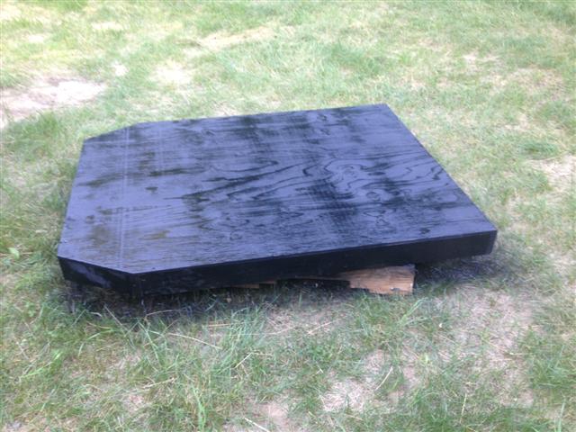

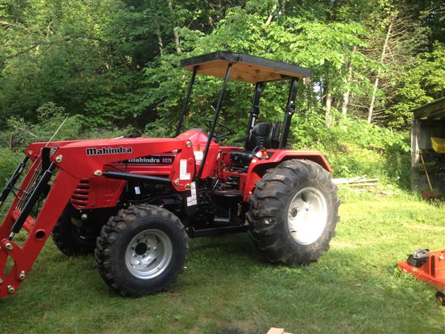

I wasn't positive I wanted a canopy on the tractor so I slapped together a quick and dirty prototype in the workshop out of 1x4s and plywood. Shot it with some black paint to match (see below).

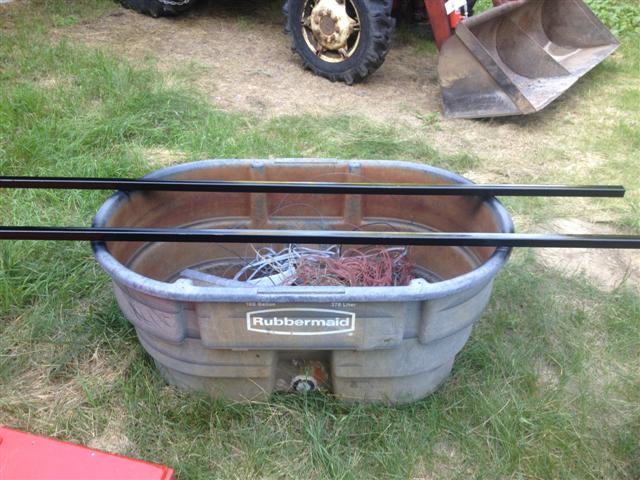

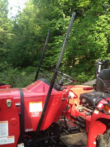

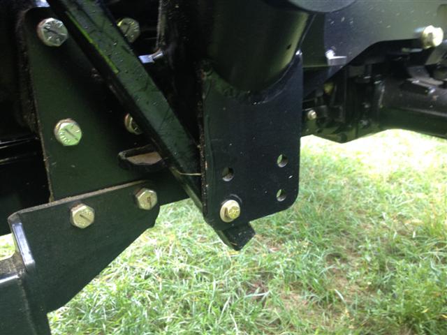

I used the ROPS as the rear support and two 1 1/4" square tubes for the front support. For whatever reason, Mahindra saw fit to give me these wonderful brackets under the loader mount to bolt my front supports. How nice of them... :)

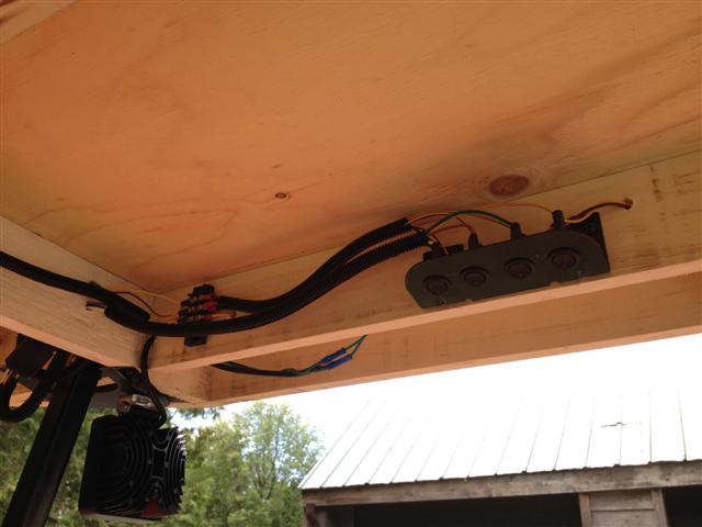

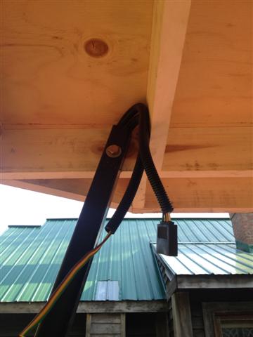

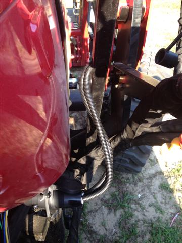

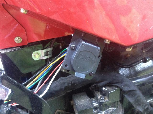

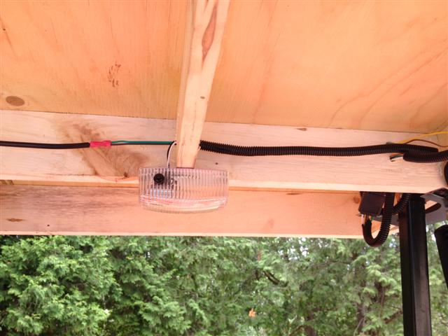

I knew I was going to add lights, and wanted to keep the canopy removable if needed, so I used trailer wiring connectors to make the wiring pluggable.

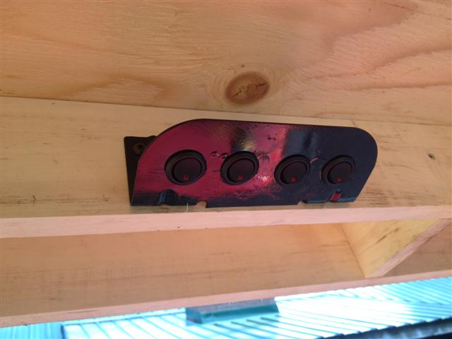

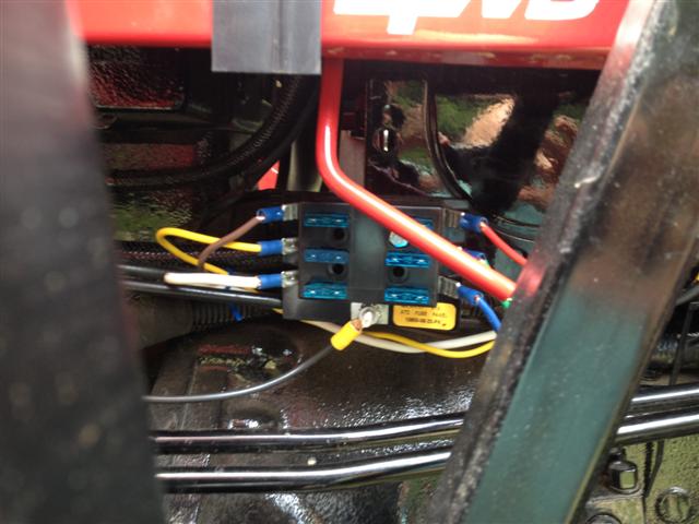

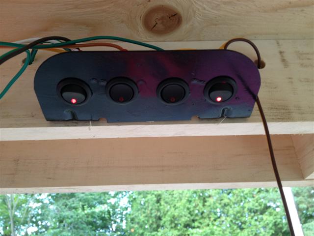

Next was to add the wiring and switches for the lights (and leave some extras for future accessories). Added a fuse panel for safety...

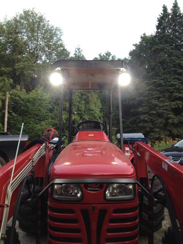

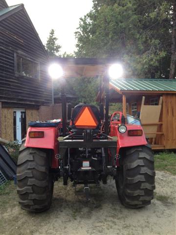

Found a great deal on some LED lights locally and put 2 up front and 2 at the back connected to the overhead switches.
Next was a dome light and some tidy up of the wiring.

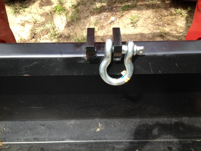

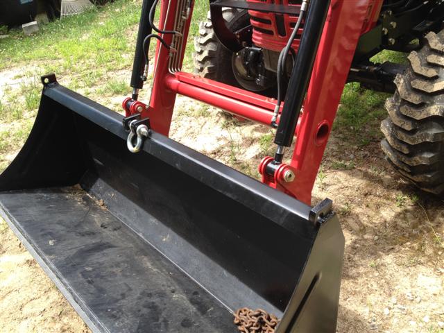

Last but not least - I added male tangs to the bucket so I could easily attach chains for lifting, and a quick hitch with hydraulic top link to the back...
I've still got 2 extra switches up top. One I will likely use to add a beacon for safety while traveling on the road. The other one may control the fender mounted coffee maker... ;)

I think my favourite add are those lights. They make the stock lights look like the glow from a bic lighter. Turning them on is like driving in daylight!

/ My 4025 4wd Modifications
#12
Ok - I'd say the difference is fairly pronounced... :)
Here are the Mahindra low beams:
Here are the Mahindra high beams:
Here are the LED lights I added:
Here is the rear plow light:
Here are the rear LED lights I added:
Sean.
