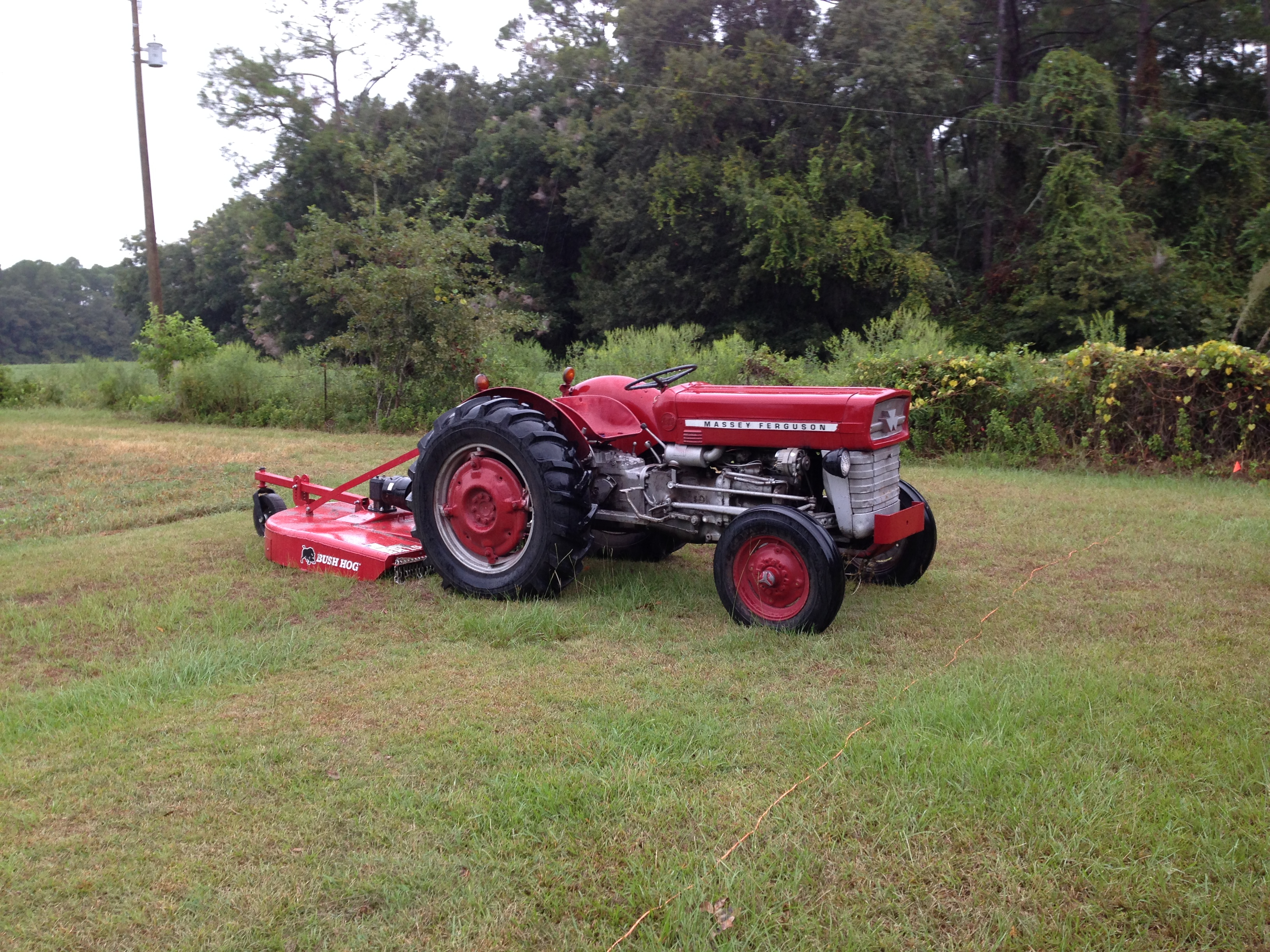

I inherited my dads 135. He fought electrical gremlins for 40 years. At some point a single wire alternator was installed and the regulator abandoned. What a mess left behind! Hope to clean it up one day. My dad kept it rattle can painted.
I tried to upload a copy of a scanned owners manual but apparently the file is too large. Enjoy your new tractor. They'll outlast all of us.

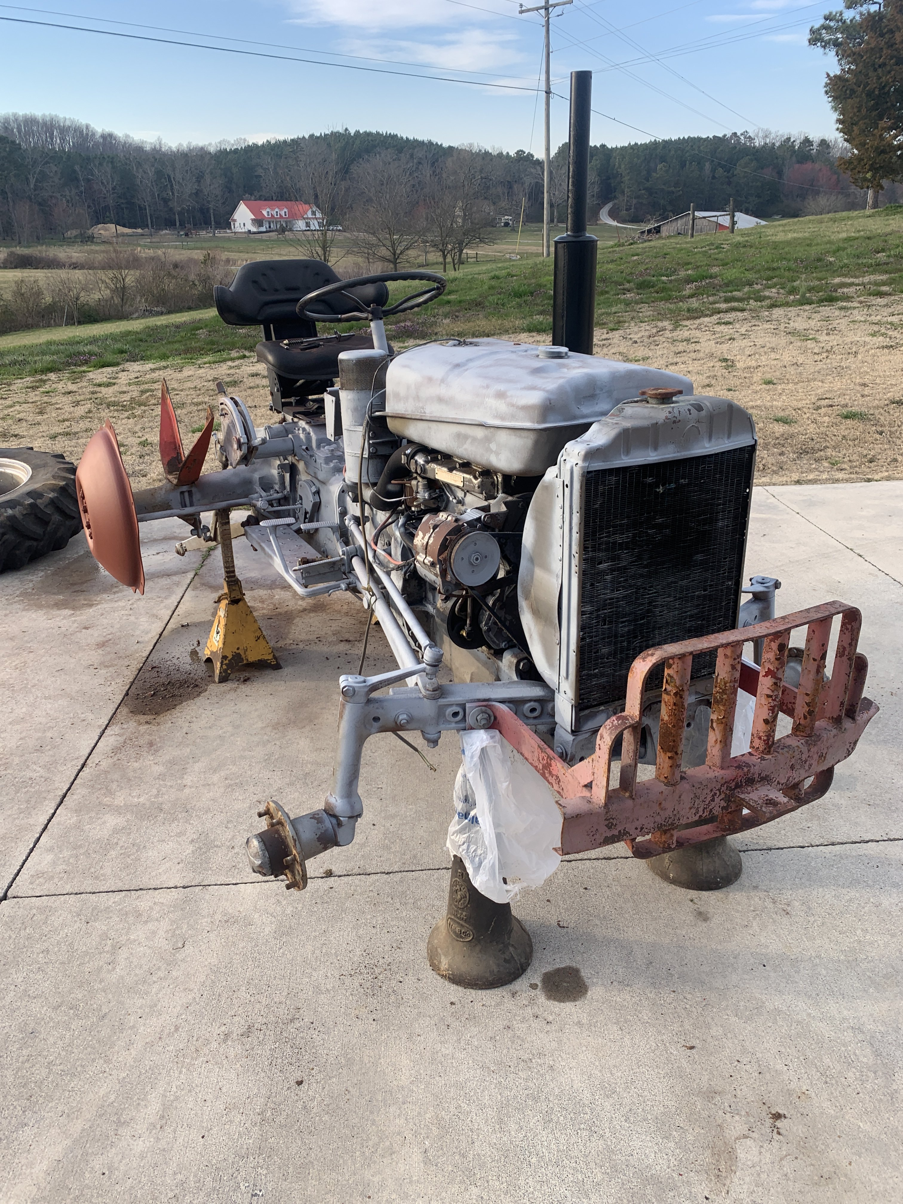

I see you apparently got your steering wheel off without much fuss. Mine nut is rusted and my impact turned it into rust powder when i attempted to remove it. Also, I have learned from your photo that my steering shaft is likely not tapered. Once the old wheel is removed, it will be replaced with a Nardi wood wheel. Also, I believe I am going to have to remove my Cav pump and install a new front o-ring seal. My oil level is creeping up and I suspect it is diesel fuel slowly leaking into the engine sump....but, enough of my stuff...keep the progress coming.
The steering wheel was not an issue for me. The nut and washer were missing. I actually shot it with some PB Blaster and pulled it off by hand the next morning.

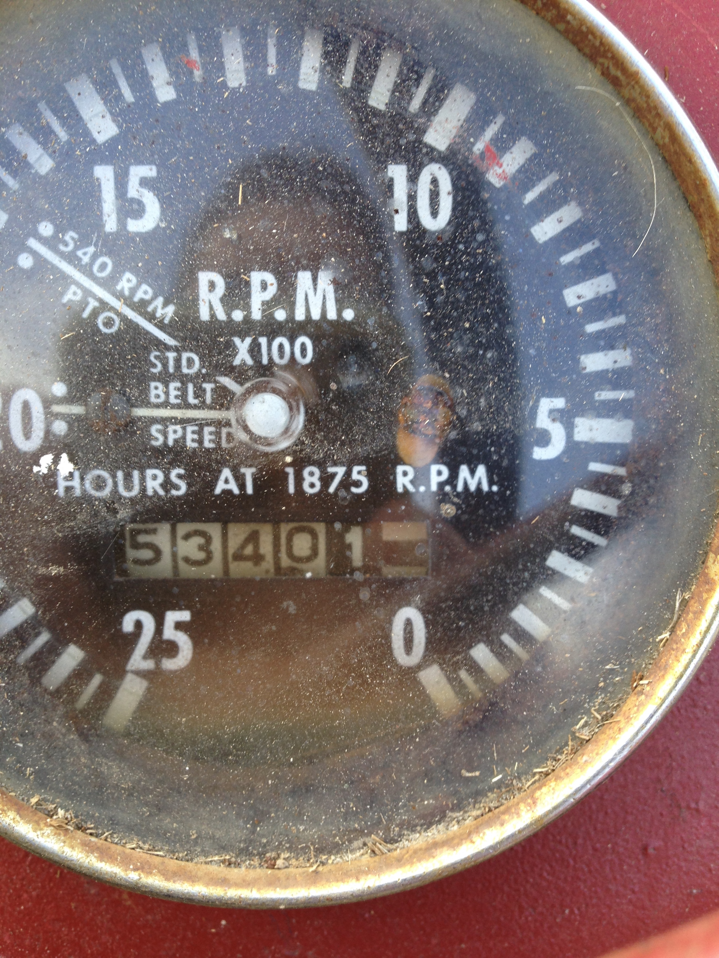

A coat of paint goes such a long way. You'll be even prouder of her. If you find a good reproduction of the original tachometer please let me know. My needle is gone. Note it's counterclockwise.

I am looking at replacing all of the gauges and switches. My tach was disconnected and full of rusty water, others full of condensation, headlight switch rusted up, etc.. I have located some aftermarket units at yesterdays tractor but not an original reproduction of the tach. I will keep an eye out in my searches. I couuld potentially send you mine if you think you could salvage the needle.

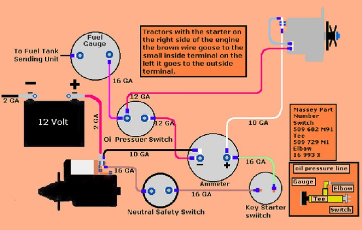

Hello F6pilot, re the water in gearbox. There are 3 primary culprints. The 2 obvious ones are the gear stick boots. Yours have been replaced at least once judging by condition, HOWEVER make sure the boot is properly seated and snug. The 3rd culprint is the boot on the draught control linkage which is easily overlooked. Look at the top link connection point then look forward at that level and you will see a rubber boot. It is easy to show and hard to describe.
Electrics: Check the condition of the insulation, it will probably be getting cracked at that age and be easier to replace than repair, also you will know exactly where things go to.
Originally these tractors came out with a generator, when the generator wore out it was replaced with an alternator.
Front Axle Pivot: there are 2 zerks, 1 for each bush(front and back) The back zerk is on top of the axle and under the fan shroud and you need a long nozzle to reach it. There is a part on the MF240 that can be fitted to (135) remote mount the zerk for easy access.
There is 1 saftey switch on the MF135, it is located on the top of the gearbox. Warning sign it is failing is the key is totally dead, not even a clik from the starter motor (flat battery) After 40+ years the termanals have corroded through.
