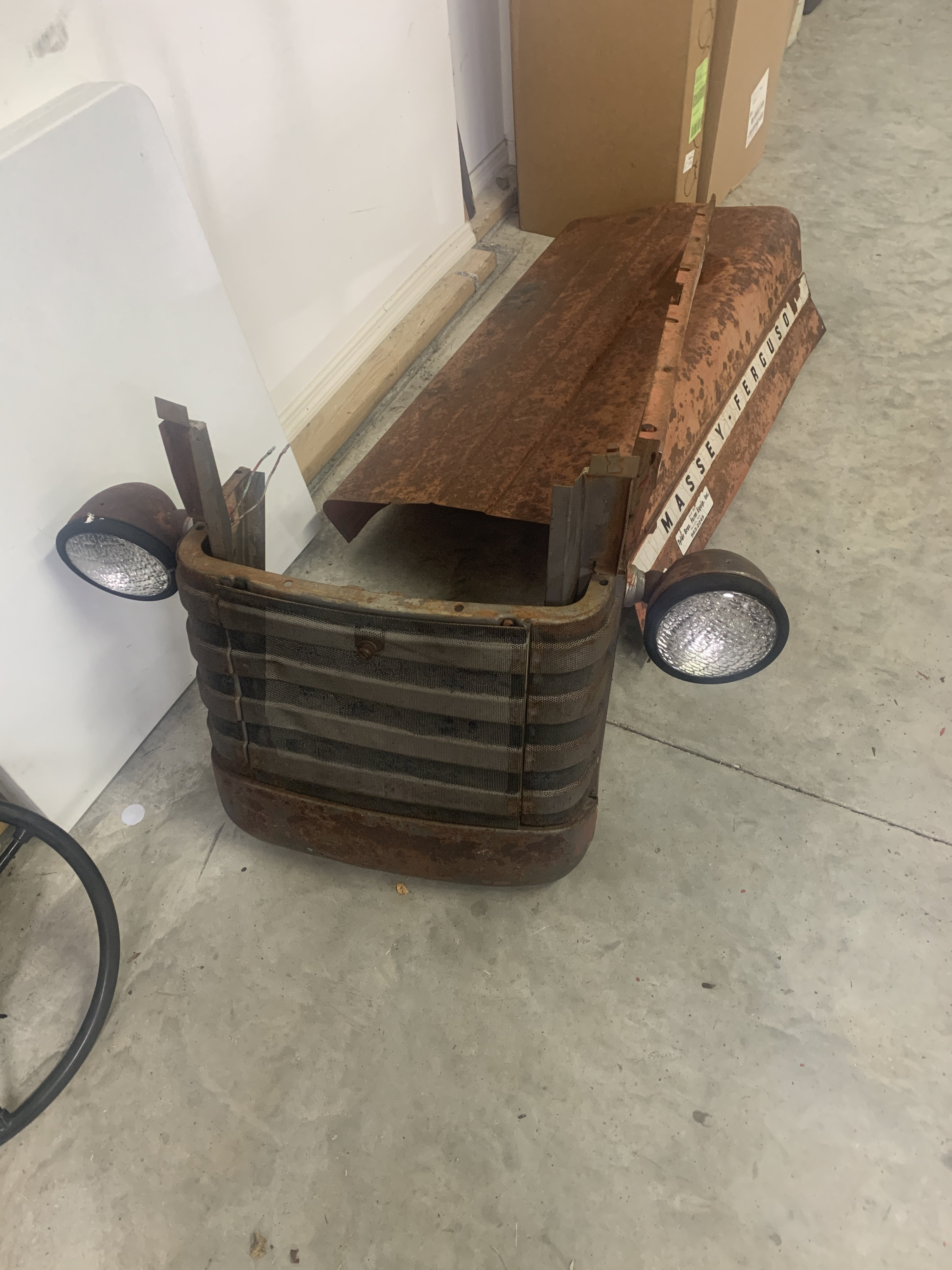

I purchased my first tractor this past weekend, a 1966 MF135 Perkins diesel. She’s an ugly old pig but seems to be in fair shape mechanically, cranking immediately and running smoothly without smoke. In the coming weeks I plan to change all fluids, chase down and repair all of the chopped/spliced/disconnected wiring, and clean/degrease/prep for paint.
/ My 135 Journey
#2

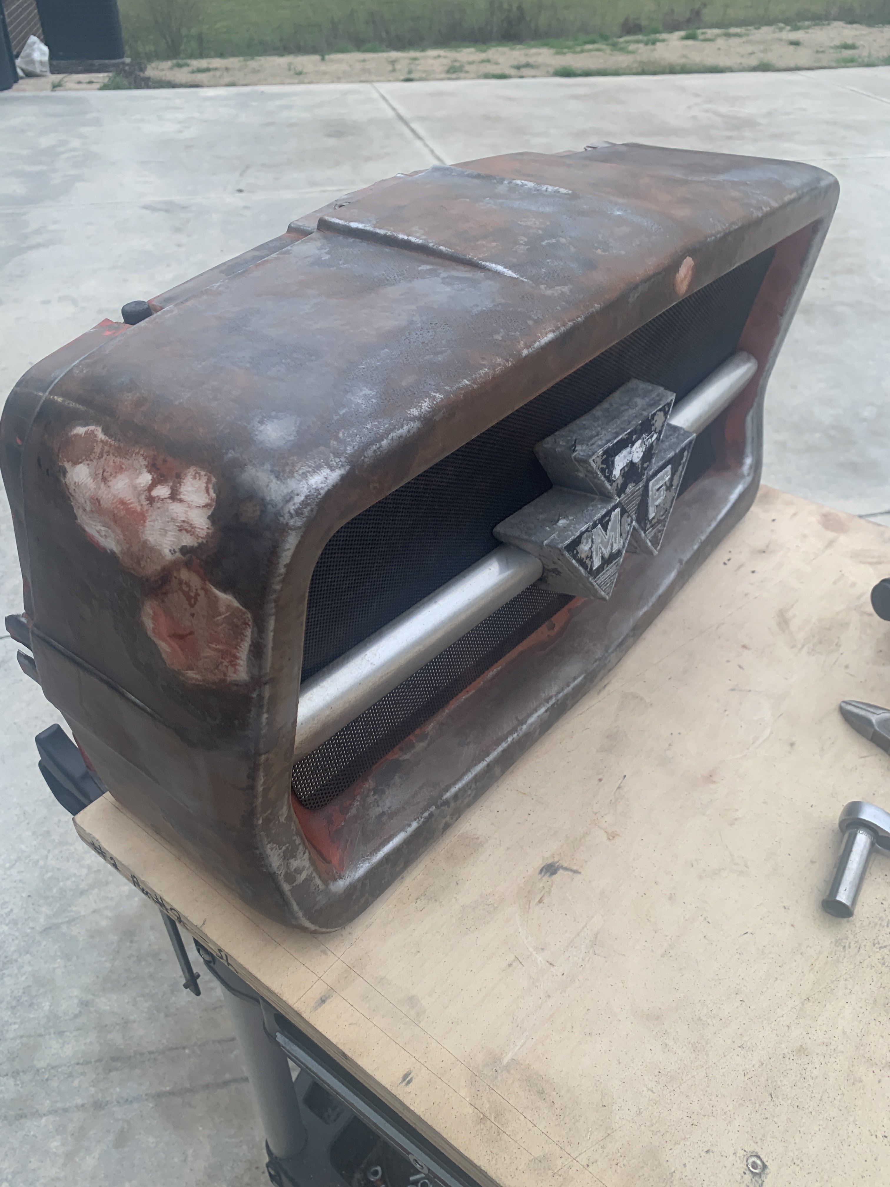

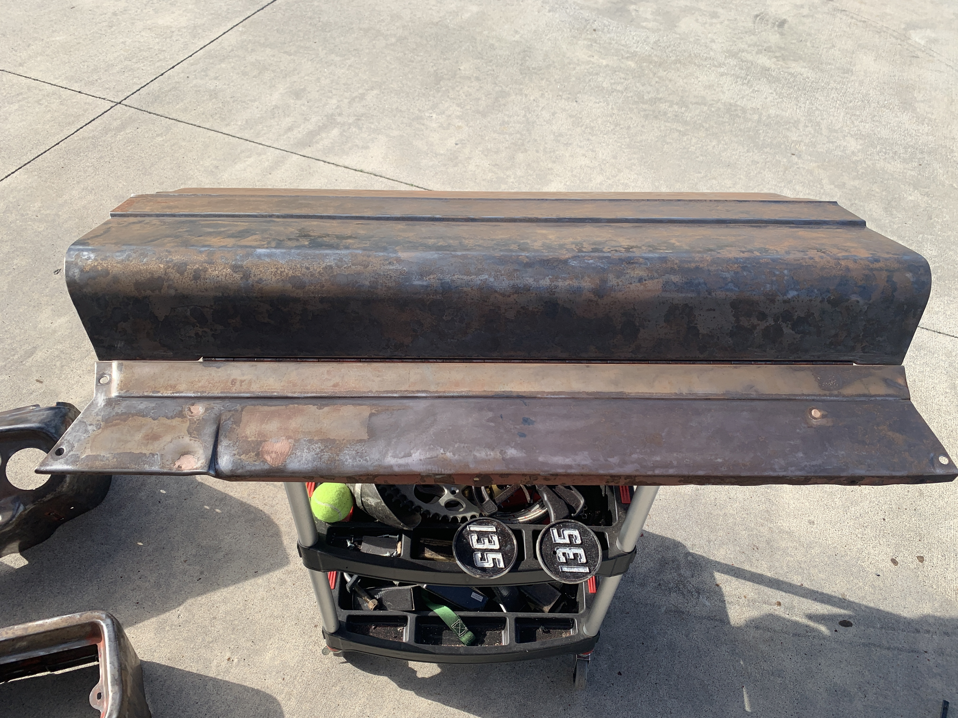

Started degreasing and cleaning with the pressure washer. Then started pulling things apart, starting with the sheet metal. A 4” grinder with knotted wire wheel made some quick work of paint removal.
/ My 135 Journey #3
It looks like your 135 is going to look factory fresh once you're done. Keep us in photos as you make progress. While the metal is off, you might want to check valve lash on the Perky.
/ My 135 Journey
Well as factory fresh as a first time paint job shot in the driveway with a HF gun will allow. Lol The tough part is going to be prepping everything else. I don’t care to spend weeks scraping and cleaning the entire chassis.
I will look into the valve lash as suggested while it is apart. I also think the trans is topped off with water. Drove it around the yard a bit and had water all over the top of the case afterward when I stopped so I assumed it is pushing out somewhere. The tractor sat outside so water may have entered around the shifters.

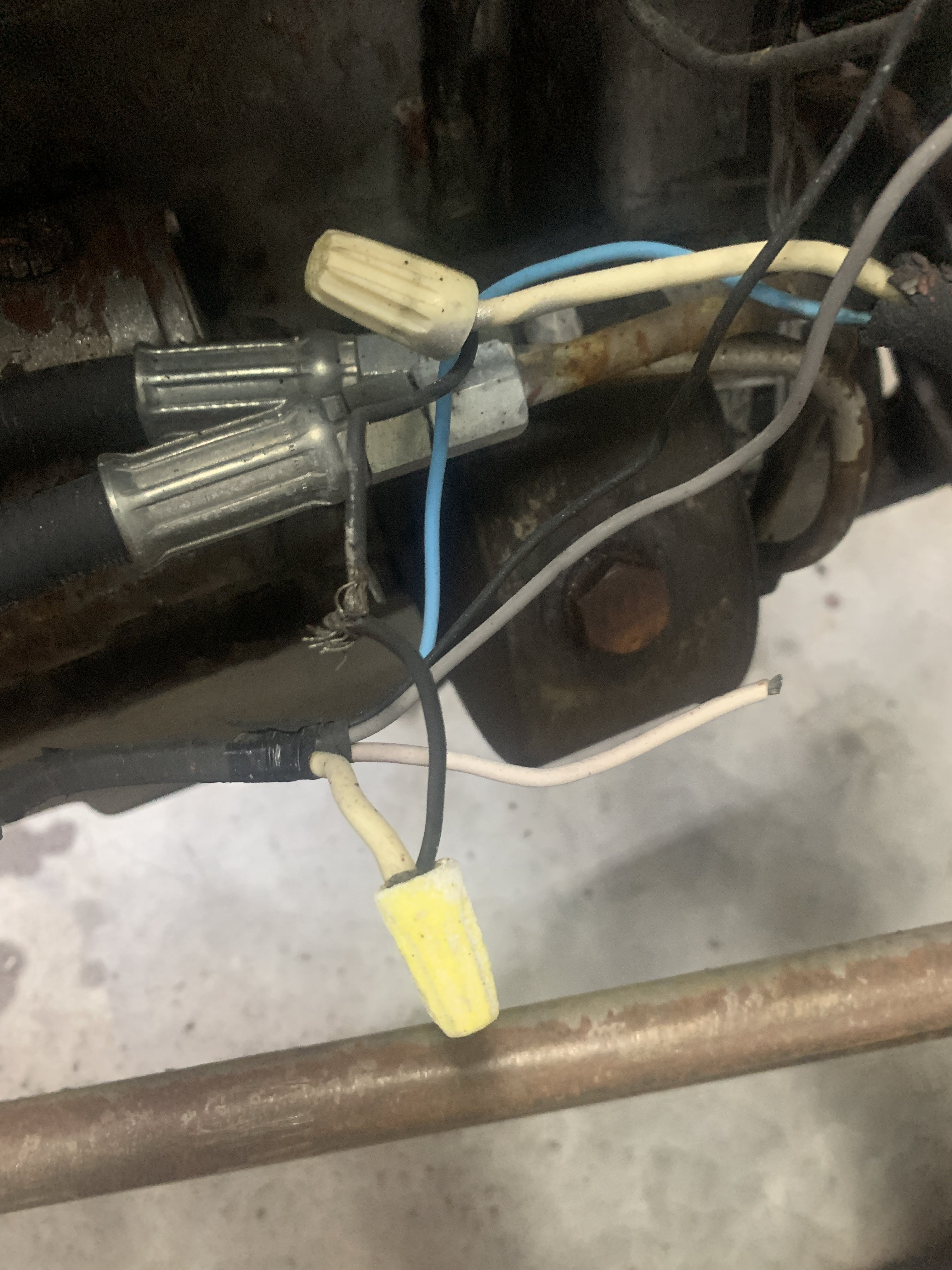

I will take a butt connector and electrical tape over this mess any day. I am searching for the logic in using a couple of wire nuts and some smaller gauge wire to make this connection to the alternator. Oh, and lets just twist that wire together finger tight in the center...
The gas gauge doesn't work....likely because the single wire running from the sending unit is cut and draping down the side of the tank.
I've got to find a wiring diagram and chase all of this down.

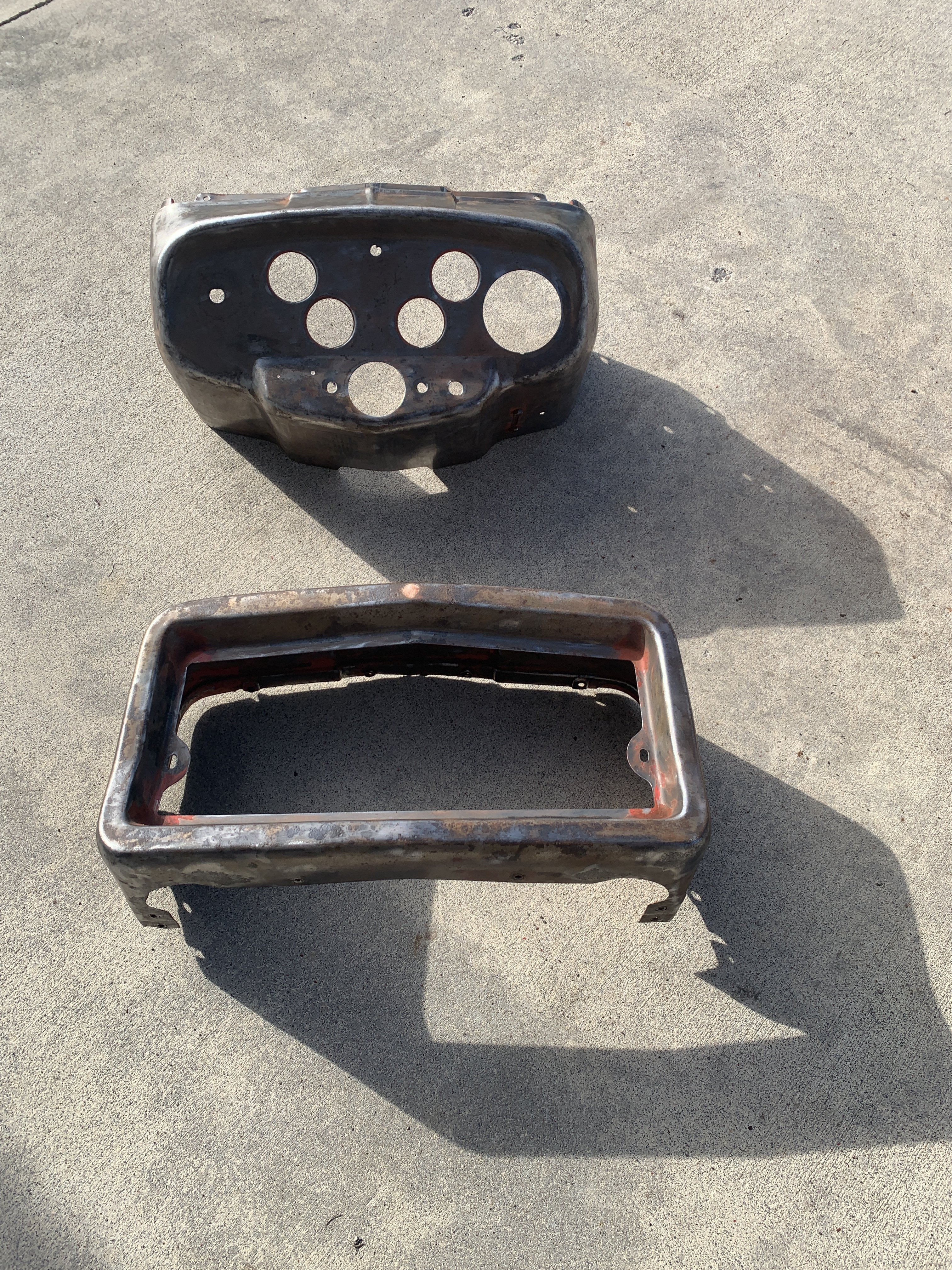

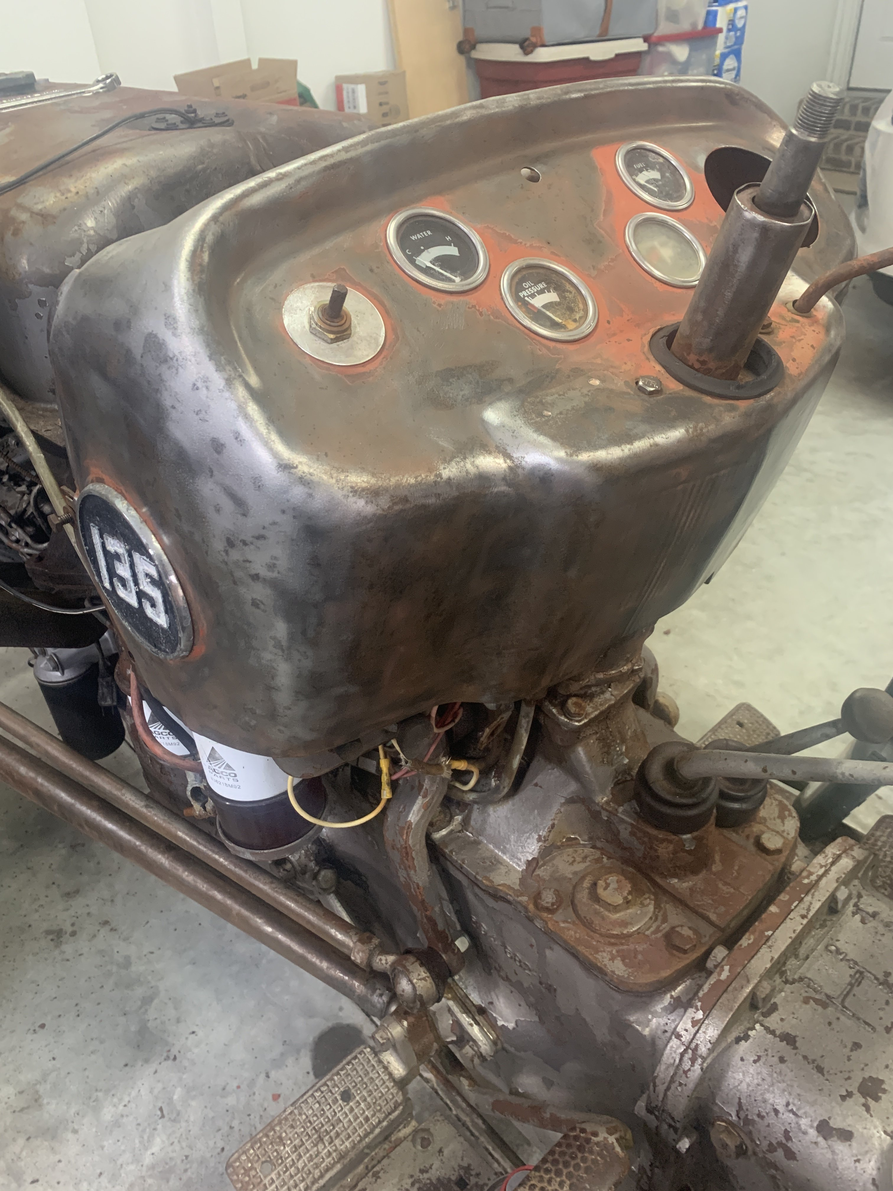

Disassembly and cleaning continued today with the removal of the gauges and dash. The rust on the hood was a little tougher to remove and I may end up taking it somewhere to be blasted. Once I get a few more things removed, I’ll roll it out for several rounds of Purple Power, oven cleaner, and finally a phosphoric acid rust converter.
Anyone have any experience with those $40 gauge sets on eBay? I have read they can be inaccurate but how far off can they be?

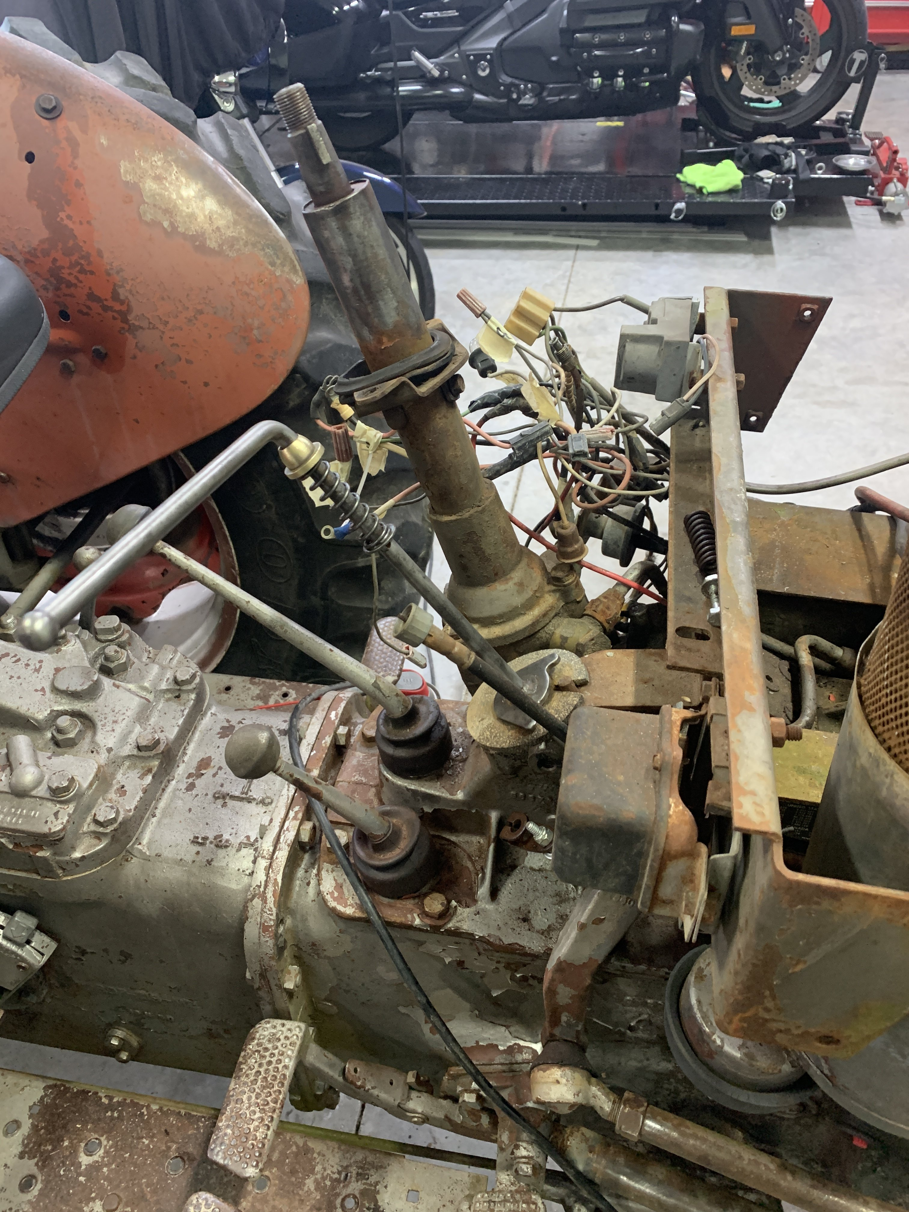

I see you apparently got your steering wheel off without much fuss. Mine nut is rusted and my impact turned it into rust powder when i attempted to remove it. Also, I have learned from your photo that my steering shaft is likely not tapered. Once the old wheel is removed, it will be replaced with a Nardi wood wheel. Also, I believe I am going to have to remove my Cav pump and install a new front o-ring seal. My oil level is creeping up and I suspect it is diesel fuel slowly leaking into the engine sump....but, enough of my stuff...keep the progress coming.
The steering wheel was not an issue for me. The nut and washer were missing. I actually shot it with some PB Blaster and pulled it off by hand the next morning.

It honestly is amazing to think this machine is 55 years old and still solid. I was told it sat outside in the weather most of its life with a cup over the exhaust. While there is some rust and pitting of the hood and other parts of the sheet metal, nothing is rusted through like I expected.
I hit the chassis/engine with some oven cleaner today, followed by a heavy degreaser bath and a thorough rinsing. I spot primed all of the bare spots I could see and any other bits with rust with some Rustoleum primer. I found a gallon of Rustoleum Farm & Implement Massey Ferguson Gray and may find the time to spray the chassis this weekend.
I’m not going to worry about runs, drips, or errors on this one. It is destined for field work and just needs a new coat for protection only. It will certainly look better than it did and should hold up longer being stored out of the direct elements.

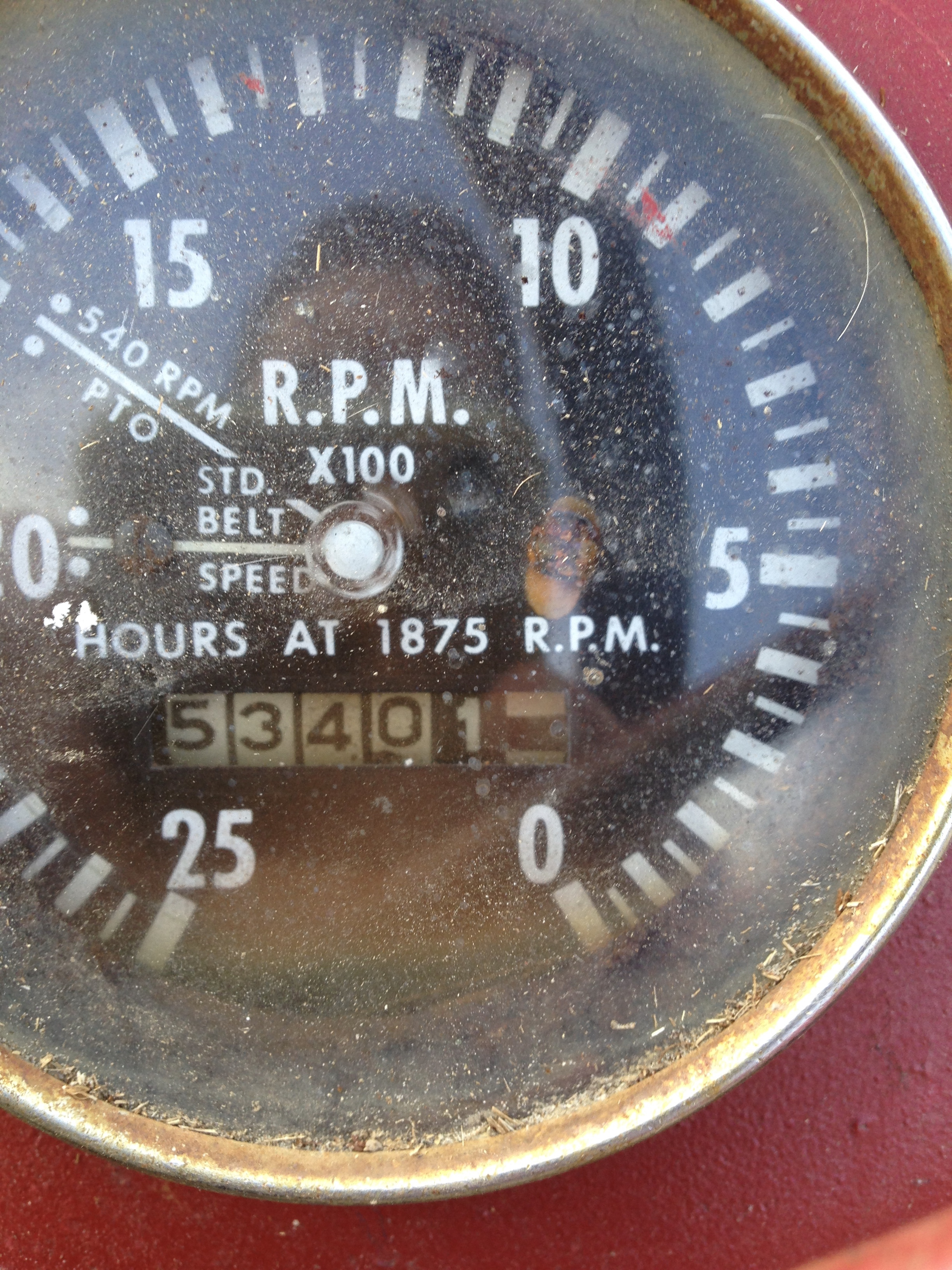

A coat of paint goes such a long way. You'll be even prouder of her. If you find a good reproduction of the original tachometer please let me know. My needle is gone. Note it's counterclockwise.
/ My 135 Journey
#19
I am looking at replacing all of the gauges and switches. My tach was disconnected and full of rusty water, others full of condensation, headlight switch rusted up, etc.. I have located some aftermarket units at yesterdays tractor but not an original reproduction of the tach. I will keep an eye out in my searches. I couuld potentially send you mine if you think you could salvage the needle.
