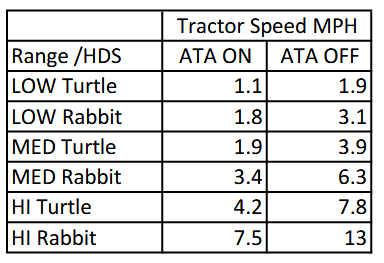

Then as time went on there were increases in size, features, horses and comfort. After a couple years of a manual 3-speed there were hydro with two speed ranges, then three, then HST+. The HST+ is handy for mowing with the Auto Throttle Advance off and toggling between the H&L lever on the steering column. It's also nice to be able to drop it down a partial range when encountering a hill, or when pulling out from a stop with the trans in HI and the lever in LO. After it starts rolling the lever can be bumped into HI.
The escalation in tractors was born of the desire to do more and/or do it more comfortably. I have said before that any previous tractor could still be the only tractor. Some features are very useful - telescoping lift arms, loader, hydro trans, power steering, HST+, and at 76 I really appreciate a cab with heat and A/C.
Just a note for anyone interested, below is a speed chart that compares the speed in MPH at a given RPM (I believe it was around 2,000RPM). It is NOT TOP SPEED for the tractor. Hi-Rabbit at full throttle is around 17-18MPH.

That's interesting info on the HST+ ATA.
The HST+ is an amazing transmission, but not much has been written about it.
It's not offered on all Kubota models, and I don't think any other manufacturers have a similar tranny.
Does anyone have a list of which Kubota models came with the HST+tranny? or optional?
