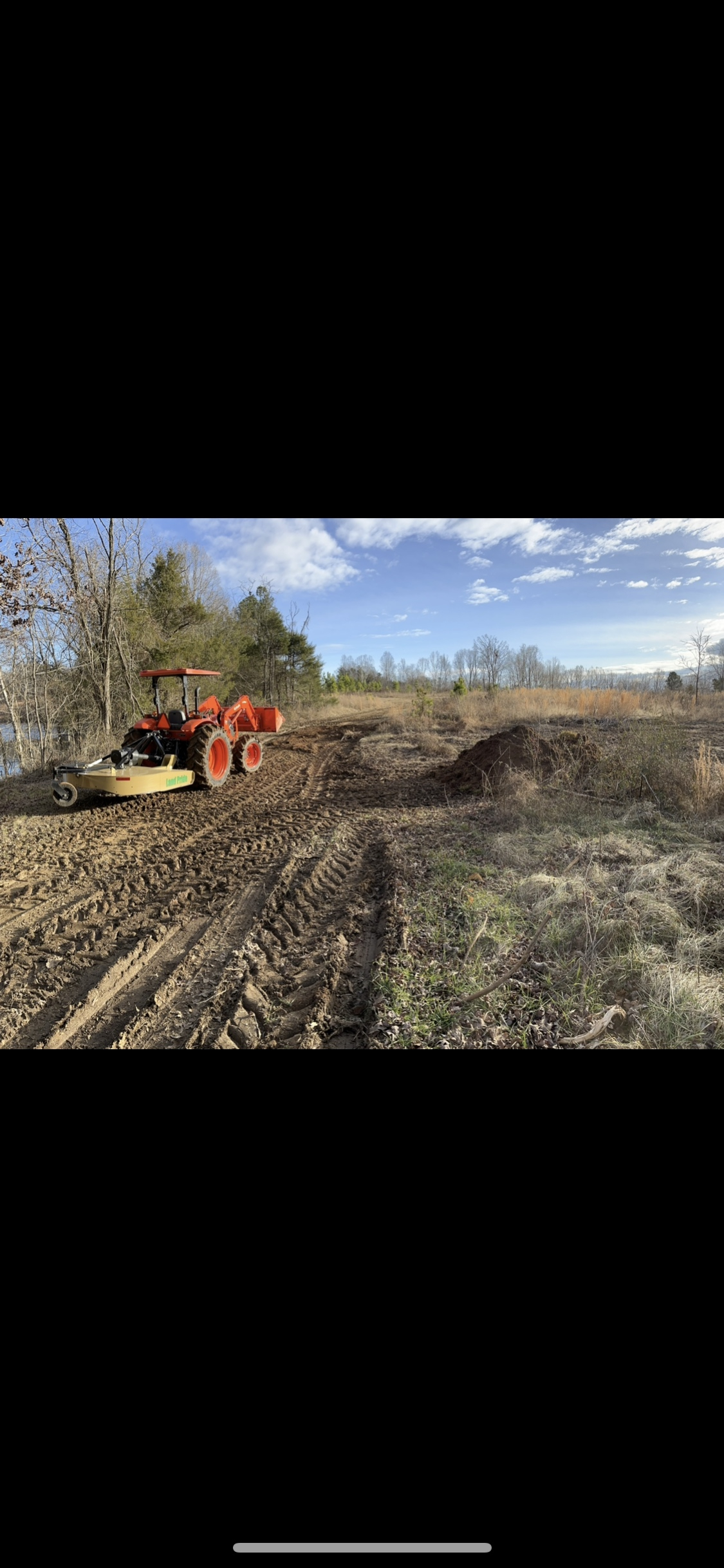

So why are you looking at the Grand and MX vs the M series? I just purchased a M7060 with 12 speed tranny for under 50K. Way more tractor than the MX series from what I remember anyways. I absolutely love it. Moving dirt today and have 10 hours on her now.
