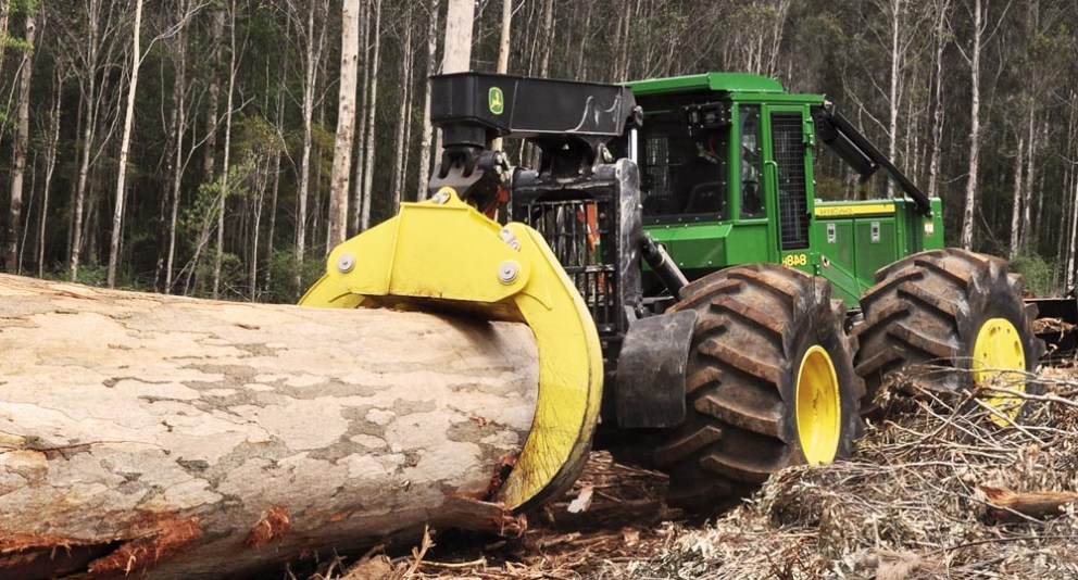

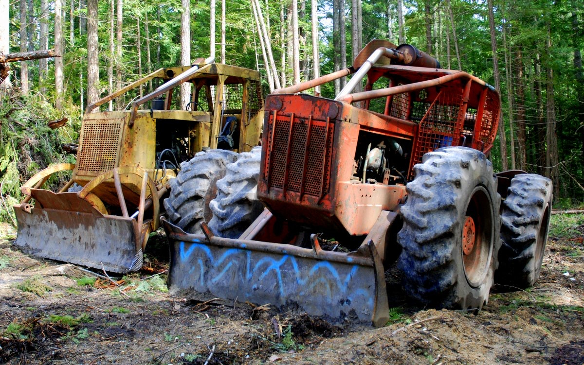

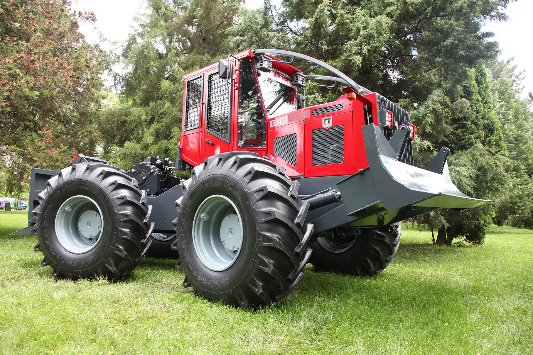

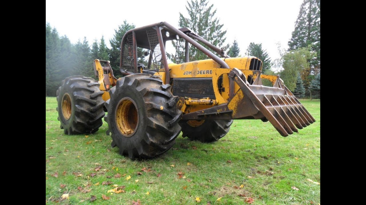

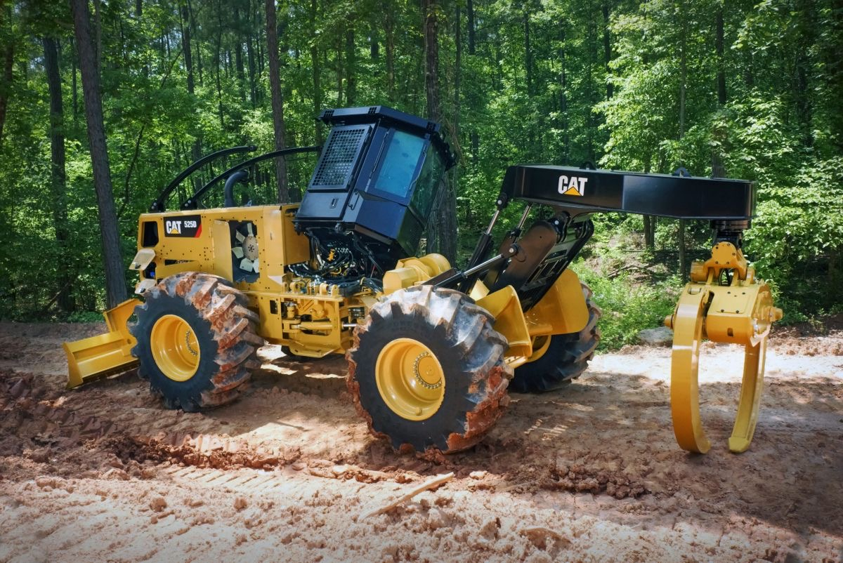

Every logger I have seen with a rubber tired skidder runs R4s. They are not just for payment. Loggers run them because woods work is tough with rocks and staubs everywhere.
/ MX series tires #30
Took me all of 30 seconds to upload these. Google “logging skidders” and all you see is R-1’s on them. All I see out here are R-1s.
Besides, this is a tractor forum, not a logging skidder forum ;)
Another nice thing about R-1s is it lessens the need for chains.
/ MX series tires #31
You said they were for payme
You said R4s were for pavement. I guess log skidders are different in the Rocky Mountains than in your country. We have lots of rocks in the woods. But those skidder tires have thick sidewalls and are wide like R4s, not like ag tractor R1s. Most skidders do run chains.

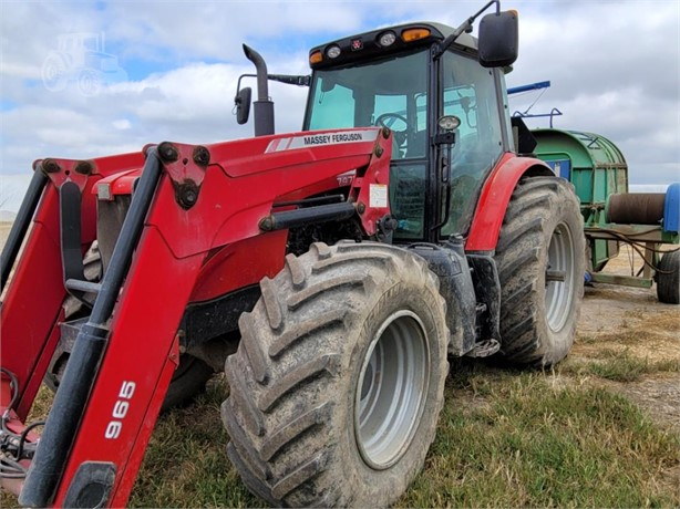

It would be nice if there were an option to choose those wide radial R1s like Hay Duke talks about. I think they would be less damaging to the ground, but the only R1 options for new tractors are those narrow wheel R1s that are good at cutting trenches.

Here’s some optional Michelin flotation rubber for ya
