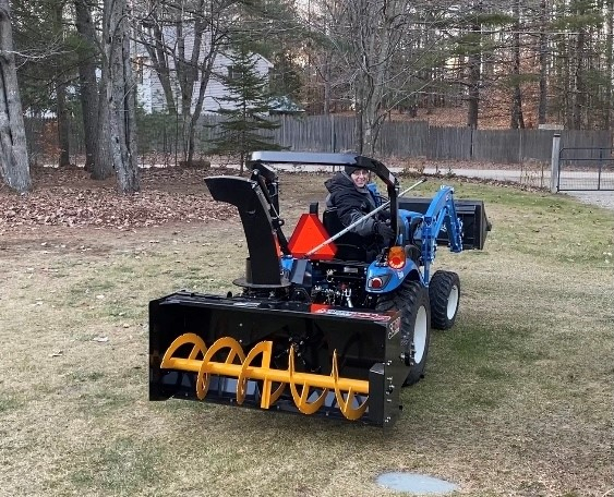

What rear most blower did u get....Model and pic please.
/ MT225S cold start question
#29
I ended up going with a Woodmax SB-60 blower. I looked at a couple of others but pickings were pretty slim in December. It weighs nearly 700 pounds so no traction issues, ever
