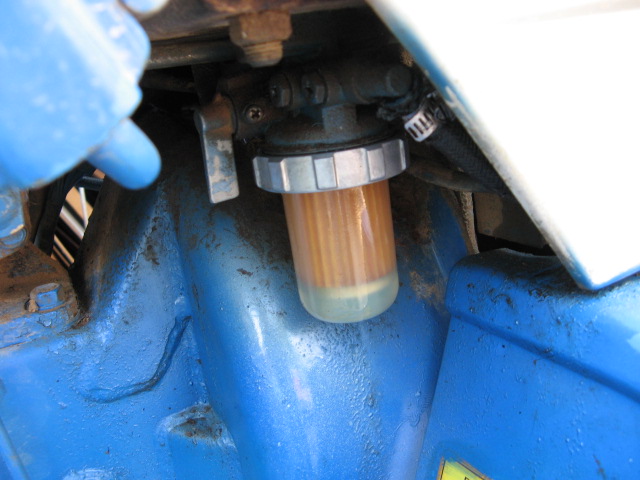

As noted before, the tractor was missing the fuel filter bowl, bowl lock ring, O-ring seal and element, and the filter housing had been by-passed with a piece of steel tubing. I initially figured that someone had simply lost the bowl, but lately I have had a nagging feeling that maybe something else was going on with the filter. And there was. No fuel would flow through it.
The filter has a shut-off valve integral with the housing. Although the valve handle turns back and forth, the handle had broken loose from the valve barrel. Found that I could open the fuel valve by removing the handle and turning the barrel with a large regular screwdriver. If I can buy just the "innards" of the valve I will fix it; otherwise, I will live with it as-is, because in order to remove the filter housing the fuel tank has to be removed, and I am not going to go that deep into this machine at this time.
Anyway, drained the tank and installed the element & bowl, bleed the fuel lines & ran the engine for about 20 minutes to insure there were no issues.

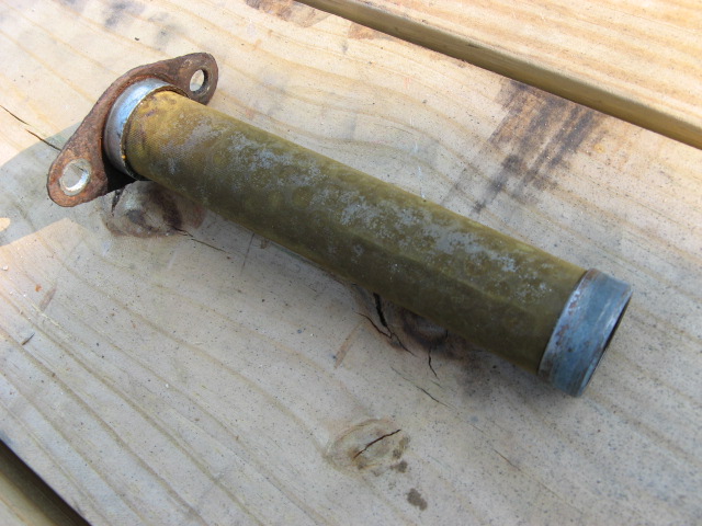

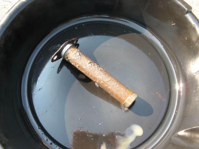

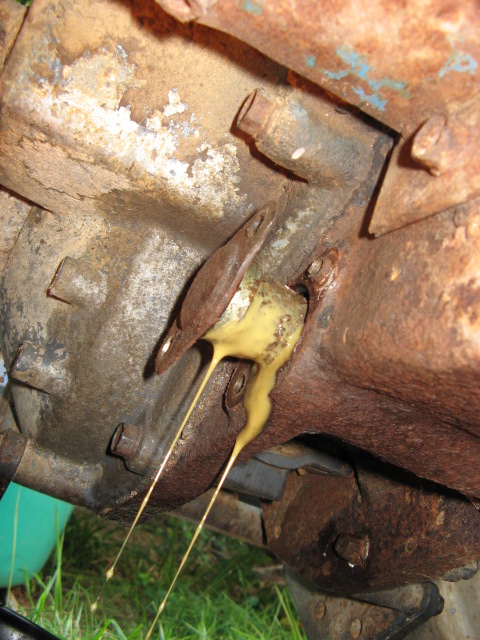

Next i drained the hydraulic/trans oil (common sump) and removed the strainer that had casued me so much grief:
Note that someone had mistakenly filled the sump with a chocolate milkshake instead of the recommended fluid.
The hydr. strainer was a bit cruddy:
...but it cleaned-up nicely, and got a new O-ring seal:

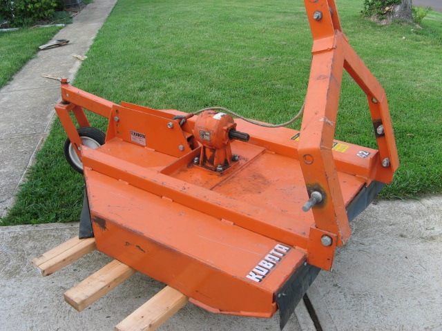

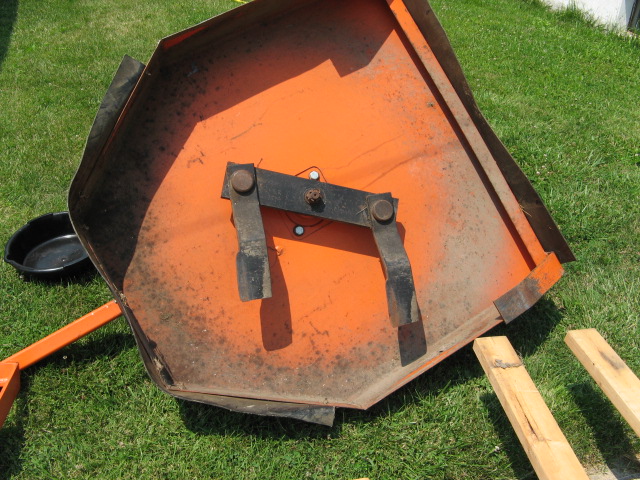

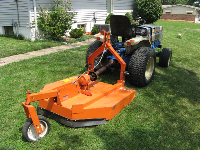

Also want to change the gear oil in the rotary cutter:
The gearbox on the cutter has a plug on top for filling, and a plug on the side for checking the oil level, but I cannot find a plug on the bottom, either above or below the deck, for draining. But the nice thing about little 42 inch cutters is that it is not big deal to just remove the "check level" plug and turn the thing up on its side to drain the oil, and that is what i will do.

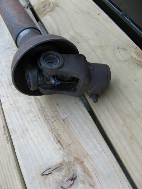

Also need to work on the PTO shaft, as there is no shear bolt. Both ends of the shaft use quick couplers, and the input shaft for the cutter gearbox is splined and grooved exactly like the PTO output shaft on the tractor. I will need to buy a universal joint yoke fitted with a shear bolt and install it on the driveshaft. About another $100.00 that I would rather not spend. I can't believe someone was running the thing without a shear bolt, but then I don't think the cutter has been used very much.

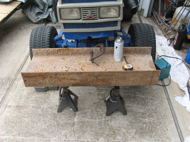

Also need to work on the new front bumper:

I had a similar issue with my fuel valve. I ordered a replacement handle from Valley Power. How did you get that bolt out of the strainer? As you probably know the oil had water in it. Good thing you were able to get that out.

Slip clutch on the PTO maybe instead of redoing your shaft?
It's one thing to bypass your filter to test the problem... and it's another to leave it that way. I removed the factory filter assy on my Beaver and repalced it with a generic, largely because I didn't want to wait for one ordered while I tried to work out other problems.
Before I tried tipping my mower deck on its side to drain fluid out of, I'd seek out a suction pump and draw it out that way instead.
Well, I flipped her on the side and drained the cutter gearbox oil yesterday- oil looked good. Only issue was getting the thing back onto the little 4-wheel dolly I was using to roll it around. Had to jack it up onto jackstands. Still need to replace the oil in the front axle, but I'm out of containers for holding used oil.
Adding a slip clutch would be a good option, but would cost more than replacing one yoke on the shaft with a shear bolt yoke. This PTO shaft seems to me to be a lot heavier-duty than it needs to be. The bearing caps are 1 1/4 inch diameter.
Ending up drilling the bolt. Had to cut-away part of the running board that extended into the rear fender well and was blocking straight-in access to the bolt. The same running board extends into the engine compartment and makes getting a filter wrench on the oil filter difficult. I just bent it out of the way there.
If I can get the parts for the valve, I will probably fix it. But I'm not going to replace the whole filter body- besides probably being expensive, I think the fuel tank needs to come out first.
Drained the old fuel out of the fuel tank and ran a small bit of fresh fuel through it as well, but did not flush as much as i would have liked as I am about at the limits of my slop oil capacity at the moment.

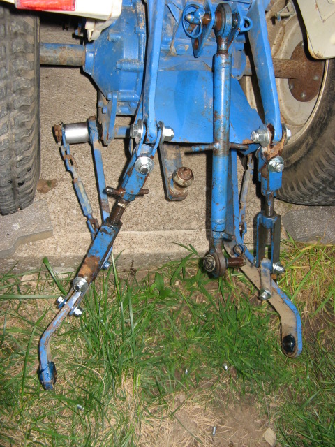

i try to do something on the tractor every day; Monday night i attacked the adjustable downlinks (turnbuckles). Both were rusted immoble. After a session of oiling and greasing and a lot of threading back & forth with a box-end wrench on the "ears" I have one which can be run up and down it's threads with the fingers. The toplink had much less serious issues but got that straightened out as well. Tuesday night's project will be the other downlink.

Tuesday night: freed-up the other downlink. Was rusted up pretty bad. I hope that i have not damaged the downlinks as i had to wrench on both of them pretty bad to free them up.
My set-up is exactly as shown on this photo from Valley Power:
Satoh Parts
Except that if the downlinks are installed correctly in the photo, mine were installed upside down.
Each downlink has (4) pins holding all the pieces together. I was missing (2) pins which had been replaced by big rusty bolts. The remaining pins were locked in place with old nails and so forth. Rather thatn buy (2) new pins and all new cotter keys, I elected to just replace everything with new bolts. I figured that would be a bit cheaper, but it wasn't. I selected extra-long bolts so that the nuts would bottom on the threads, and there would be no threads in the load-bearing areas of the bolts (the extra length to be cut-off once everything is tightened-up.) I also placed washers under the heads and nuts, and used nylon locking nuts.
The geometry of this hitch seems a little different. From what i have seen most downlinks are usually vertical & parrallel. The downlinks on this hitch actually splay outward. In other words, the tops are closer together than the bottoms. That is why there are so many links/pieces to the set-up- to allow for this. With a sideways force on the downlinks i was concerned about the the pins being held in place by mere cotter pins/cotter keys. One of the clevis pieces, a flat bar weldment, was already a bit "spread" and if it were to spread a bit more i doubt a cotter key would have kept the pin in place. The bolts and nuts will certainly stay in place.

"With a sideways force on the downlinks i was concerned about the the pins being held in place by mere cotter pins/cotter keys."
I well know that problem. Once snow blowing 1 mile down the road one of those pins fell off and got blown away.
Fortunately I had something in the toolbox to temporarily replace the pin. Since then I always carry a spare for every occasion.
An other thing that needs a safety is the 3-point turnbuckle barrels. I lost one somewhere in the snow and an original part was so pricy that I simply purchased a complete pair of generic adjusters for a fraction of the price. Mine are always now safety-ed with wire.

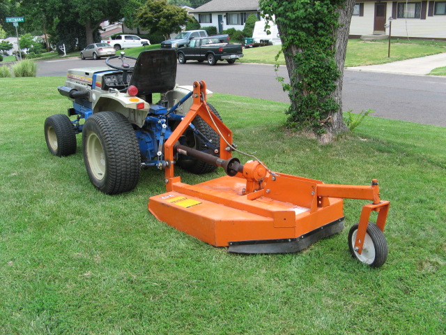

Got a lttle bit more done on the tractor today. Tightened-up all of the bolts that i had installed finger-tight in the 3 point linkages yesterday, and cut off the excess of each. Also tried to pack some grease into those ball joint thingies that take the pins of the impements. I use boat trailer wheel bearing grease on everything, so hopefully some of it will stay in place when it rains. Those balls hadn't seen grease in a long time. Also shot some oil into the holes that the newly-installed bolts are in.
I had mentioned many posts back that there were a couple of "spacers" missing, where the lower arms attach to a steel rod running crosswise under the differential. I cut a couple of 2 inch long sections of steel pipe and installed them in place of the missing spacers. You can see the left one in the photo below- I hit it with some silver spray paint so it would stand out from the rest of the rusty steel.
This is what the underside of the cutter looks like. Not too bad considering that this thing is at least 20 years old, and maybe closer to 30.
