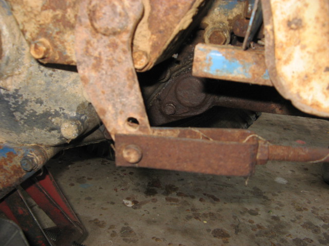

Now I'm going to have to go look at one of mine but I think you can take the right rear tire off to gain access to that bolt. One possible solution is to weld a larger nut to the head of the bolt. The heat from the weld will also help free the bolt. A buddy of mine over in Fulton could get that thing out for sure.
With the tire off, and a very very long bit, I can probably drill it out, but there's no room to swing a hammer for a center punch, and without center-punching the thing, I doubt I could keep a long bit centered on it, and i certainly don't want to "waller-out" that hole.
I have considered welding a piece of steel to the head and trying to turn it, but i figured I would probably just twist off the head.
I just may have to drop it off at a shop and have them remove the bolt, and re-thread if necessary. There just isn't much room to deal with the thing. The lower bolt would be much easier to deal with.
I may just change the fluid and run it as-is. The lift appears to operate fine, but I have yet to try it under a load.

That would probably do it. I have some time before the fuel filter items arrive, and i don't want to run the thing anymore without a filter, so that gives me some time to mull this stuck-bolt issue over. Might put the tractor up on jackstands in the garage over the weekend and see just what i can do. I really hate to 'button it up" without cleaning that strainer, as i know it hasn't been cleaned for years, if ever.

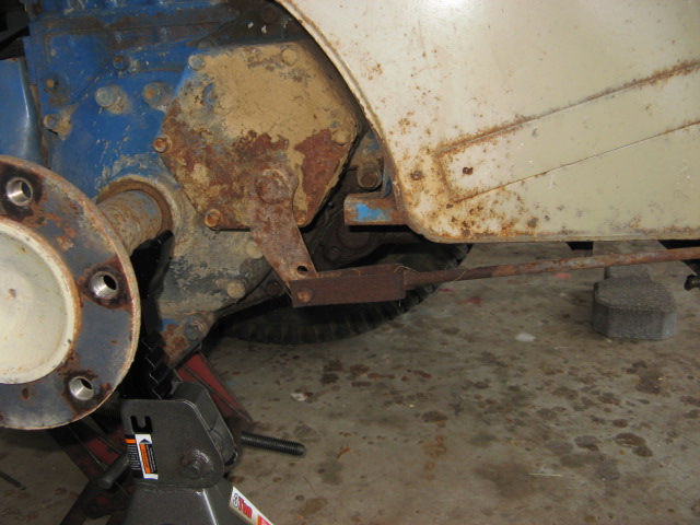

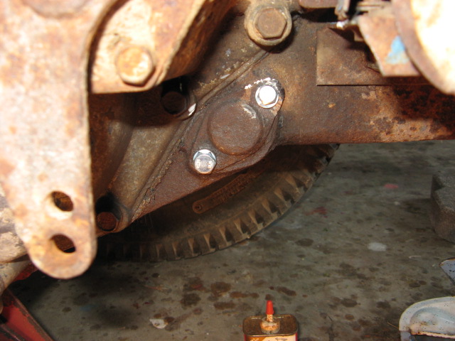

Backed the tractor into the garage, put it up on jackstands & removed the right rear wheel:
Photos shows the lower of the (2) bolts that secures the hydr. screen/filter:
Upper bolt is covered by rear of running board:

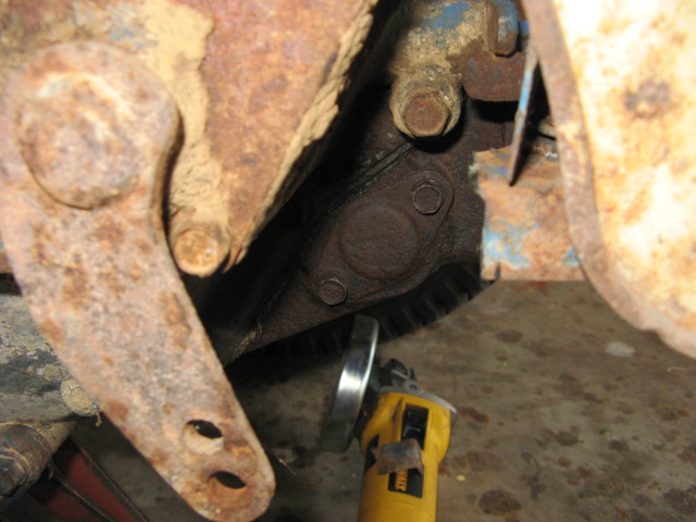

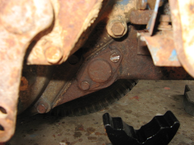

Cutting-away the rear of the running board with a cut-off wheel on 4 inch grinder. Note piece of running board on handle of grinder:
Ground a slot in the mangled head of the bolt, and then used an impact tool (hammer kind, not air) with an extension to try to back out the bolt. Did not work. Top of jackstand visible was used as a rest to steady the grinder while cutting the slot

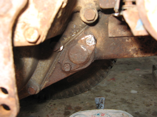

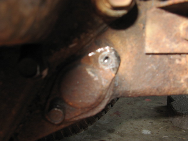

I then cut/ground the head of the bolt completely off, ground it flush with the flange of the filter and then center punched with a 6 inch long punch:
Began drilling out the bolt. I believe it is an 8 mm bolt, so I drilled with increasingly larger bits until just under 1/4 inch, which left a little of the bolt still in place:

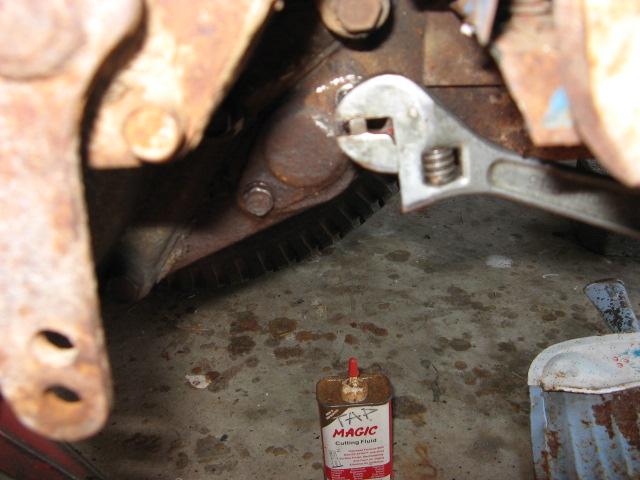

Started tapping threads with a 1/4 & 20 tap. Not enough room for a tap wrench, so used a small adjustable wrench. I had already removed the other bolt and measured the length, as these are blind holes, so i knew how deep to drill and tap:
STUPID STUPID STUPID. Did not clean out the chips enough and broke-off the tap. But upon measuring the depth of the hole I decided that i had enough usable depth. Off to the hardware store to get a new 8 MM bolt and lock washer for the lower hole, and a 1/4 bolt and 8 MM lock washer for the upper hole (since I left a bit of the old bolt in place, the over size lock washer allows the bolt head to tighten down on the filter flange rather than on the remains of the old bolt)
New bolts in place:
I have not yet tried to remove the filter. I still need to get the hydraulic oil and also a new gasket for the filter. Hope to deal with the fluid & filter later this week.

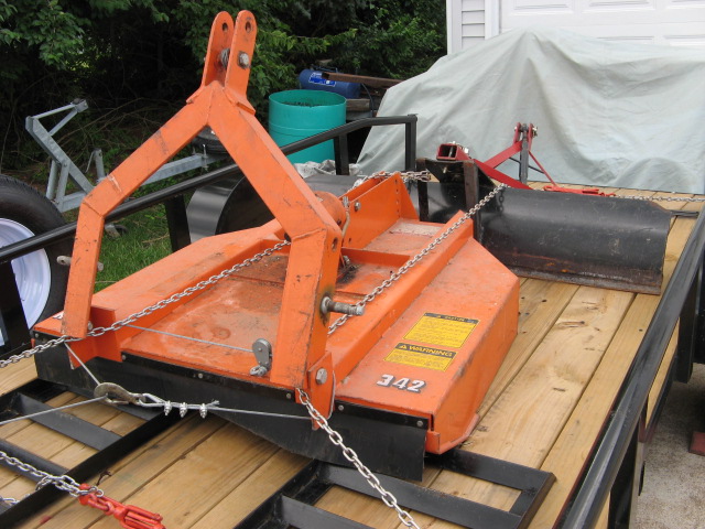

When using a rotary cutter, should I have "limit chains" that control how far the front of the cutter drops, and should the position control lever be placed in the full-down position so that there is no vertical load on the 3 point hitch? Or, should I set the level with the position control, and allow the hydraulics to maintain the level of the front of the cutter? The chains sound like a better idea to me, but I have never operated one of these things.
Hope to go look at a used rotary cutter this evening, assuming it is not already sold.

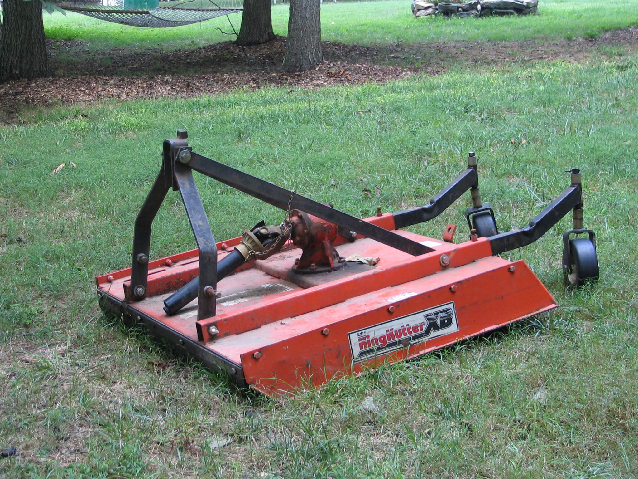

#52
Kubota model B342 rotary cutter $500.00
Worksaver brand 5 foot (very) light-duty angle blade with issues $125.00
The blade came with the top link from the tractor (16hp Bolens), which the former owner had already sold.
No "stump jumper"
Was very surprised to find a 42" cutter. I think this is the only one i have seen for sale within a couple hundred miles in the few months I have been looking. I was thinking i would have to go with a 4 footer, which are not real easy to find around here either. 5 and 6 footers are a "dime a dozen."
/ MT160D #53
From the pictures it looks to be in good condition. What are the issues? You can probably buy a stump jumper.
/ MT160D

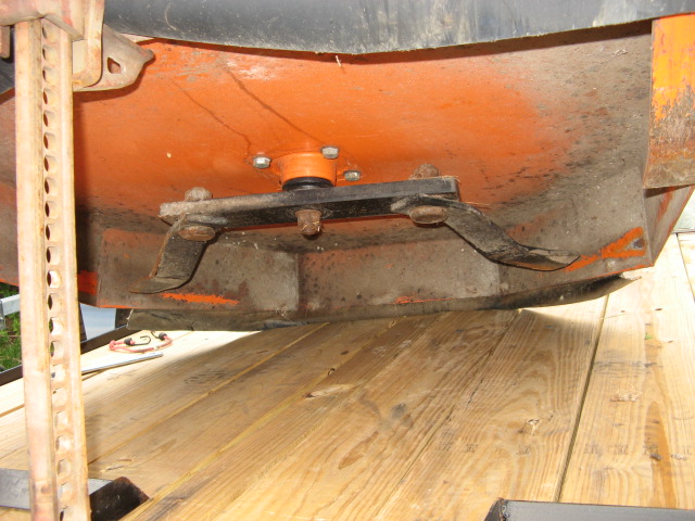

#54
No issues (known) with the cutter. Someone did reposition the pins for the lower links. PTO shaft & tailwheel are in my truck.
The blade is just built too light. The "swivel plate" (steel plate welded to top of blade) is only 1/4 inch and is distorted. With the blade on the ground, the tractor could move forward or backward a couple of inches without the blade edge moving across the ground: it would just tilt forward or back.
I will weld some extra steel on it, and maybe cut it down to a 4 footer. It was advertised as a 4 footer anyway.
Cost $30.00 in gas to pick these up. If I kept looking for cheaper/better, I might have to make several more $30.00 trips, in addition to adding a lot of miles to the truck. And i don't know if I would ever run across another 42" cutter. With ag tires, the 42" is about as wide as the tires on the MT160D. With the turf tires on mine, the cutter will be "inboard" about 2 or so inches on each side. Not a problem for me, and I need to keep the weight of the whole package down to avoid overloading the trailer & truck.
/ MT160D #55
I think you did OK. The blade is supposed to be able to swivel.
/ MT160D
#57
If you look at the rear of the blade in the top photo, you can see two supports (angles) running from the rear of the swivel plate to down near the bottom of the blade, and you can see that the plate itself is bent down inbetween the two supports.
I have the blade apart, and will beat the plate back (more or less) straight, and then add a third support angle. Also, the pin that locks the blade from swiveling on its own is too small, and is bent. Will probably drill the holes out larger and use a larger diameter pin.
This blade is probably built strong-enough for a 4 footer, but is way too lightly built for 5 feet. But, it wasn't too expensive, and it was sitting right next to the cutter and saved me at least one more road trip to get the implements I need.
