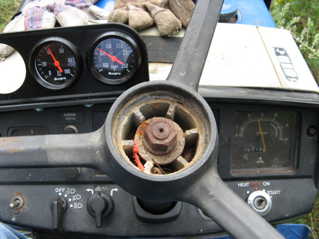

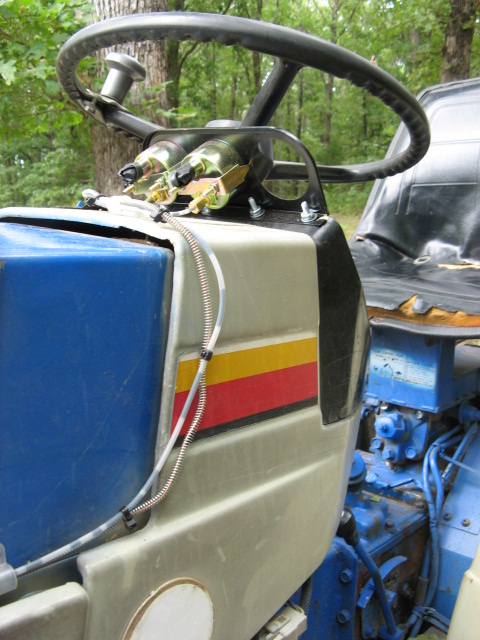

Saturday I found time to install water temp. and oil pressure gauges on the Mitsubishi tractor:
"Hot rodders" would not call this a "sanitary" installation.
Considered trying to keep the warning lights but decided to simplify things and installed the senders in the "idiot" light sender locations
Also have a voltage gauge but did not have the time to deal with it. Also, did not and probably will not install the gauge lights. Taped up the openings for the lights to try to keep dust out of the gauges.

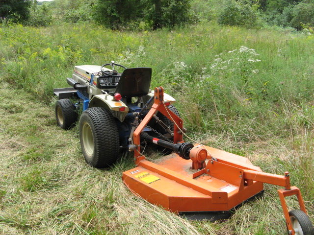

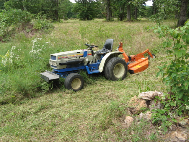

Sunday I went brush hogging:

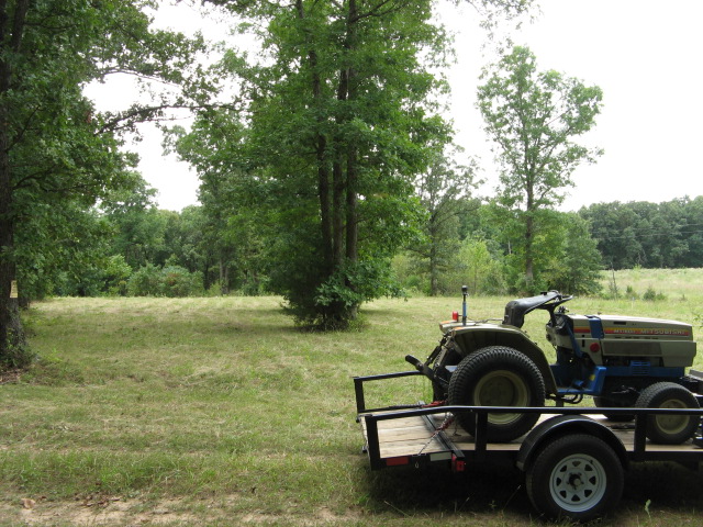

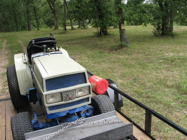

I off-loaded in a ravine- did not even have to use the ramps.
Cutting 10-months of growth:
Highest temp I saw was about 170 degrees; lowest oil pressure was about 43 lbs or so, with a hot engine @ idle:
For some reason the engine will not idle down to below about 1250 when hot, whereas it should idle down to 900, which it will do when cold.
Used the differential lock a lot. The pedal is pretty rusted and won't release- have to reach down and pull it up, but not a big hassle. Used 4WD a few times just to get out of holes, but could have easily gotten by without it. Didn't really even need the diff. lock, but if you have a toy you play with it.
Used #1/ high most of the time (3 speed with high/low). In some really thick areas had to drop down to #3/ low. Got pretty good at shifting back and forth fast enough so that the cutter would not spool-down. By the way, I don't know how it is supposed to be done, but in starting from a dead stop I would go to neutral, engage the PTO, engage the clutch and hit the foot throttle to "spool-up" the cutter, then disengage the clutch, shift into gear, engage the clutch and advance the hand throtttle to get proper PTO rpm's. Thought that would be easier on the machine than to try to start the cutter and the tractor moving all at once.
There is too much of a ratio difference between #3/low and #1/high; manual says about 1.8 mph vs about 3.1 mph.
Didn't get it all cut, but got a lot done:
Need to look into the idle rpm issue, and the valves are noisy.

It was a pretty simple job, since I obviously did not care what the installation looked like.
The oil hole threads would have caused me issues, but Oliver28472 had already posted the part number of the correct adapter.
I was worried about hooking up the oil pressure gauge- I was afraid that I would see something i did not want to see, like real low pressure. I get about 43 lbs @ a real fast idle of about 1250, so I'm guessing I will have about 38 to 40 @ the 900 it should idle at. Get about 60 to 65 @ about 2500, which is PTO speed. Not real great but could be a lot worse.
/ MT160D #126
It's an older tractor with a dubious maintenance history. I'd say the oil pressure is pretty darn good. That gauge set looks to be around $30 or so, not a bad investment.

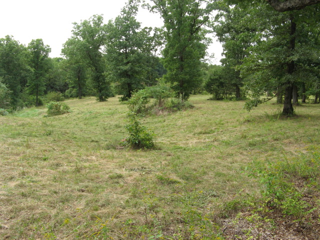

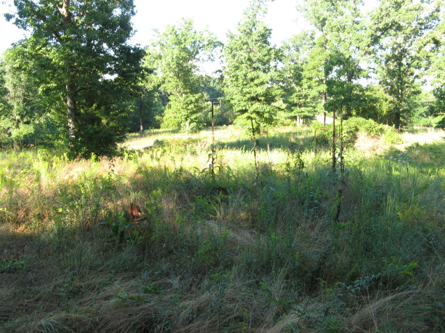

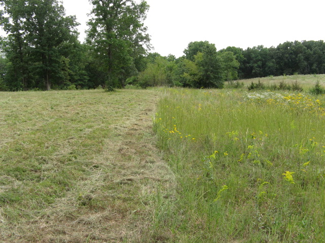

Was looking to see if I had "before" & "after" photos. These two, while not exactly aligned, show pretty-much the same area:

That gage installation looks good. I have been contemplating something similar. It kind of slid down the to do list, and I find gages often ludicrously expensive for what they are.

techwrtr2 hit the gauge price on the nose: 30 bucks on Amazon, plus about 8 bucks for the oil sender adapter.

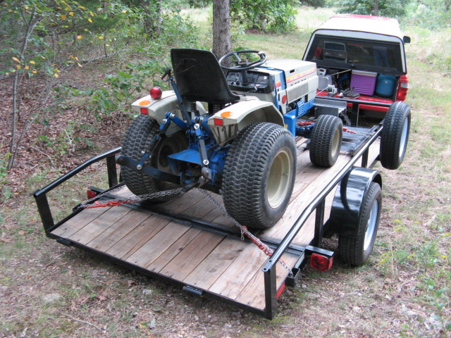

Trailering is a hassle, and I have seriously considered a shipping container for storage, but another issue is maint. & repairs, which I can do at home when I have a little free time. If the tractor is 200 miles away, then I have to devote some of the limited amount of time I can spend "on site" to working *on* the tractor, and not working *the* tractor.

Those bushes it looks like you mowed around center of picture, they aren't bush honeysuckle are they?
I wouldn't know how to identify them.
But what that is, is a big pile of half-burned logs/debris from the bulldozing a decade ago.
I have several such debris piles, and have been slowing dismantling them, as well as slowing picking up and piling the rocks.
That smaller growth in lower center is a rock pile.
Yea, I know how to have a good time.

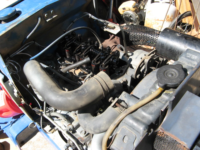

Stayed at home this weekend. Mowed about 1.5 to 2 acres for the non-profit, but used the old Sears garden tractor.

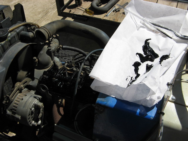

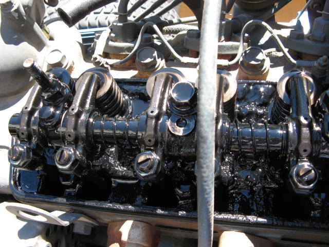

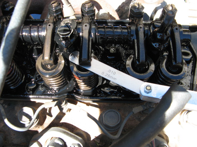

Decided to check valve lash on the Mitsubishi- it sounded a bit clattery.
Valve cover off;
Really really sludgy:
Clearances were not bad all all. Tightened-up two, loosened two, and left two alone:
Tried to clean out some of the sludge laying on the head:
The drawbar only has two of its four bolts; pulled one bolt and took it to the hardware store to match-up, but
this bolt is something different. I'ts not metric fine thread or coarse thrread. It's close to 1/2 by 20, but it's not 1/2 by 20.
I will need to stop by a fastener store to try to match the thing.
