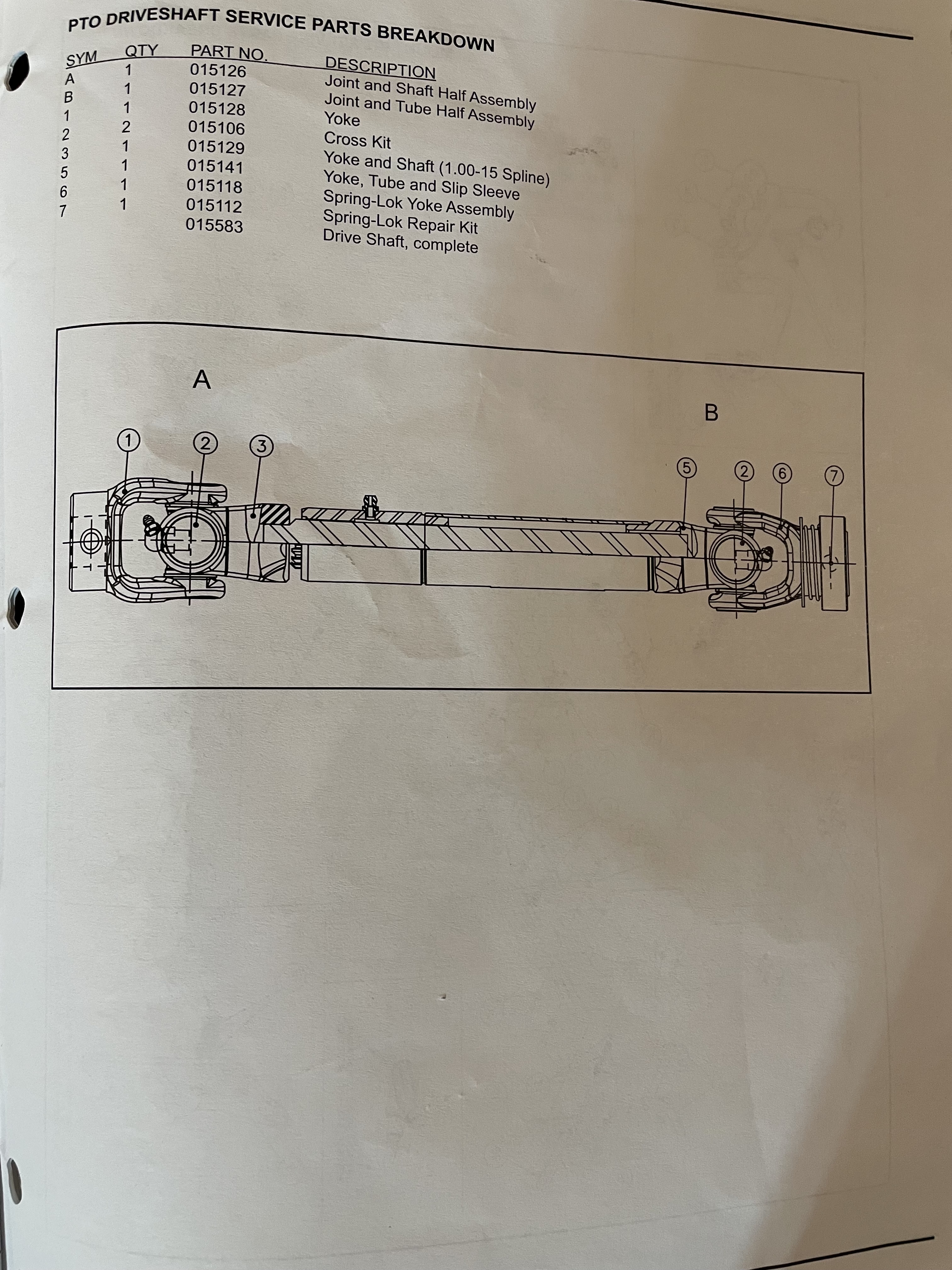

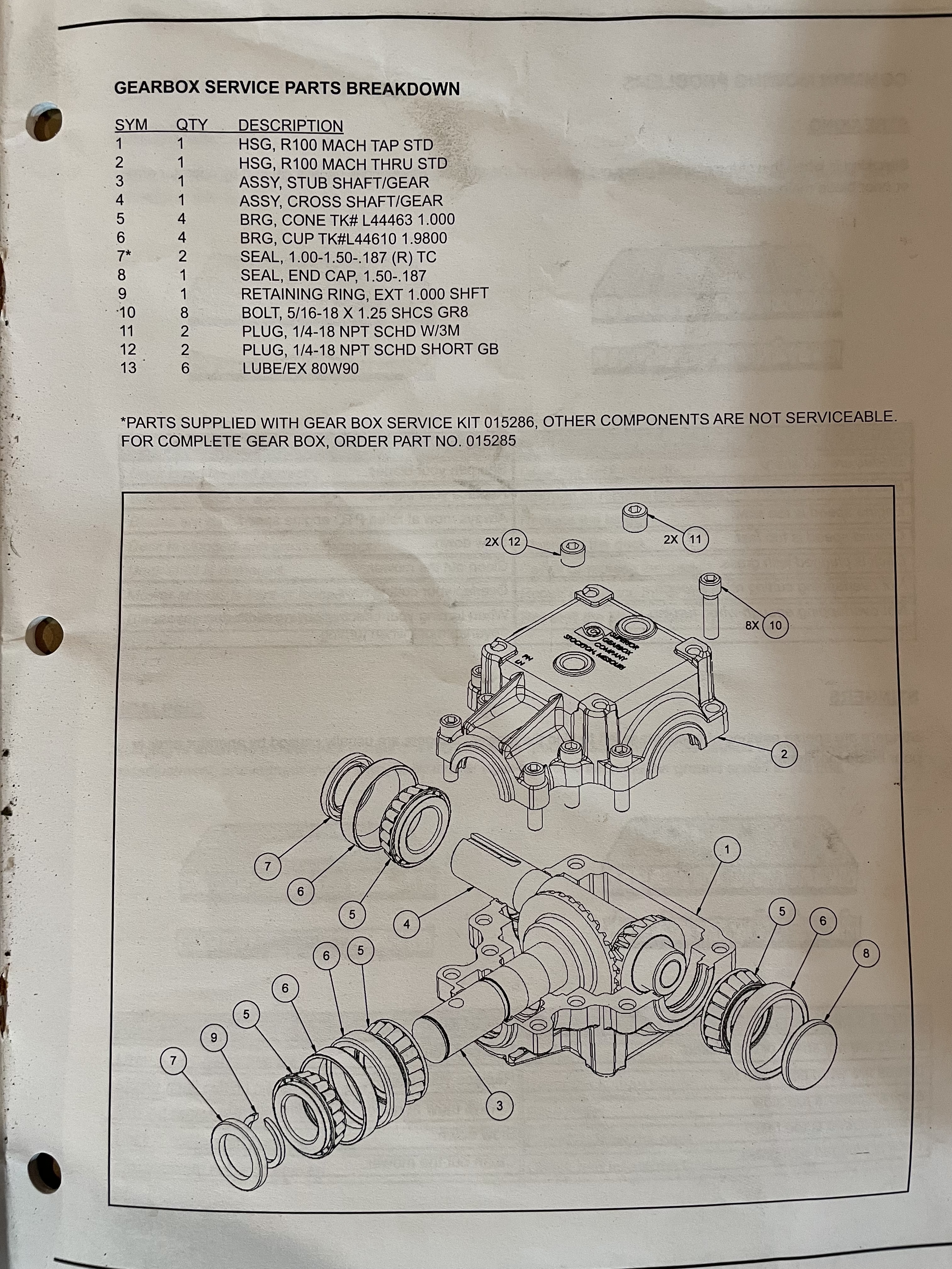

does anyone have a manual for this in pdf format or even jpg? i have some exploded parts view but the whole pto unit is missing in the diagram - it has the main unit parts listed and not the shaft info included. - my unit is and has been frozen for a few years now due to many surgeries. and it only has like 3 hrs maybe 4 at most on it. so i am trying to see what i can do before another big service and transpo bill.

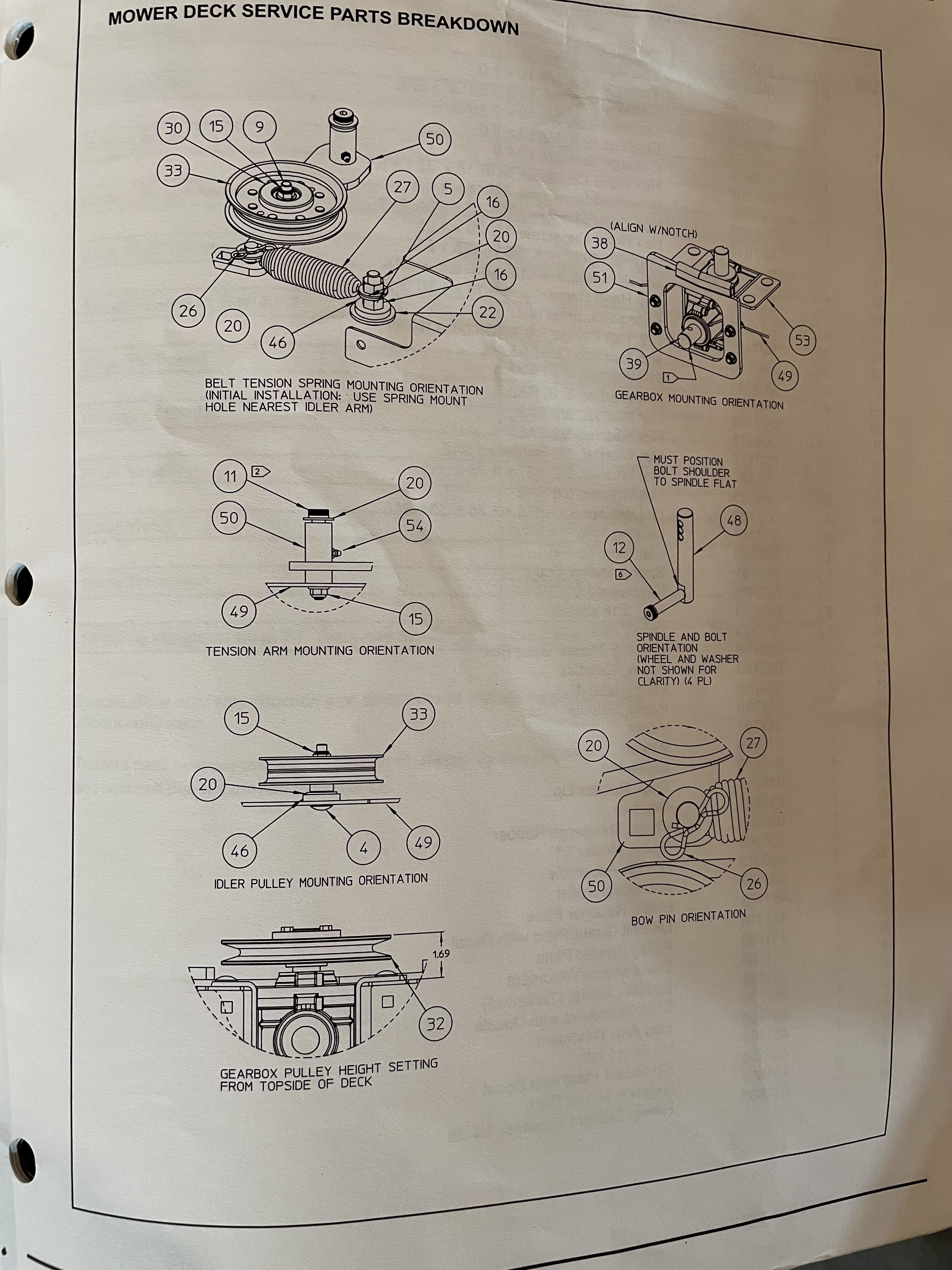

Here’s a generic manual for the deck, out in the garage I have a hard copy of one that came with my deck, very detailed. I’ll take some pictures of the drive train section tomorrow if I get a chance.

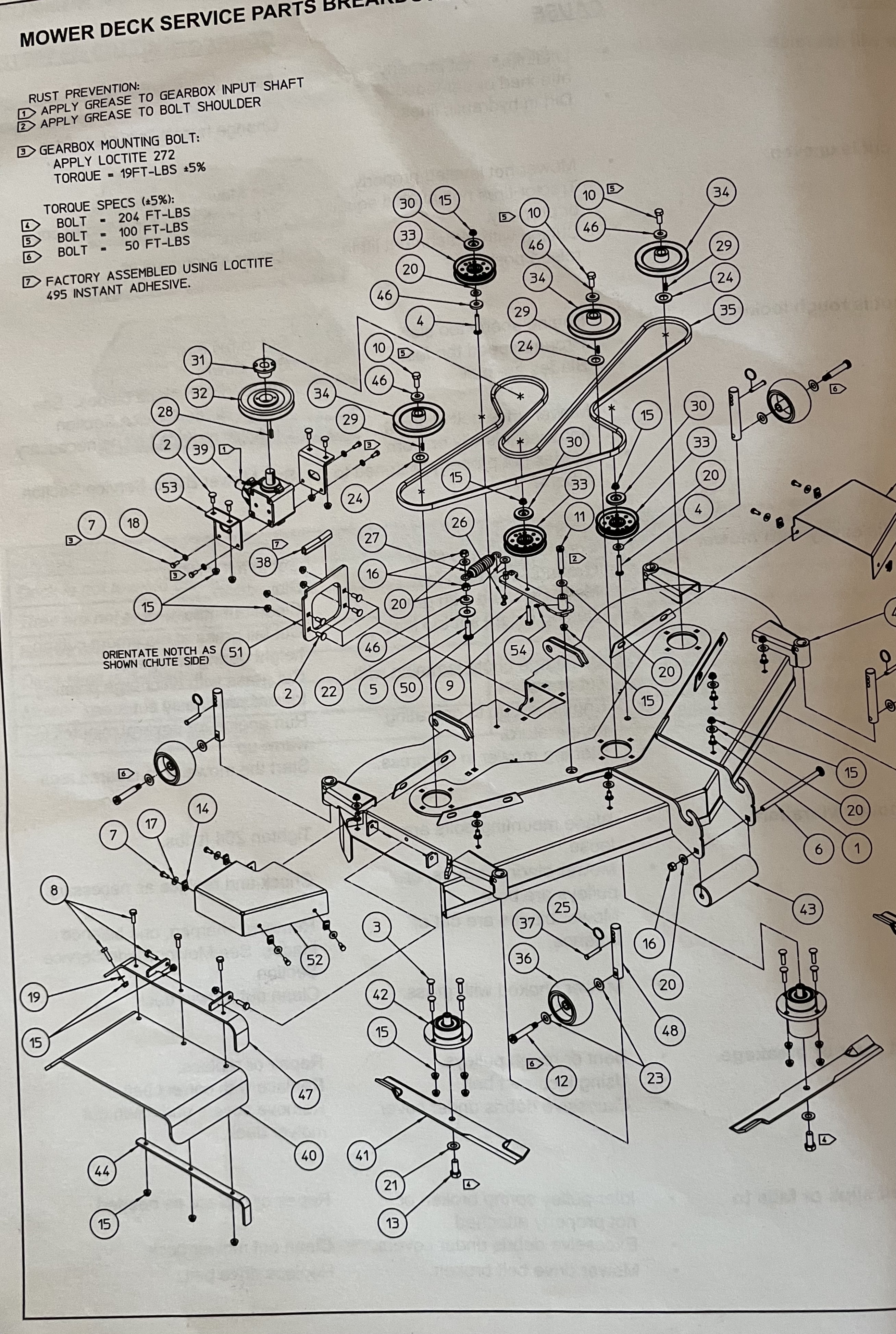

wow!!! THank you again so very much. this will help me a lot. just a stupid question for my next step: the belt covers on top of the deck. are the bolts welded or part of the deck or do they fall through the bottom? - are they all the way through? do you have to be able to access both top and bottom to remove the nuts for the covers?

Hope these help out. If yours is the same deck, there are 4 bolts per cover, item 7 in the parts diagram you remove and the cover comes off. No need to get under it.
