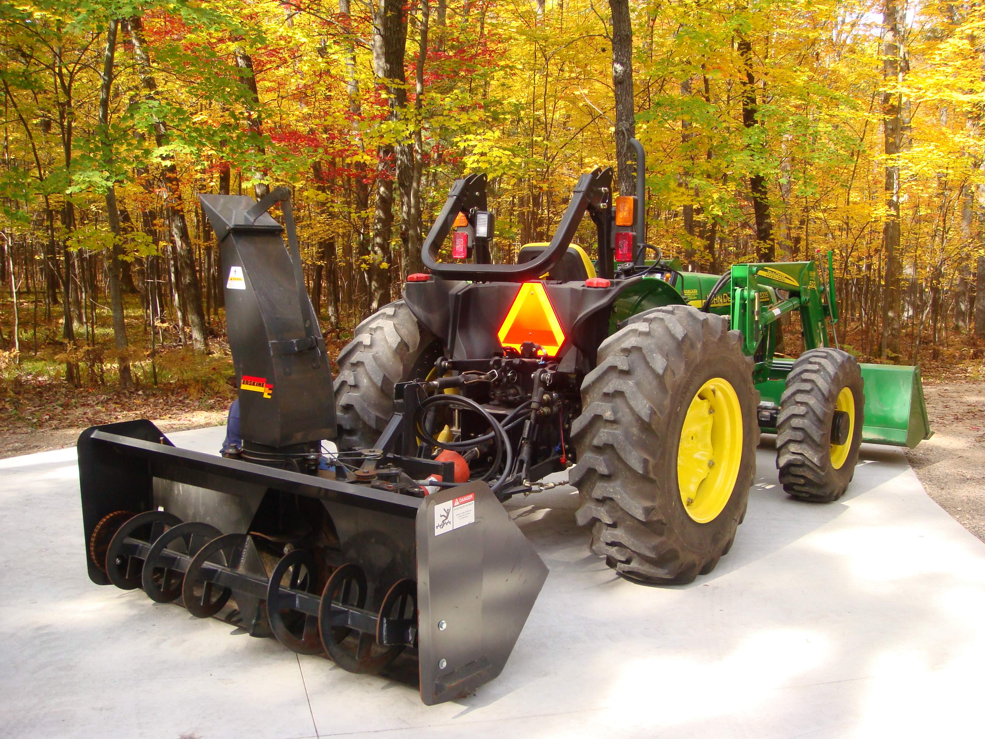

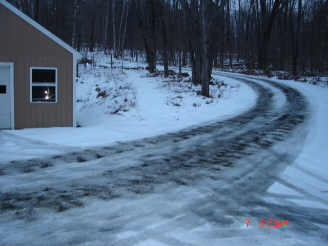

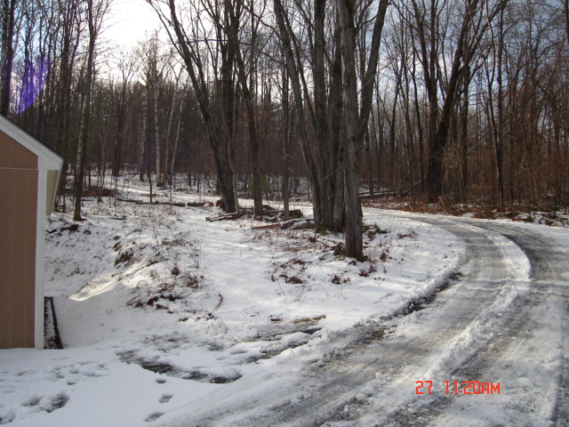

Updates... We've had some snow, not a lot, but also rain. Seems every day when I get home driveway is slushy, in the AM when it's time to go UPHILL, it's all ice. :mad: I'll be glad when cold weather's here to stay and we get only snow. Tractor still has had no problem going up & down driveway with turfs & no chains-- guess we'll see how that works this winter.
Coupla' before & after pics....
  • upper drive:curve.JPG
  • driveway 11:08.JPG
    driveway 11:08.JPG
  • blower 12:1:08.jpg
    blower 12:1:08.jpg
/ Moving Snow #34
irvinj:
Nice looking rig :D! IMHO as a weather geek, IMHO NE will get some snow this weekend. As usual many of the "models" are in conflict. We will probably be visited by an "Alberta Clipper". They generally drop ~3" of snow. There is a possibility that this system could intensify once it reaches the ocean. The storm track will determine who if anyone gets anything. Jay

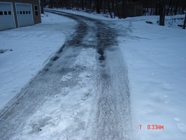

Almost the same here, hondo-- little snow, mixed with rain over he past week... My slushy driveway is now an icy driveway. Been going through a fair amount of sand. Right now there's some light snow falling... you know, the type that's just enough to cover the sand and polish the ice up real nice and make even walking treacherous....
