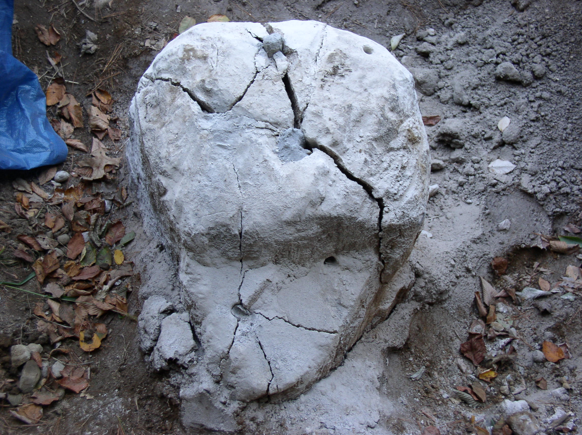

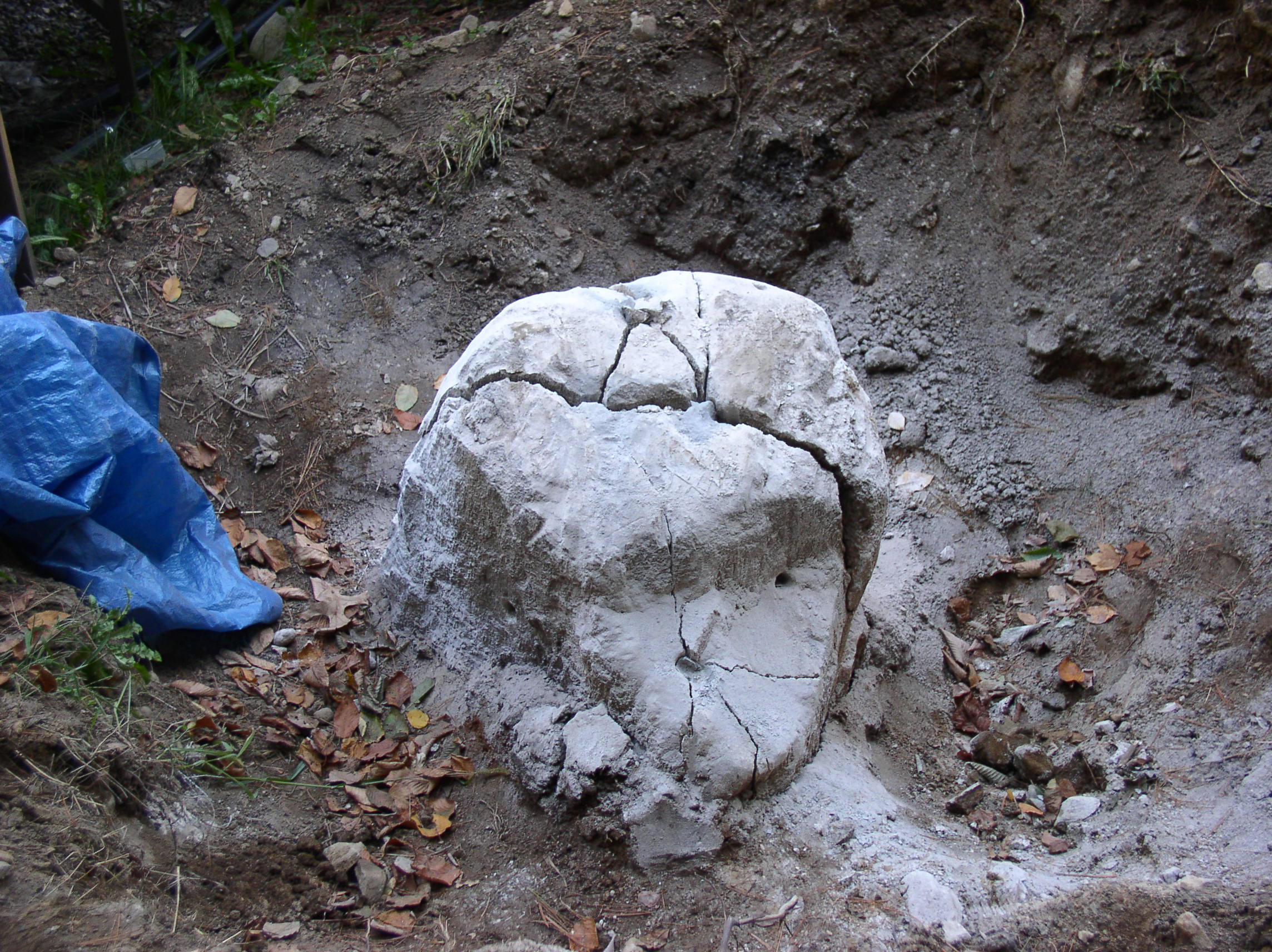

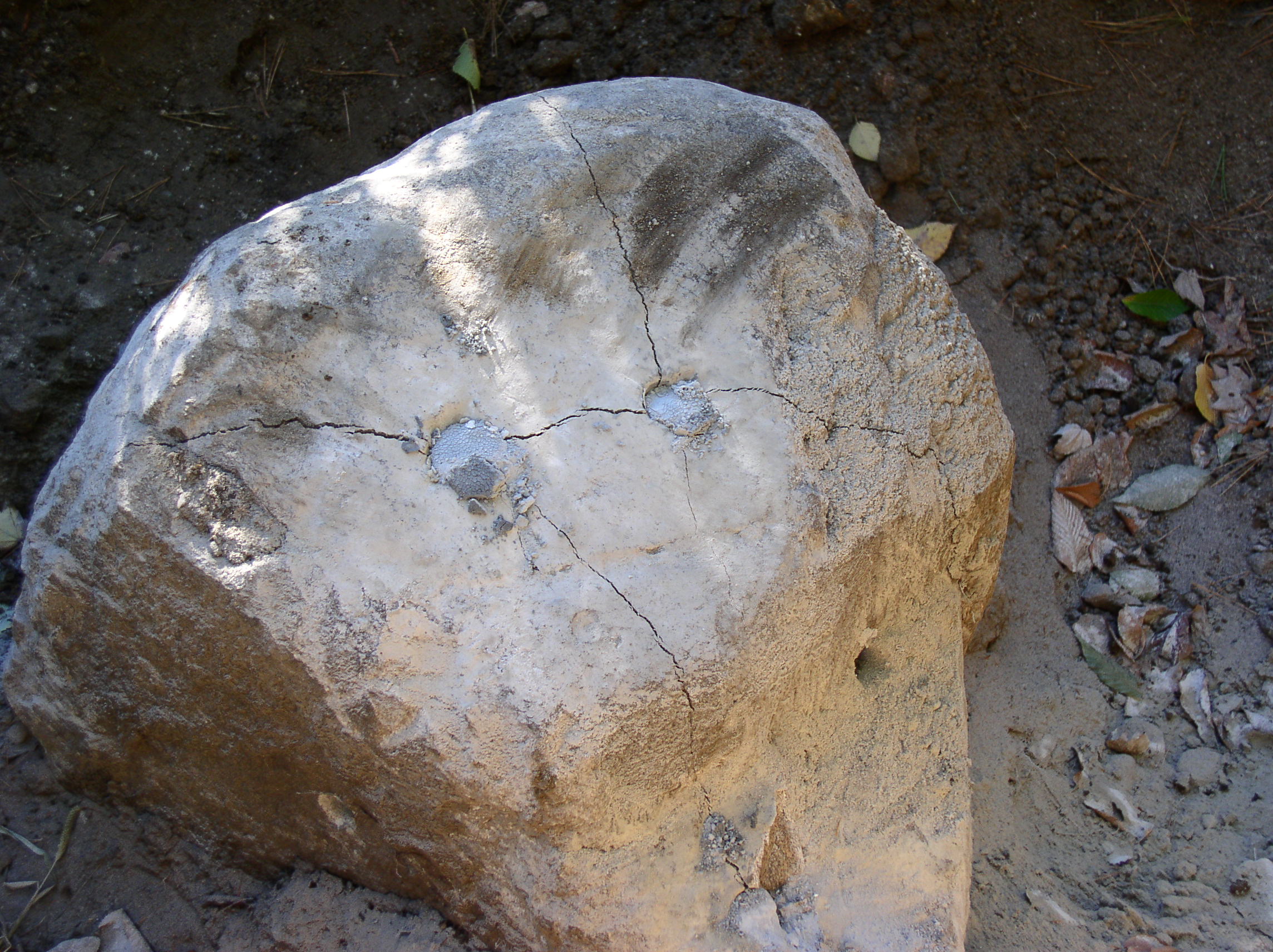

dam rocks don't need fertilizer to grow either lol.

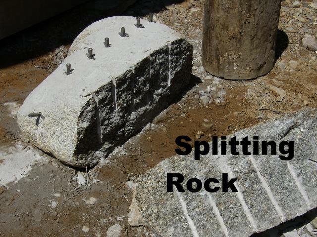

A log choke-chain worked on these, but yours are harder to get to. Glad they ain't mine! Nice bust-em-up pictures, I'll remember that Betanomit and Dexpan

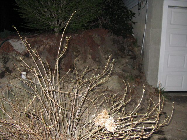

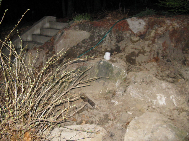

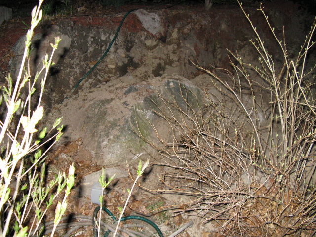

Tomorrow I'm gonna try to get a chain around them and pull them out like wisdom teeth with the dozer. If that doesn't work, then drillin and fillin. Wish I could use dynamite, might get me that third garage bay.

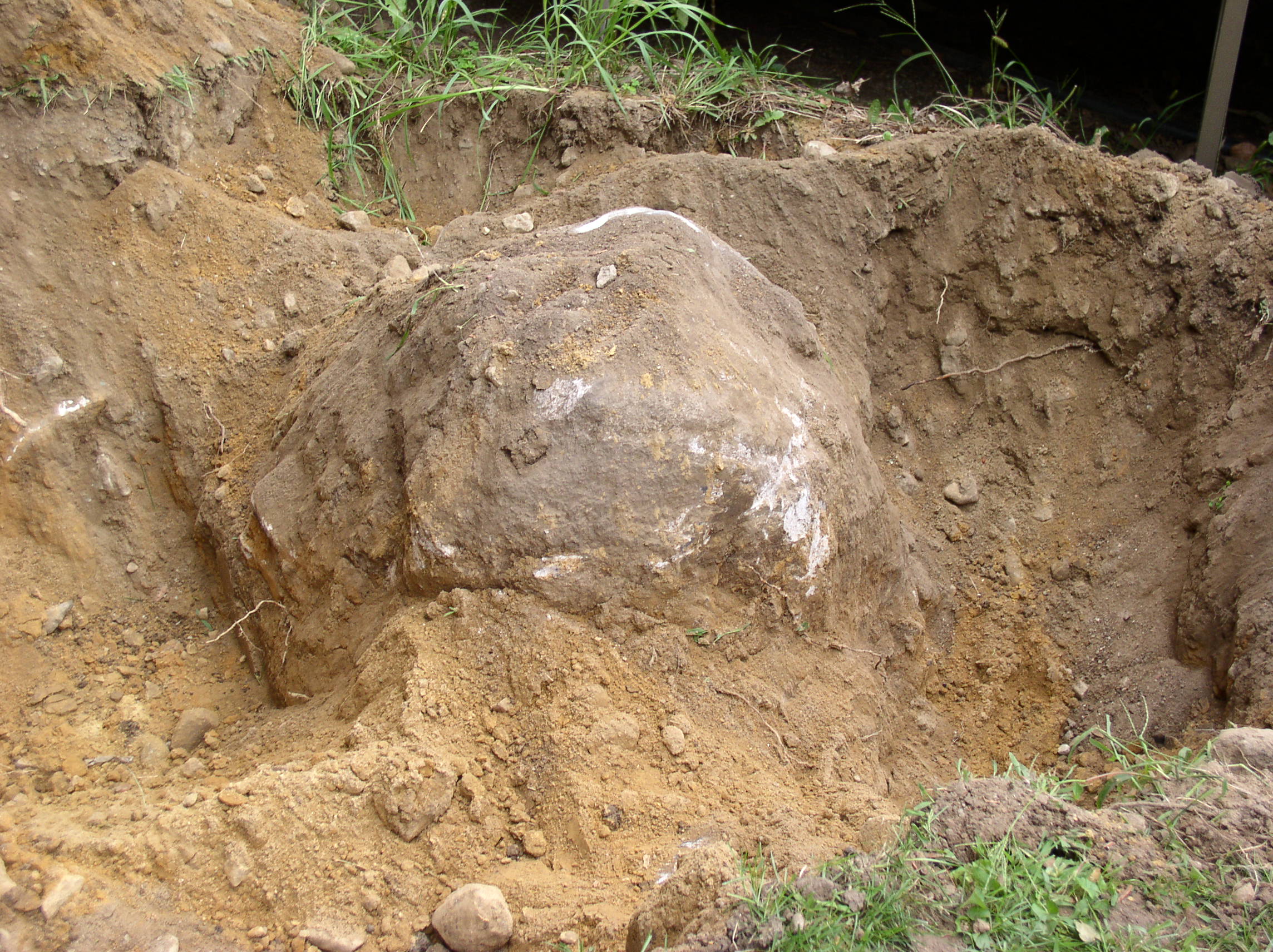

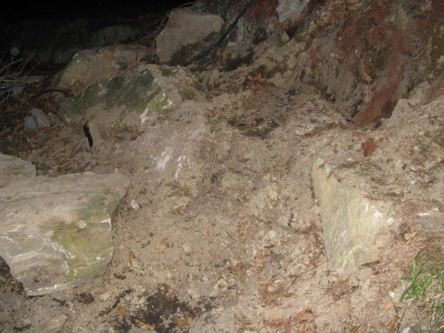

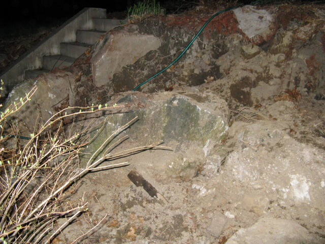

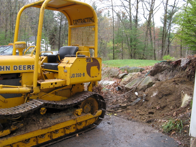

Just got done opening up a can of woop *** on those rocks. Pulled-em out like carrots out of a garden, we showed those rocks no mercy. Check out the picks, the equipment worked like a charm, see, I told the boss we could not live without a dozer. The average guy would've just left the perfectly good rock retaining wall that has worked fine for 9 years in place. But not us, good by rock wall and hello block retaining wall that will probably need annual maintenance, who said I don't know what I'm doin?

I did my inpersonation of a mole and dug. I pushed on it a couple of times with the dozer to make sure there was actually a bottom to the rock. Then dug underneath with a shsshsshovel (tough word to spit out). fished a wire and then pulled the chain through. Once hooked onto it with the dozer she came out, took a couple of tugs and two angles, but she came out. Then pushed with the dozer like a dog pushing a ball, it kept rolling as I pushed.
I just can not believe anyone would ever settle here with all these stinken rocks.
Glad that one is moved. One more and I'll be putting in the new retaining wall. I'll be sure to post pictures of the new wall when done.
