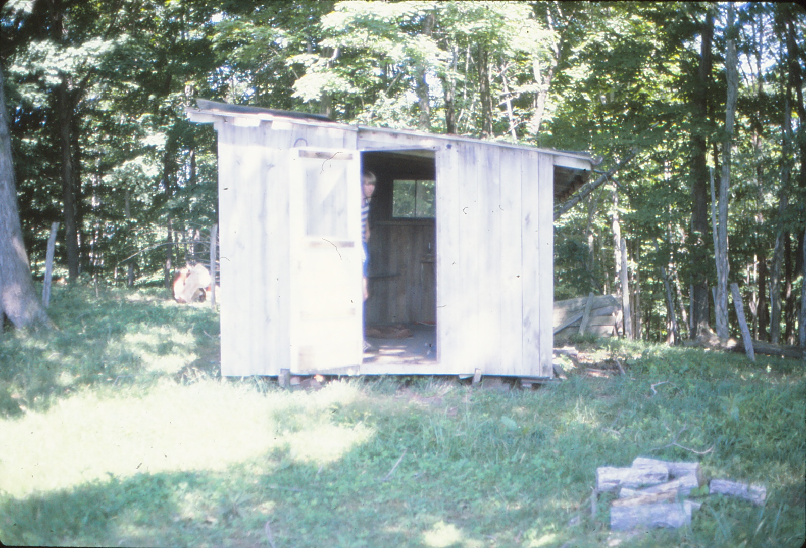

Years ago, my uncle moved a double garage with his Datsun pick-up. He scrounged some old telephone poles he cut up to roll it on after bracing the walls. Moved it about 75' with no help.
/ Moving a shed #35

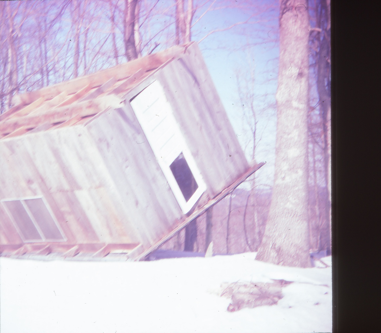

I moved a small cabin that was next to the big cabin I built. I just had to move it back 20 feet, but the ******* was heavy. Luckily the cabin was built on skids.
I bought a 15 ton chain winch for steering. I used floor jacks to jack up the cabin to put oil pipe under it. I wrapped the place in HD tie straps to keep it al together. I then had one person use the chain winch for steering to where I wanted it to go. I had a friend use the mini ex to push it back into it's place. It barely had enough power to push it.
It was a nerve racking day, but I got it.
From where it was, to where it went to...
That looks heavy.
