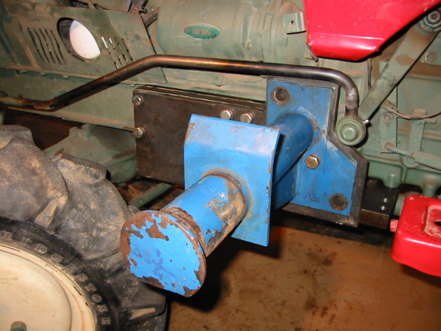

After a bit of a break I started to work on the loader mounts today. I finished the rerouting of the hydraulic lines, drilling of the rear loader brackets and welding and test fitting of all of the rear mounts.
Here is a photo of the rear mounts that I fabricated. In all, the rear brackets weigh 214 pounds, use 32 hardened bolts and are mounted in 20 threaded locations in the frame, engine, clutch housing and transmission. I was quite a challenge to get them all lined up.
Cameron

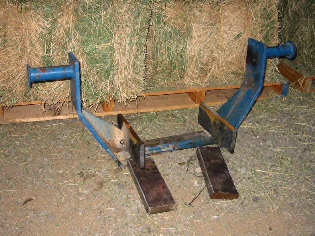

Here is a shot from a low angle looking at the bottom of the transmission housing. I mounted a 1" X 3-1/2" X 14" bracket to the transmission between the side brackets. Here all of the pieces have been temporally test fitted and spot welded together. I will use 8 of the 12 bolts to mount the supports to the rear axle

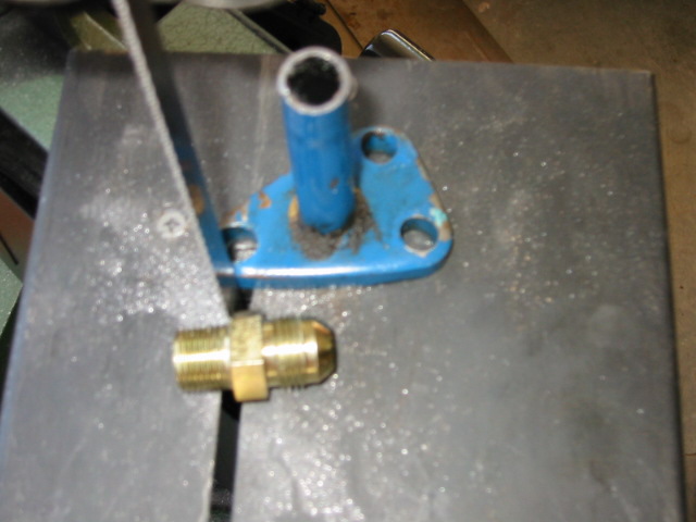

The last three hydraulic connection will adapt the 12 mm Yanmar tubing to the Ford's 15 mm tubing via flexible hoses. I did this by using short hoses with 12 mm hydraulic compression fittings on one end and standard 3/8" fitting on the other. However, This required cutting one end off of a 3/8" fitting, drilling it out to near 15 mm and brazing the fords tubing to the 3/8" fitting. The following photos I hope will illustrate it.

I got in a hurry and did not photograph all of the steps of brazing the fittings together. In summary, I cut off part of the 3/8" fitting, drilled out the hole to match the size of the 15mm tubing and brazed it all together.
All of my adapted fittings brezed together well with no leaks however one of the Fords connections needs a new O ring.

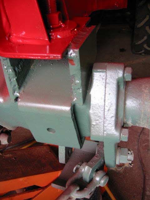

The original Ford support bracket was designed to fit inside the fender. The Yanmar fender was about the same size so the support fit nicely. The support starts at the bottom of the photo near the large bolt and extends upward to the bottom side of the top of the fender.
The large bolt used to be the only thing that held the support to the axle bracket. I welded both pieces securely together with several heavy steel plates which cannot be seen in the photo.
