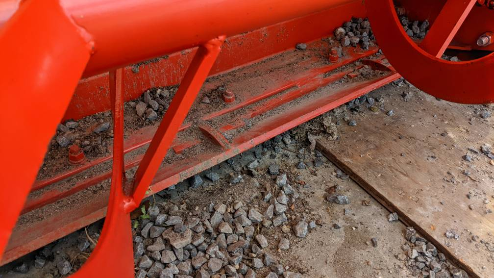

If you purchase a set of armor skids for your snow blower you will have a better
larger heavier skid system that will last much longer.
www.snowblowerskids.com
All that is needed is to remove a skid measure the distance between the mounting holes in the side weldment and look for the skid you need on the list for farm tractors. If you are not sure or have questions Bob can answer them for you. He helped me a great deal with finding the right skids for my snow blower.
if you are still sucking up gravel you can mount some edge tamers in the middle third of the snwo blower width having them welded in place.

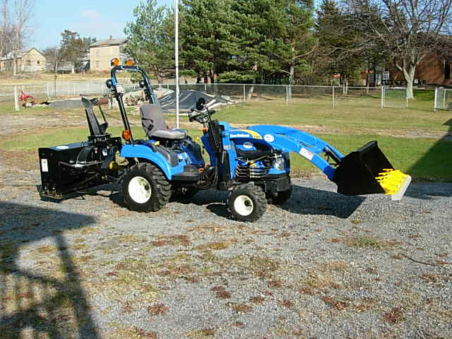

I solved my gravel problem on snowblower, by getting a front blade. Now I felt safe putting the snowblower on after I have a solid frozen base. Only 2nd winter, but haven't had any problems with my SB68 P/T
