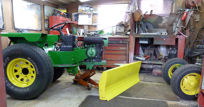

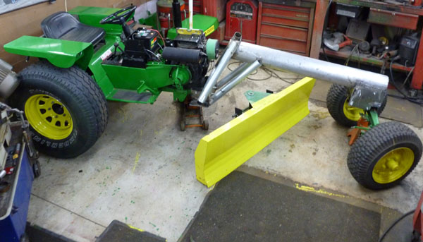

Todays picture shows tractor number four in the workshop. I have already pulled the front axle off , rolled the axle forward five feet and set the blade from the walkbehind snowplow in the center to get a rough idea of my plan. :confused:
This tractor has been in the shop before to get home made rear fenders, hand built rear wheel adaptors for larger rear tires, new five bolt front hubs and spindles for larger front tires . :thumbsup:
I guarantee two weeks from today it will look much different. :thumbsup: aaagrader1.jpg

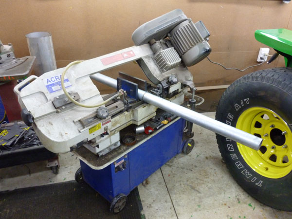

Building it more like the old road maintainers. Several years ago I built two models for a 80 year old fellow and his 83 year old brother who had a real Ford Maintainer and I was the only one they could find to build them out of steel for them. So this project is a little on that idea.:confused:
Todays picture shows me cutting out the 6 inch steel tubing and some 3 in. steel tubing for the front frame beam section. 20 years ago I bought this band saw and only used it five times. It sat for 18 years and last year I was going to put it on Craigslist for $200.00 . Once I started puttering with the garden tractors I started using it.

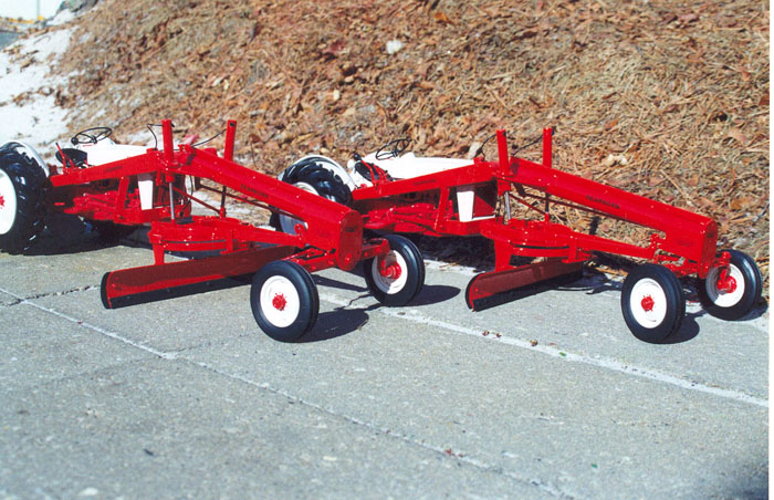

aaafordgrader2.jpgHere is a picture of the Ford Maintainers I built steel models of several years ago.

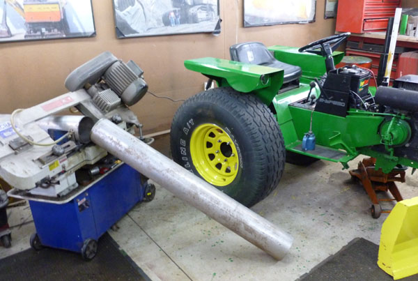

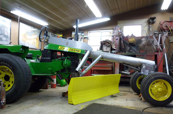

aaagradertube.jpgTodays picture shows the front tube section now bolted to the rear frame . Now I will design the parts to attach the front axle to the frame.

Todays progress pic shows the parts cut out and welded to connect the front axle . Next I will work on the steering and beef up the center of the frame more. aaagrader7.jpg

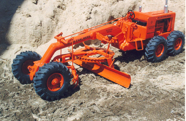

Here is a picture of one of my handbuilt steel models of a grader I built a few years ago. :)aaagrader8.jpg
/ Mini Road Grader / Garden tractor Project
#16
whoops , here is the all steel hand built grader model I made a few years ago. ACgrader.jpg

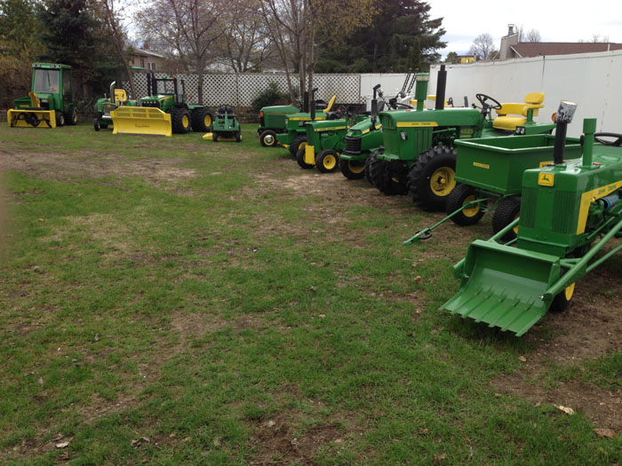

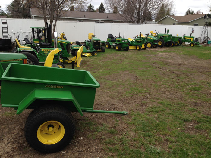

Today I beefed up the grader frame . I also got most of the deere herd and lined them up in my
aaadeereherd1.jpgbackyard. :ashamed:
/ Mini Road Grader / Garden tractor Project #20
Great looking fleet Waldon!
