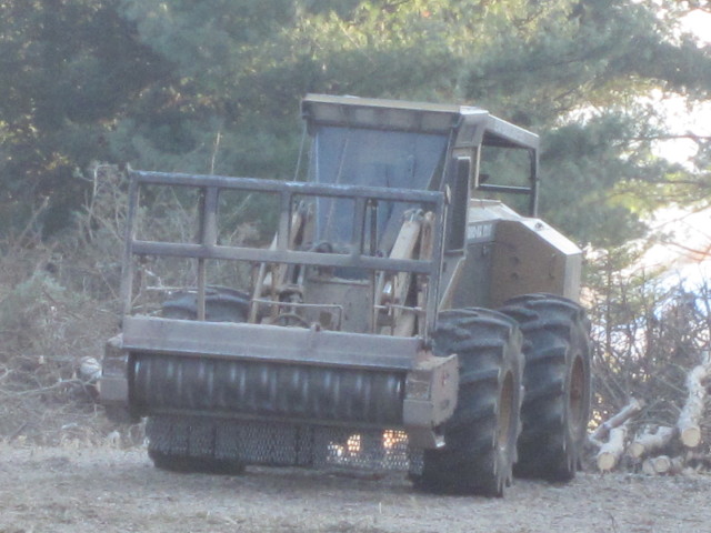

I like the idea of the mid sized excavator with a forestry mulching head,working a semi circle would reduce the travel time com pare to mowing/mulching time.
From what I have seen around here the final job by a mulcher unit is much neater and cleaner then the same job by a brush hog.
The main problem I have seen with the mulchers is when they catch a dang rock it can tear up teeth awful fast.
A mulcher or brush hog on a tracked skidsteer has to drive every were it cuts where as a boom mounted unit can reach out aways for steep banks or draws.
This was my original thought and title for the thread. Nobody will rent them in my area, so I’m limited to rubber track skid machine with mulcher or brush cutter.
I am looking for someone in my area who owns a mini/midi with mulcher head I can supervise for them. Moved on from that to tracked skiddy.

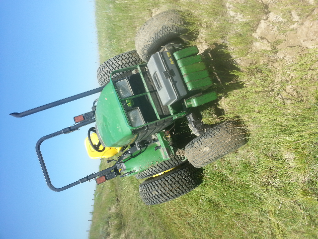

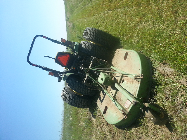

I have a Deere CX-15. We are well past the capability of a garden tractor with a 5 light duty cutter. :laughing:
Im clearing 30 foot tall autumn olive and sweet gum with 4-5 inch bases. Your residential duty field mower would be destroyed in an hour. Your tractor would be stuck before that. I can稚 even get a 150HP farm tractor with 4wd and AG tires in there. :laughing:

I have taken the sensible comments and ideas made by others and Im using them! I get you want to help, but the mere suggestion of using a light duty field cutting machine shows more of a lack of understanding on your part.
Hope you understand, no offense intended and appreciate your contribution-I just cant do it with what you are suggesting or I would use one of my tractors and CX-15s. They can cut stuff up to 3-4”, but the slope it too steep :thumbsup:
