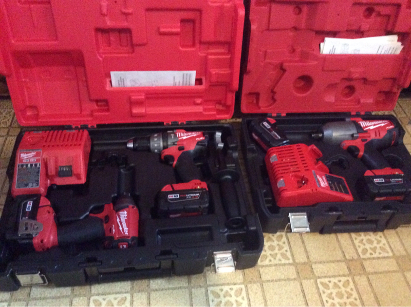

I stopped in at a large local tool supply today and ended up getting an awesome deal on a M18 2763-22 kit with two 4.0 batteries, charger and case on special $100 off. I got it for $329.00
   / Milwaukee power tools #25
Great deal...that's like getting one 4.0 battery for free!

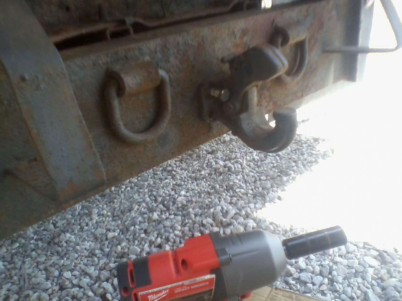

I used the 2763 impact today and I am very impressed so far!
