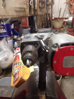

The hole hawg has more slop than I thought, but not a 1/2 turn. More like a 1/4 turn. All the way to the left and right. ImageUploadedByTractorByNet1454088727.816007.jpgImageUploadedByTractorByNet1454088762.316684.jpg

There ya go and it's enough to blow the gears when the spindle jerks...
I bought mine on a sat., Kurt, the guy behind the counter (AIH in Alaska) tried to get me to buy the Elu, but I had a magnum and wanted another Mil. drill...
It took me about 10 mins to blow it and when I came back later that Sat., as I walked to the counter, Kurt said: "you blew the gears didn't you? I TOLD you to buy the Elu"!! AND I did... It's a MUCH better drill...
Monday morn when I got back on the construction job, the Plummer "Terry" said, Hey, if you had told me you wanted a Hole Hawg, I would have given you one, there's a couple on the bench at the shop with blown gears"....and all the guys on site busted out laughing at me... lol lol
SO, Kurt had already put the word out... ha ha ha
The Elu has a stronger glass filled motor than the Hole Hawg, with a built in "ratchet clutch" in the lower gear of the gear box, to keep you from killing yourself...
It's by far the stronger better drill, I even used it for a "starting motor" (in hi gear) to crank start the pony motor on my CAT, something that the Mil. wouldn't do... I made an adapter just for this use...

I have a Dewalt version. I have used it quite a bit and it works great. I have another Milwaukee magnum drill that I have used quite a bit. It has way less slop than the hole hawg. The hole hawg might not be their best tool, but other wise Milwaukee pretty good. I bet you can find a turd with pretty much any company.

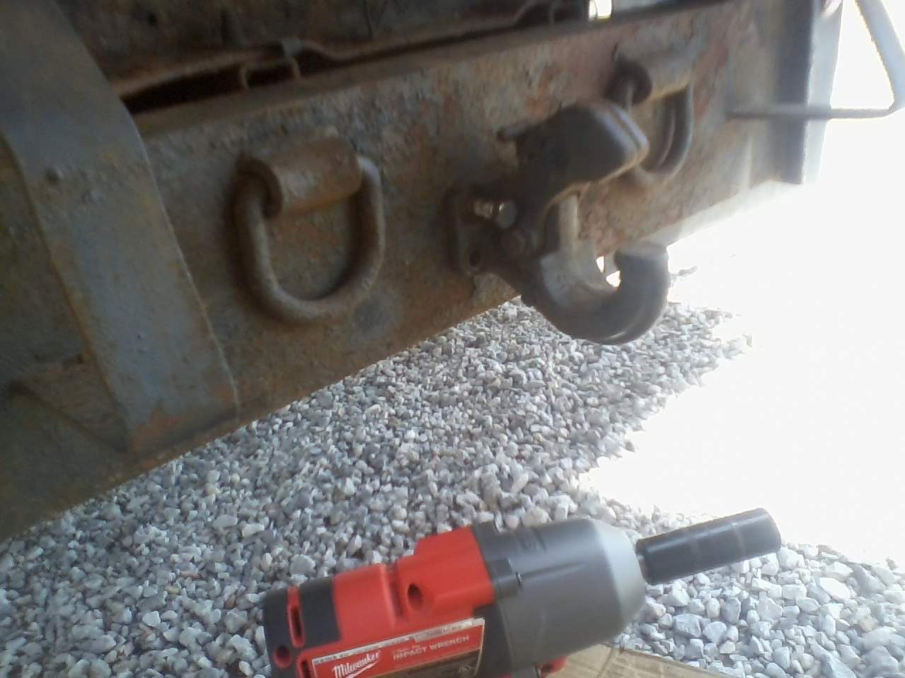

I bought a Milwaukee Fuel 1/2" 18V impact wrench the other week. I've been pretty impressed with it.
I own a couple of the Fuel tools and the only thing I thought could be improved is the chuck on the 1/2" drill/driver. They don't have enough knurling on the chuck to help you get it tight enough to hold smaller drill bits securely. Between the one I own and 4 more at our shop, everyone has had the same complaint about the chuck.
