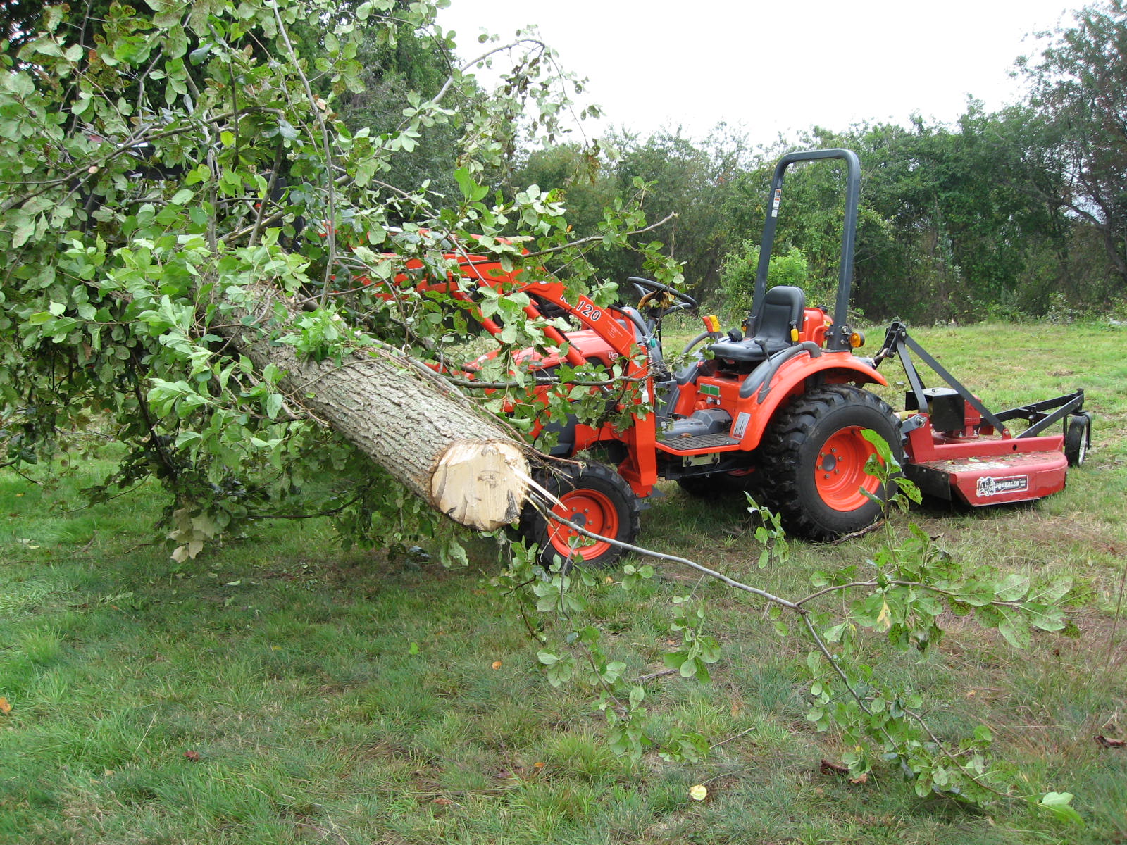

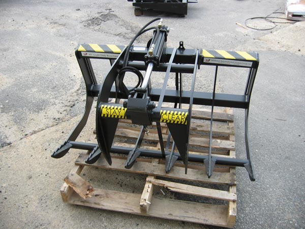

I understand the concern about front tires and have to admit that my 48" grapple does cover the footprint of my tractor. However I would reiterate that you are not moving at great speed when grappling brush and you can see what is coming pretty clearly. Also, I find I am more often using the grapple in a raised position rather than on the ground so even if it were wider it would not necessarily "protect" the front tires from running into a stump or rock.
As an aside, an issue with any grapple is that when you have a grapple fully loaded and raise it to a comfortable transport position (a foot or two off the ground), the load really does block your view forward. That happens even with a narrow grapple obviously. Being able to peek around the side as you move forward is helpful. Sometimes I need to stop, raise the grapple to full height to see under it, then lower and move forward again. Though really an issue with any size grapple as stuff generally sticks out the side (see photo), it might be a bit worse with a wider one.
