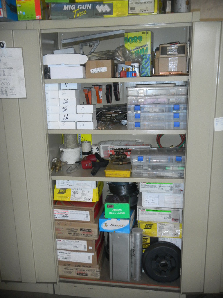

I lost a spool of wire a few years ago to one of those wild temperature swings, looked like it rained inside my shop. Now I try to put my spools of wire back in the plastic bag and in the cardboard box, then store in a locker.
