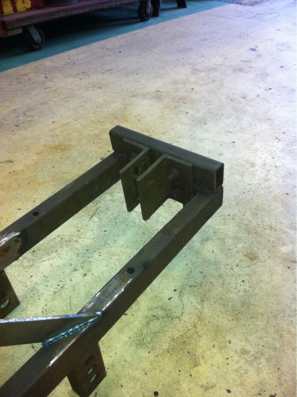

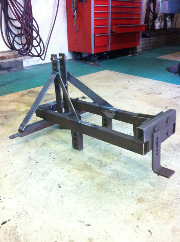

I think the TSC model uses 3/4" x 4", but I'm not completely sure. I built my own too and used 1" x 5" as mine extended deeper than the TSC model. I've attached a couple of pictures of mine as it neared the end of construction. Note I included an option for depth adjustment beyond what the 3-pt would give. Also made it convertable for going either forward or reverse. In the pics, it's turned to the reverse position.

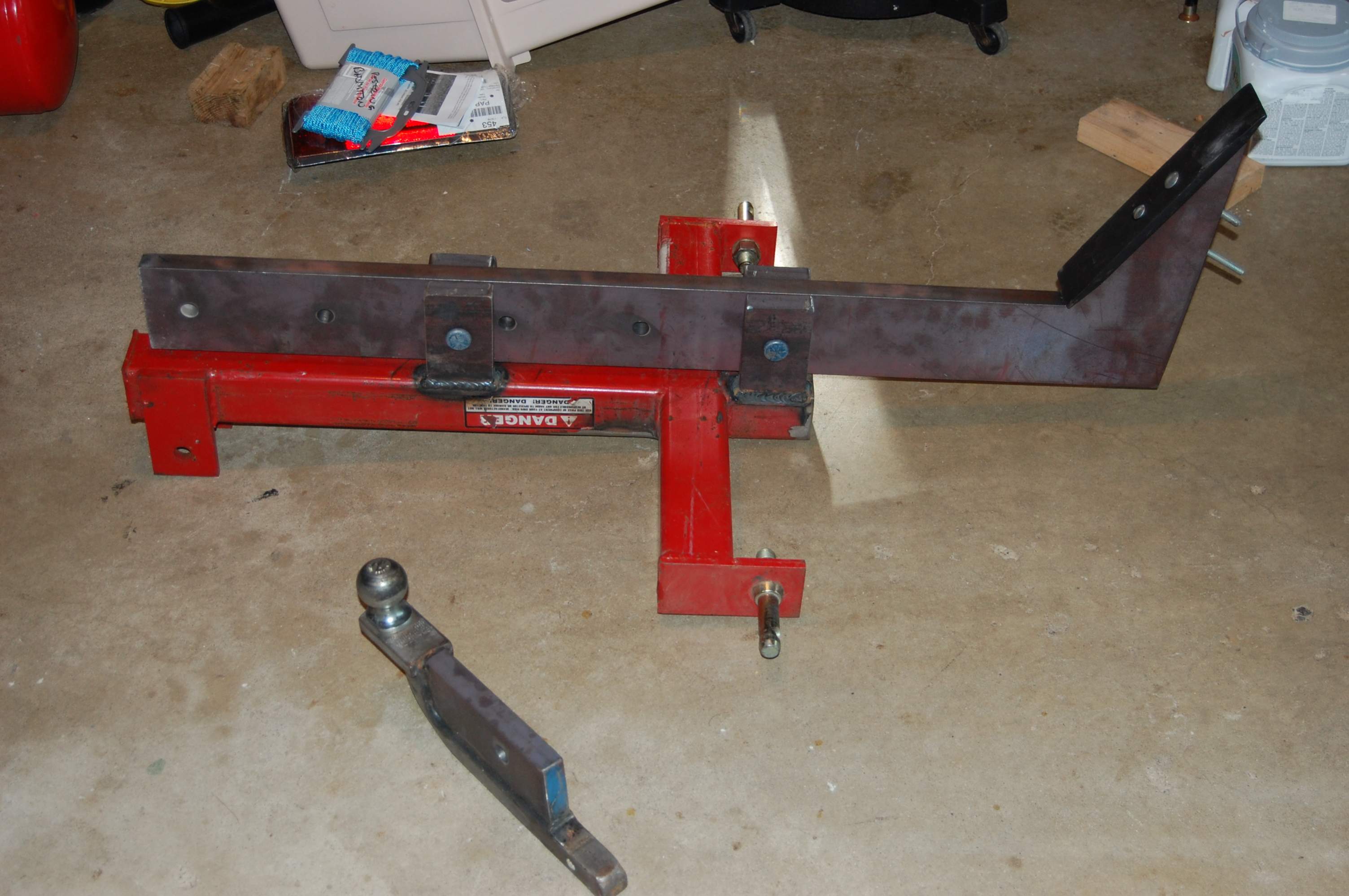

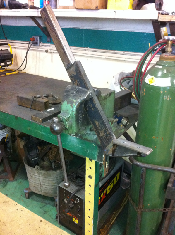

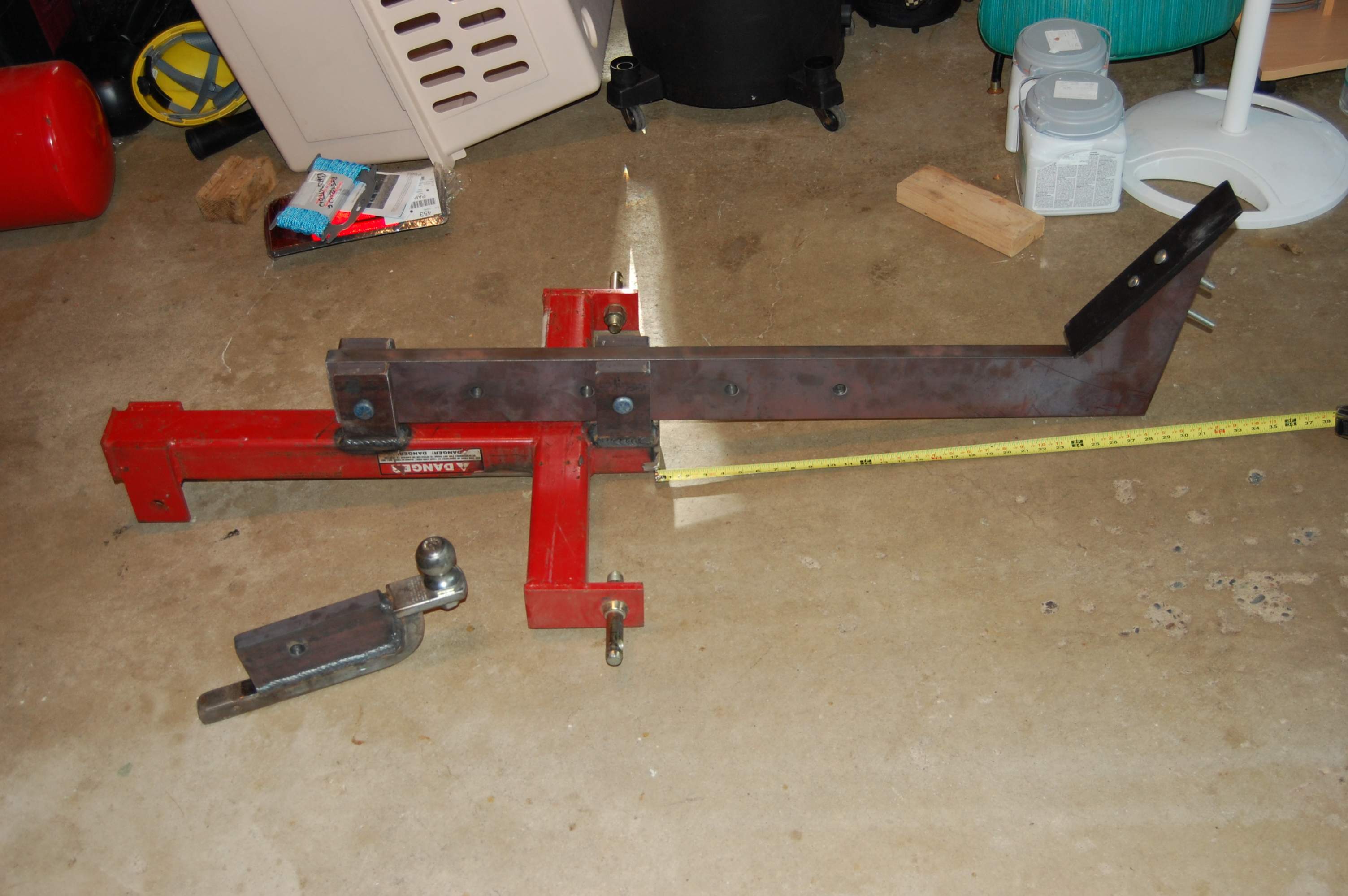

Sub soiled is1 1/2 solid, plow is hollow .two 1/2 inch bolts sandwich them between the angle iron,this frame style also gives you extra height for limited car 1 tractors
