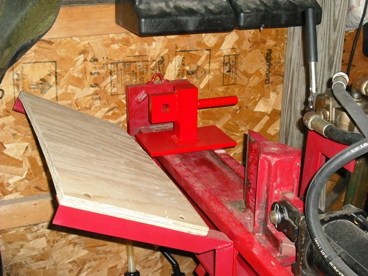

Yes, a 6" bench vise and my 4# sledge.:D
Sorry, could not resist. I do use my home made log splitter from time to time to bend thing by installing my shop press adapter I made.

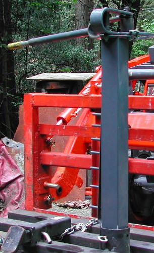

I have the floor-mount unit that Larry describes. I mount it on my fork
frame, not the floor. I have bent 5/8" rods to very tight radii with it.
