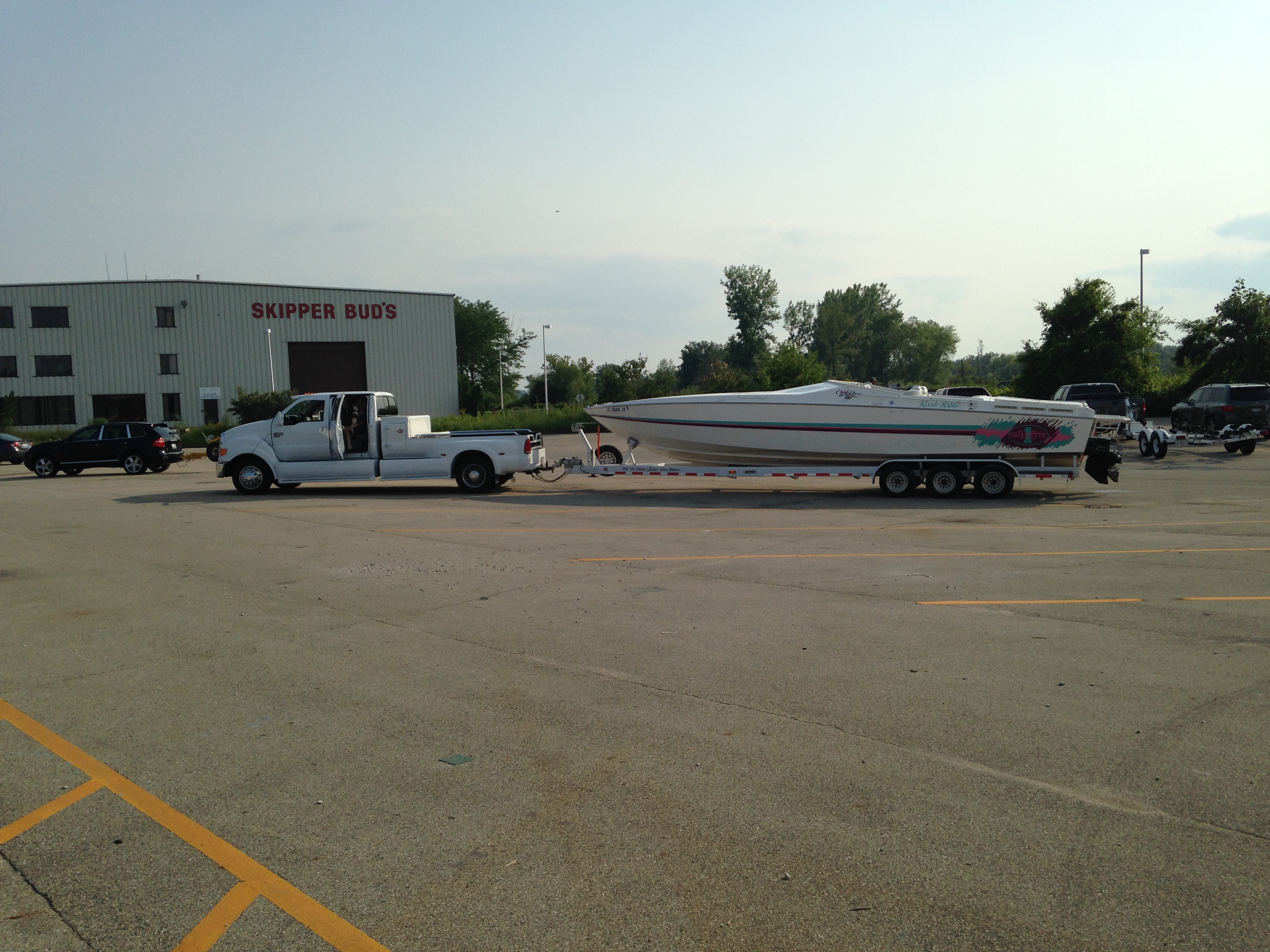

004.JPG i like my medium duty 2004 ford f 650 has 24,000 miles on it 300 hp 800foot pounds torque cat / allison air ride air brakes . insured by state farm as personal truck - cheaper than my 2011 chevy / duramax 3/4 ton and i store it 6 months a year so its cheap to own and yes i do tow tractors behind it.
/ Medium Duty Truck #38
View attachment 640024 i like my medium duty 2004 ford f 650 has 24,000 miles on it 300 hp 800foot pounds torque cat / allison air ride air brakes . insured by state farm as personal truck - cheaper than my 2011 chevy / duramax 3/4 ton and i store it 6 months a year so its cheap to own and yes i do tow tractors behind it.
300/800 is a pleasure to drive. Not a lot of downshifting pulling uphill and not a lot of sweating going down the other side. Air brakes are worth their weight in gold. I remember times when I was a little overloaded and air brakes will really stop you
