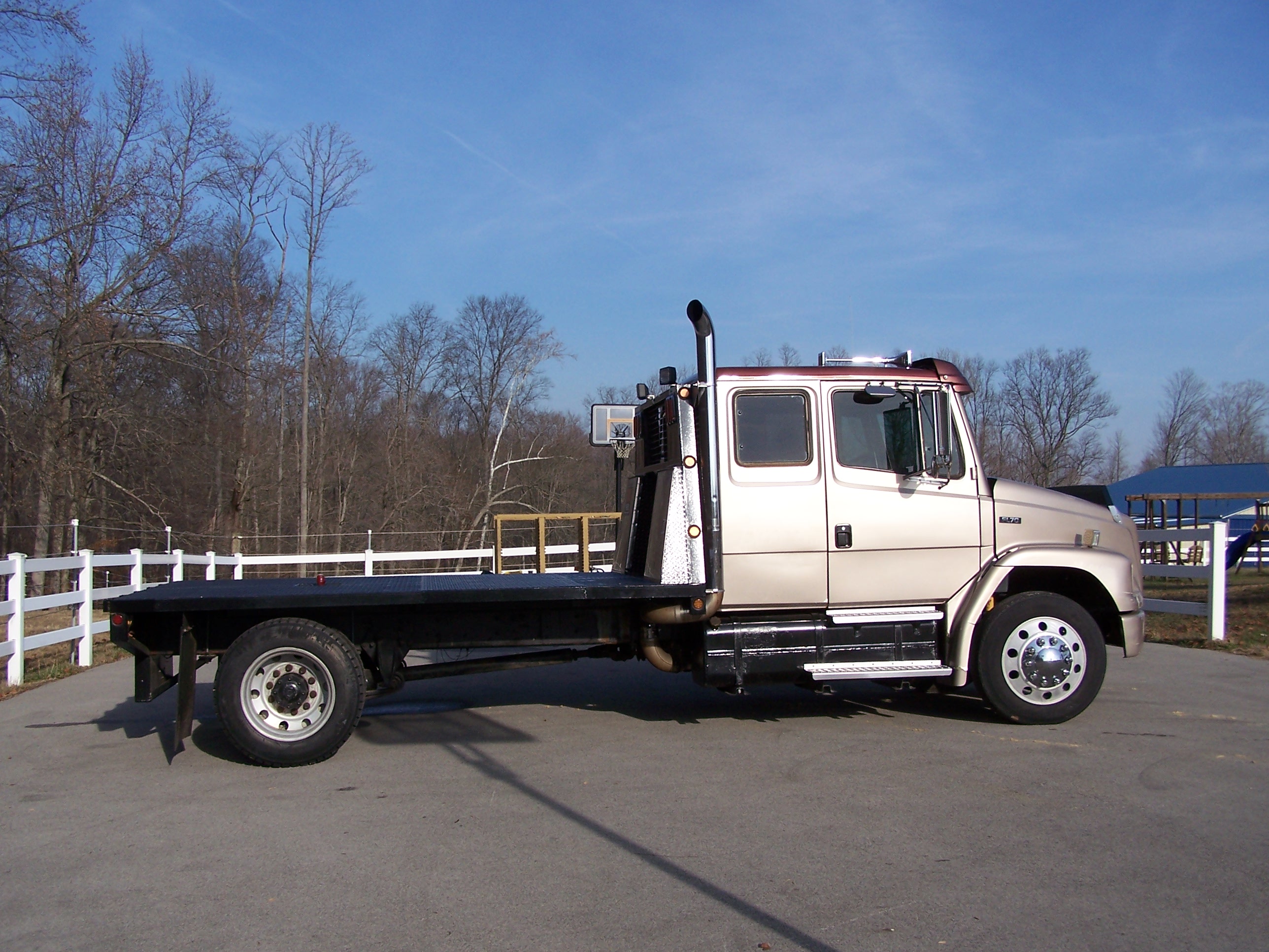

When 5th gear went on my 97' Dodge 12v again at 250k I sold it and bought an FL70, 3126 250hp CAT, 9 speed with air brakes. The Dodge was also in need of brakes and a clutch again so it was time. I just tapped into the brake light wire for my Tekonsha P3. The truck pulled my dually dump trailer like it was not even there. What it did not have was a locking rear so it would get stuck on snot.
I have a Class A so no license issues for me. I plated it with farm tags at 26k rather than the 36k that I would have gone with had I needed to venture out of my area which is somewhat laid back DOT wise. Insurance through the Kentucky Farm Bureau was reasonable.
While a medium duty may handle some tasks safer than a smaller truck along with that come maintenance issues that may end up costing you if you are not up to the task.
Money is an issue so I sold it when I decided I no longer needed that much truck/trailer.

Nice looking truck.
