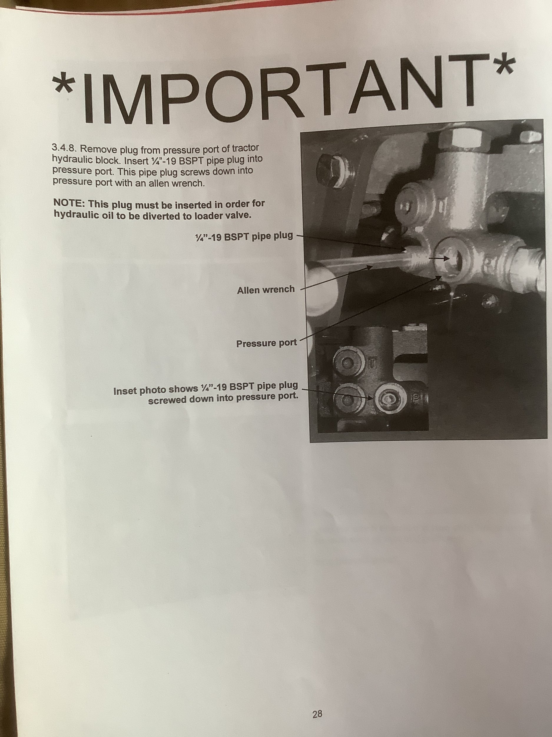

Oops. Not a wild ass guess. Harry in KY said there’d be plugs in thread 14. The screen shot I posted is from my Mahindra loader manual.

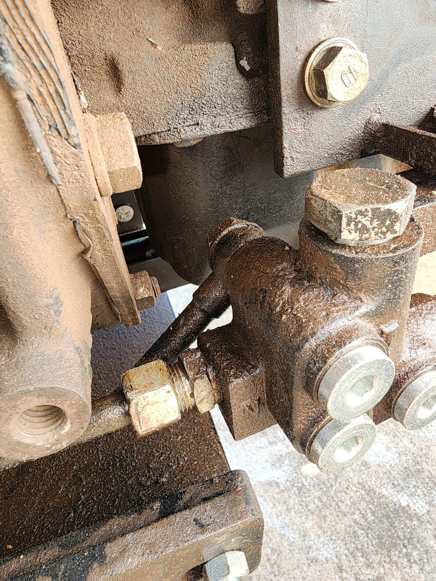

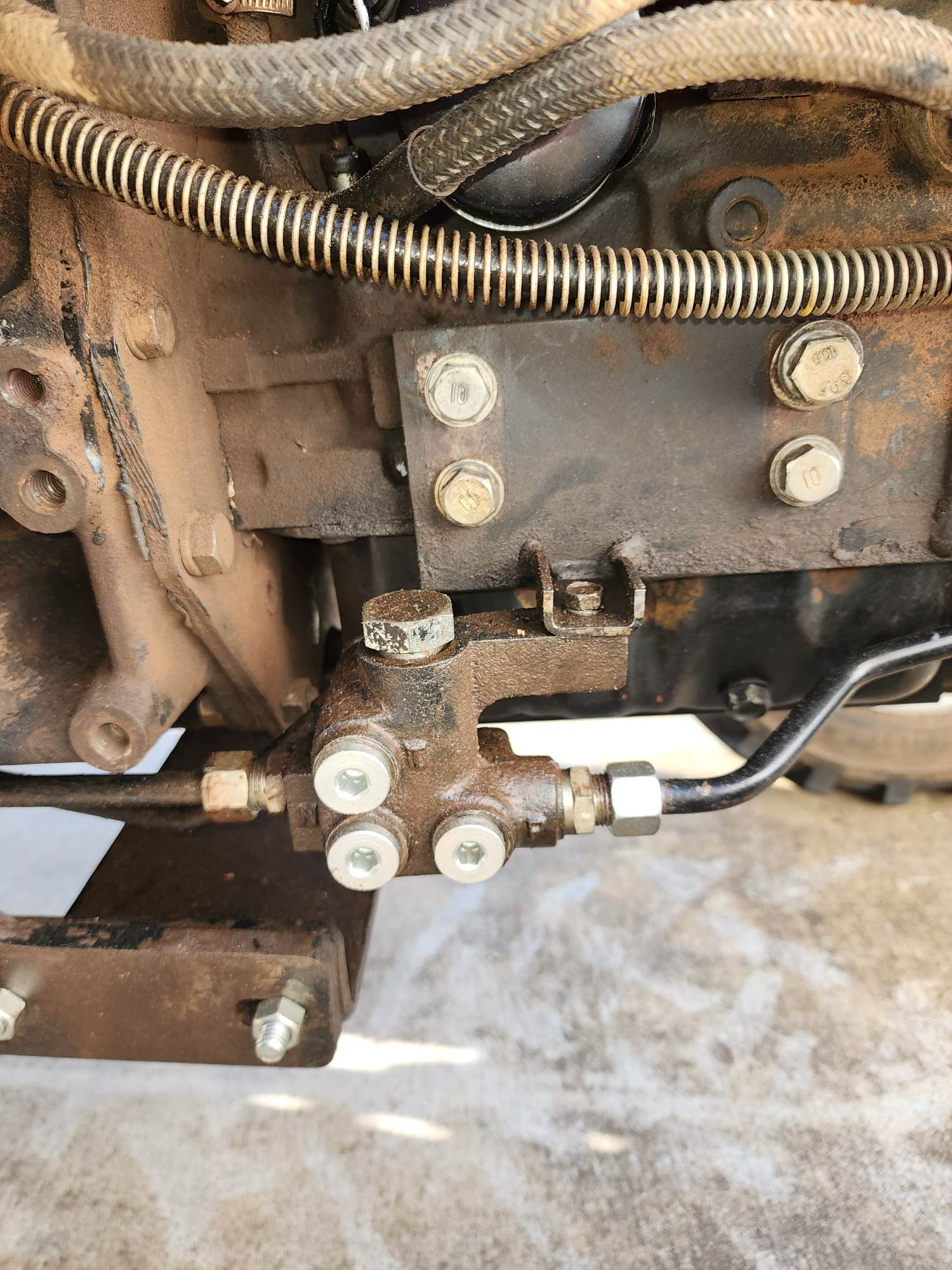

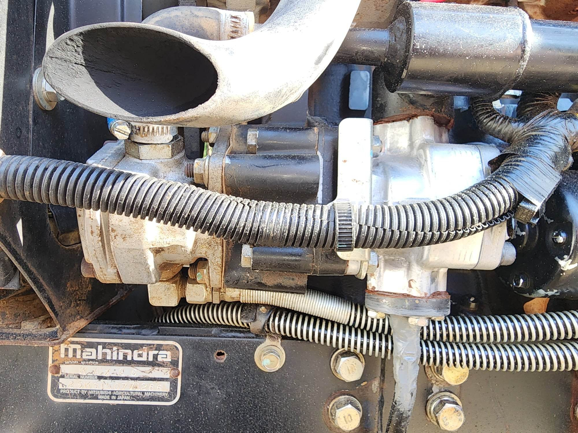

Hope this Helps, this is with loader and backhoe hooked up, the first photo, has a flex line coming out of the bottom, goes to the back drive side of the tractor, and is in the 3rd photo, which has friction tape wrapped around it on the right side. the 2 lines going to the back are tied into the loader valve.

/ Max26XL Hydraulics #26
found another photo with the backhoe removed.
/ Max26XL Hydraulics #27
if you look in this photo, only 2 lines need to be connected, one is completely disconnected when the backhoe is not in use, which i believe is a return to the tank (top with red cover on it), this goes to the loader valve.

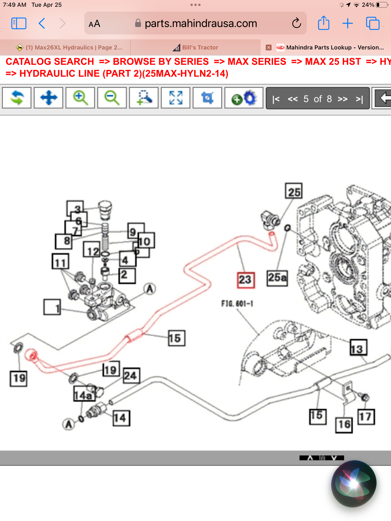

based on the photo's you need this return opened, haven't really traced the loader line going to it though, if i get that service manual maybe i can be persuaded

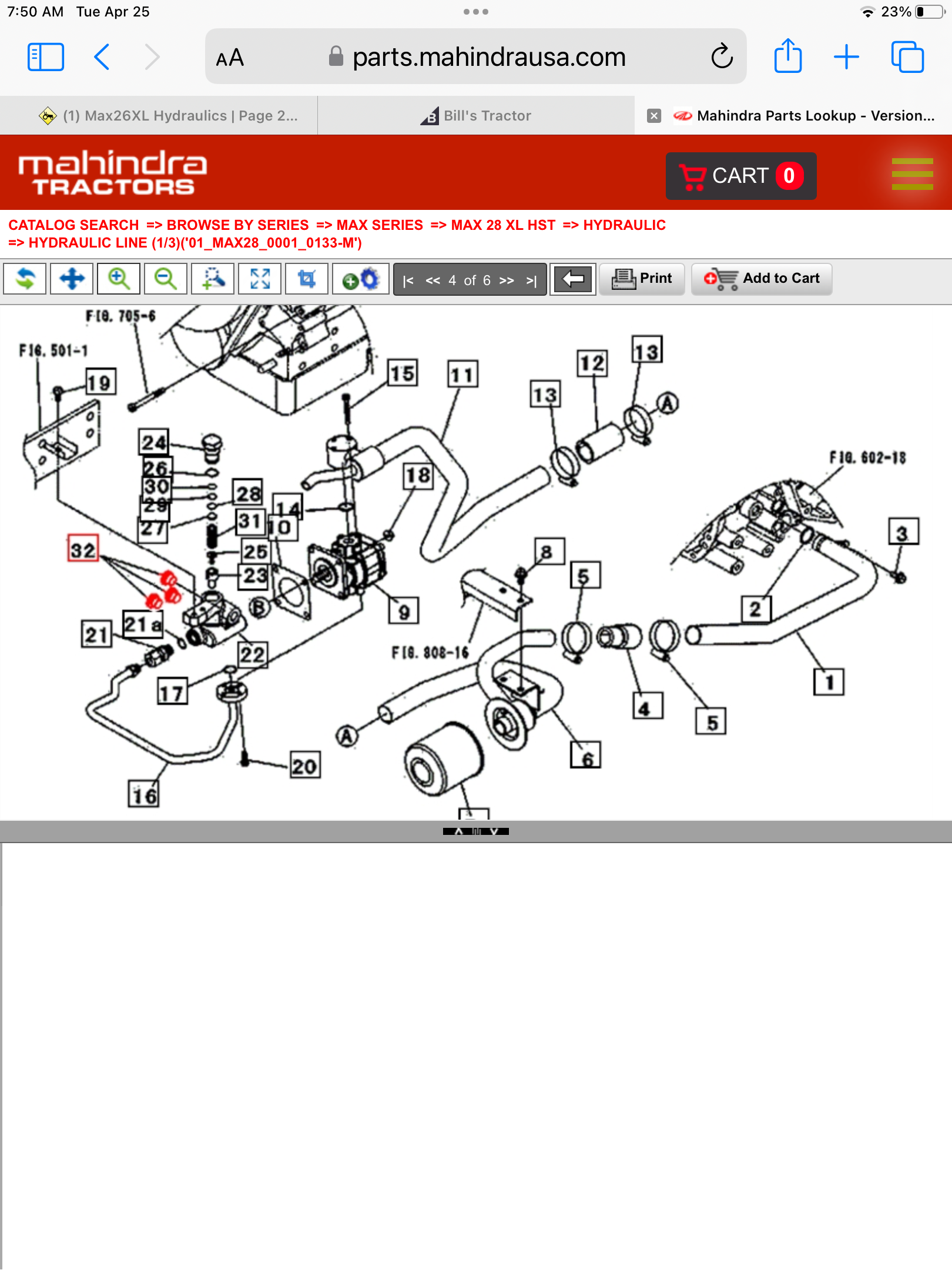

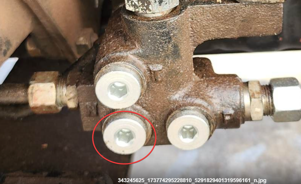

based on my COMPLETE GUESS. you need to loop p and N or p and t, or the pipe plug mentioned in post 20# may need to be removed.
/ Max26XL Hydraulics #31
looking at post 20 more, it appears you just need to remove the pipe plug in the pressure port, this is what diverts the block to the loader, if you remove it, it will free flow, it appears the 3pt is tied into the hardlines, and none of the flex hoses that are run to the back, at least based on my looking at the tractor.

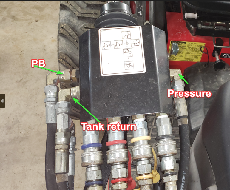

/ Max26XL Hydraulics #32
So You made me learn, I hate not knowing things. I have it figured out
pressure comes in from P port on block, goes through loader, comes out of PB, goes to back, goes into back hoe, or goes back up to front of tractor and connects on N port (circled before), the other line comes from loader Tank return, and backhoe return which is tied in at the loader valve tank return, shown in the second photo on post 25, you can also see the 2 lines coupled in the attach photo on this post as well
The N/PB in the block, is what feeds the 3pt, no pressure there, no 3pt. I finally understand this.
another edit, I was wondering why tank return didn't need a check valve, I assume (someone correct me), that the quick disconnect stops the flow through the splitter and forces it back to the tank.
based on all this, i still believe all you need to do is remove the plug in the p port on the relief/distribution valve
/ Max26XL Hydraulics #33
FINALLY!! We have a winner!
Remove the pressure port plug you installed and look for another allen head plug inside. Remove that, and you're good to go. Stop bothering with loops and extra hoses.
