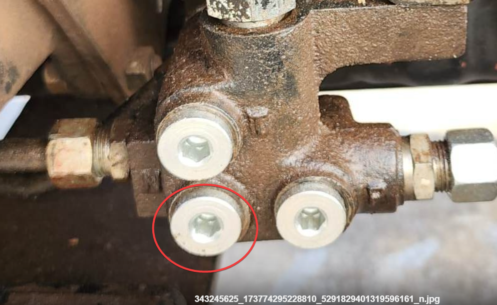

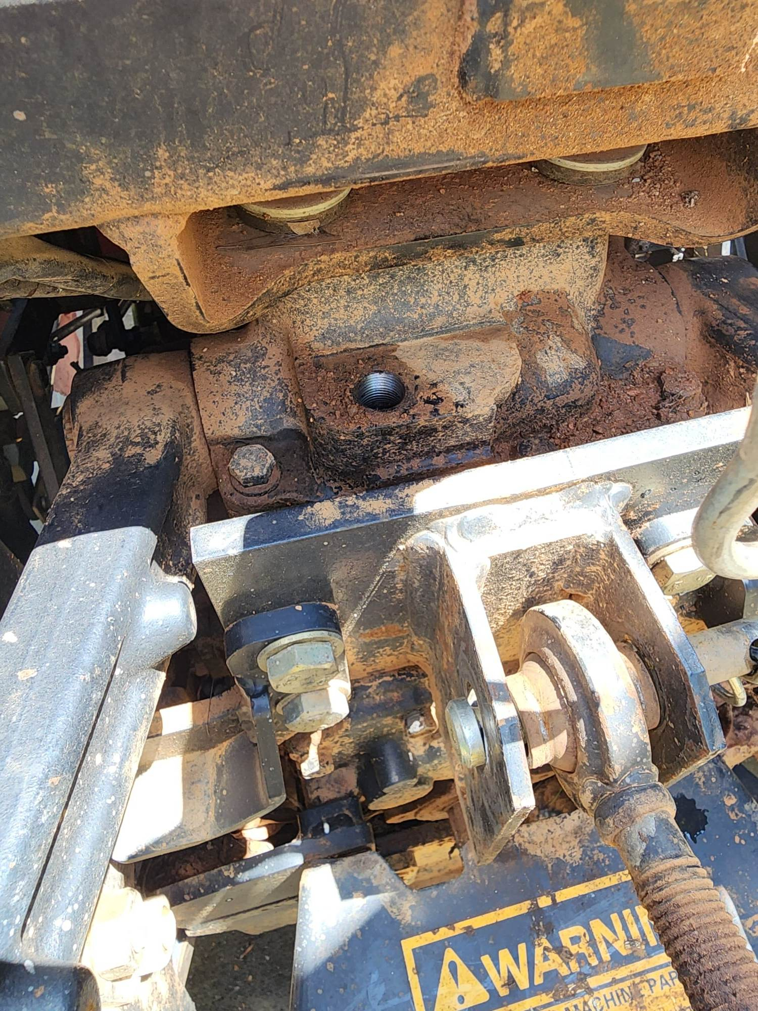

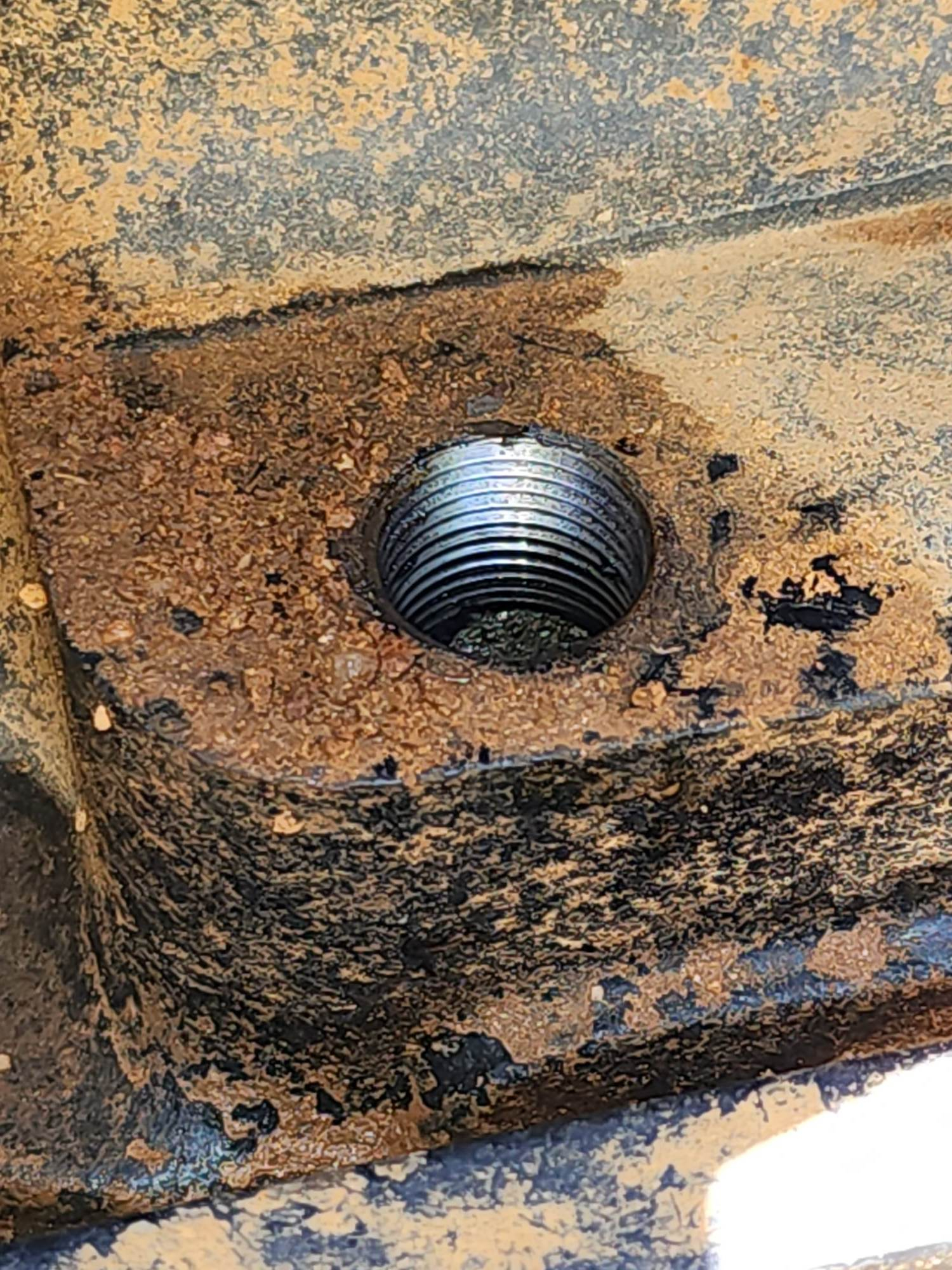

There's a plug on the top of the 3 point unit. I opened it and the 3 point is working. I'm investigating what that is and what, if anything, should go in it, lubricating or hydraulic wise.

/ Max26XL Hydraulics #53
View attachment 798377View attachment 798378
that is not removed in my photo's I have never touched it. I strongly recommend you clean the machine before you get dirt somewhere in that system
#54
Good point, I rinsed it off yesterday after spreading the fertilizer and will pressure wash it after I finish my spraying. I don't know why the 3 point started working after opening that plug. I see it in the service manual but there is no reference to it's purpose there or in the operator's manual. The 3 point is still working after I closed it.
/ Max26XL Hydraulics #55
you may have introduced some kind of large air bubble, you prolly vented it out of the system doing that. is everything working normal now that you removed that plug?
#56
Everything worked great today with the sprayer over a 3 acre pasture. Now I'm wondering did I really needed to buy and replace that $500 hydraulic pump. I filled the old one with oil and capped it. It might come in handy at some time.
