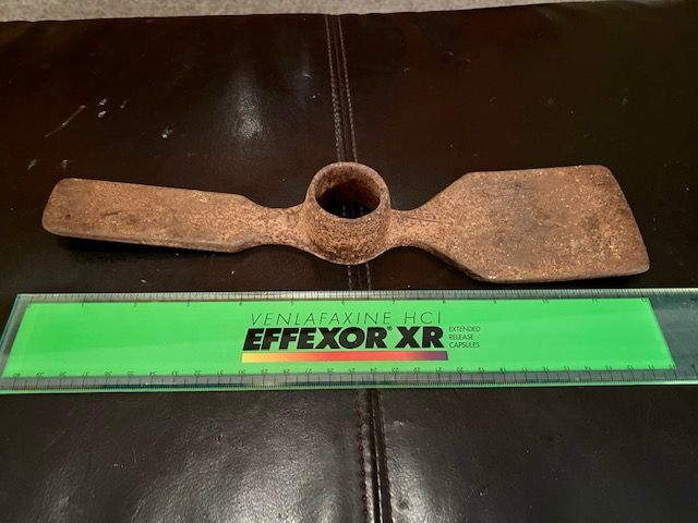

Why are mattocks not fixed on their handles? In other words, why aren't they fitted like axe handles, pick handles and sledge hammer handles? The old mattock I have has two nails in the handle under the head to keep it from slipping down. Been that way since I was a child.
I'm asking because I recently got a mattock head from my father-in-law's garage. It is less than half the size of a normal mattock which is really cool. It has some surface rust but is otherwise in great shape. I'm going to clean it up and make a handle for it. I have a lathe.
The opening for the handle is round but slightly cone shaped like a normal mattock so that the handle is installed from the top and is supposed to snug down on the handle which is also slightly cone shaped.
I'm just wondering if I should install the handle that way or should I consider wedging it like an axe handle.
Any advice appreciated.

Follow up to post #9 above. Cut a blank from the ash slab. Dried it over a heater vent for a week or so. Turned handle on the lathe. The handle hole is round and tapered. The ash was very hard. Took a long time to cut it down. Got a little tear out in a few places but sanded it smooth. Made handle long enough to use with two hands if needed. It is a fairly small tool and I gave it to my wife for her gardening. The handle is in the head firmly but I put a stainless screw in just in case.

I thought about narrowing it in the middle down through the grip for better appearance and lighter weight but figured I’d keep it thick for better strength.
