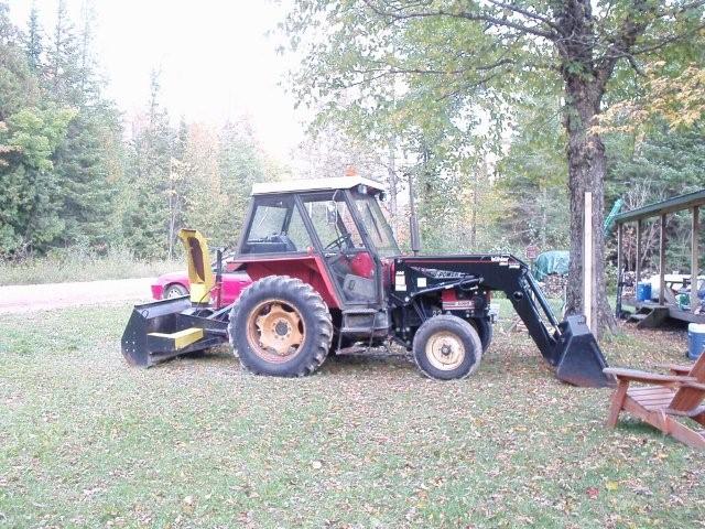

I use an Agri-Power 5000 (Zetor 5011) which has ten forward and two reverse gears. I run a seven foot Gruett rear PTO snowblower in low reverse, which is about 0.8 mph at 2,200 engine rpm and gives me 540 at the PTO. If the snow is too deep, I can always blow the snow in layers. I do not like riding the clutch too much.
