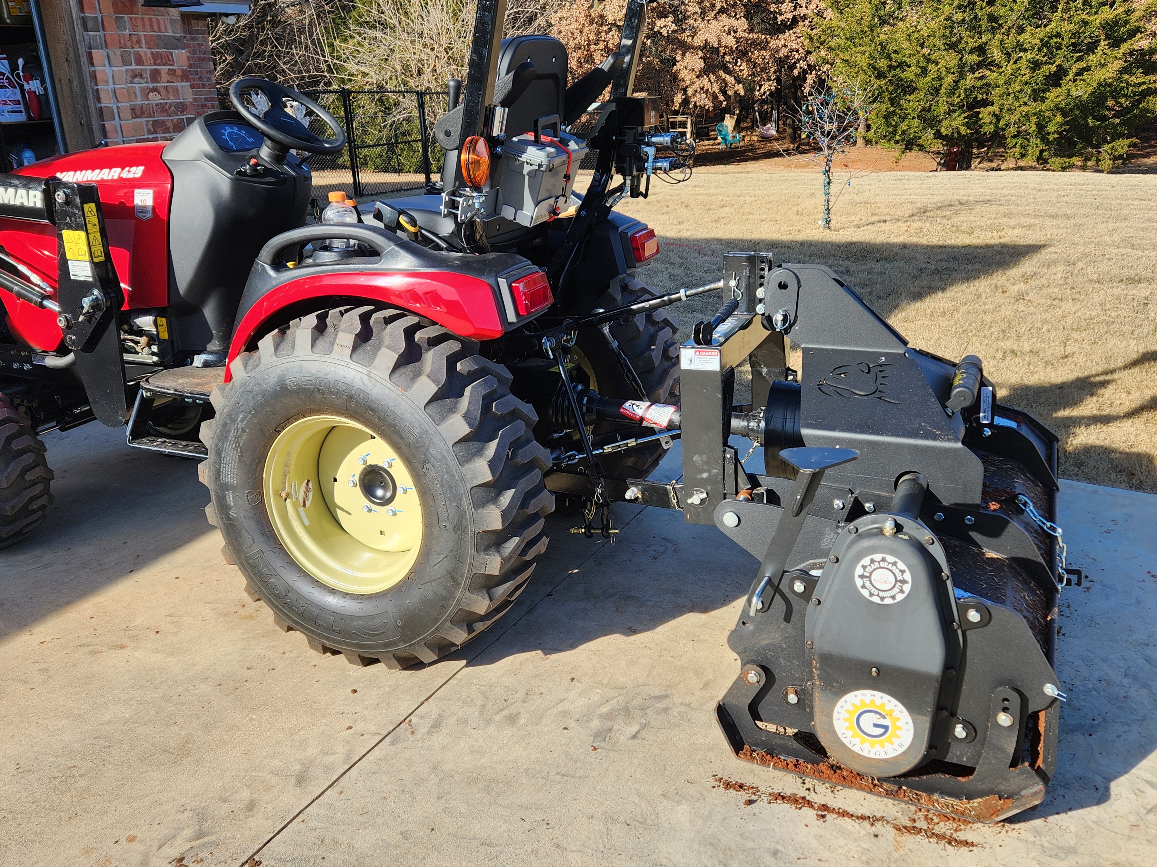

I bought a Bad Boy BBRT60 for my Yanmar 425. It has a 5 year warranty on the gear box and the tine shaft is gear driven. No slipping belts to adjust. Made in Arkansas. Quick hitch compatible. Weights 700 lbs.
Does great on Oklahoma red dirt and clay.
Had it since October 24. Go for the best gearbox you can.
Its also made in a BBRT45.
