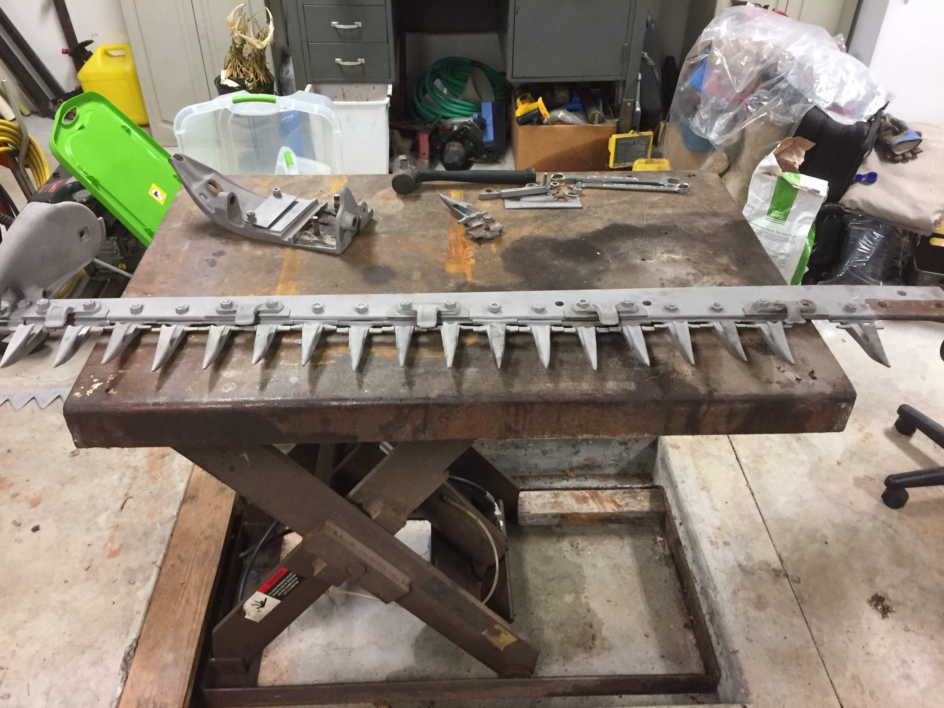

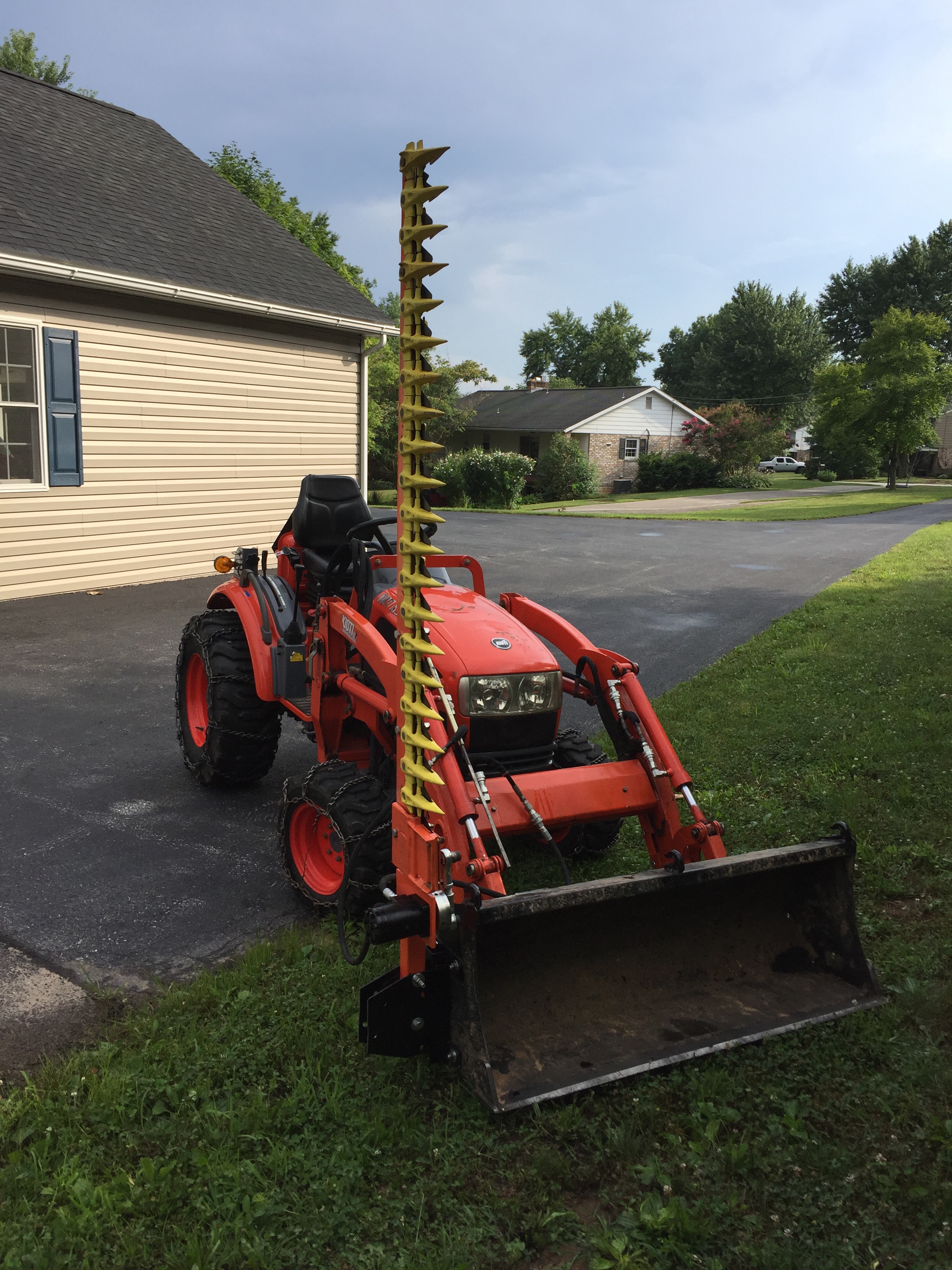

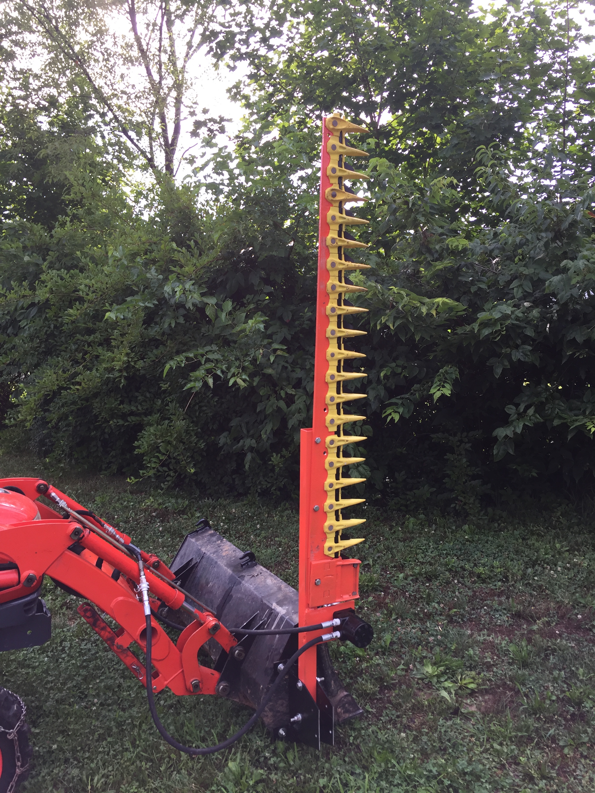

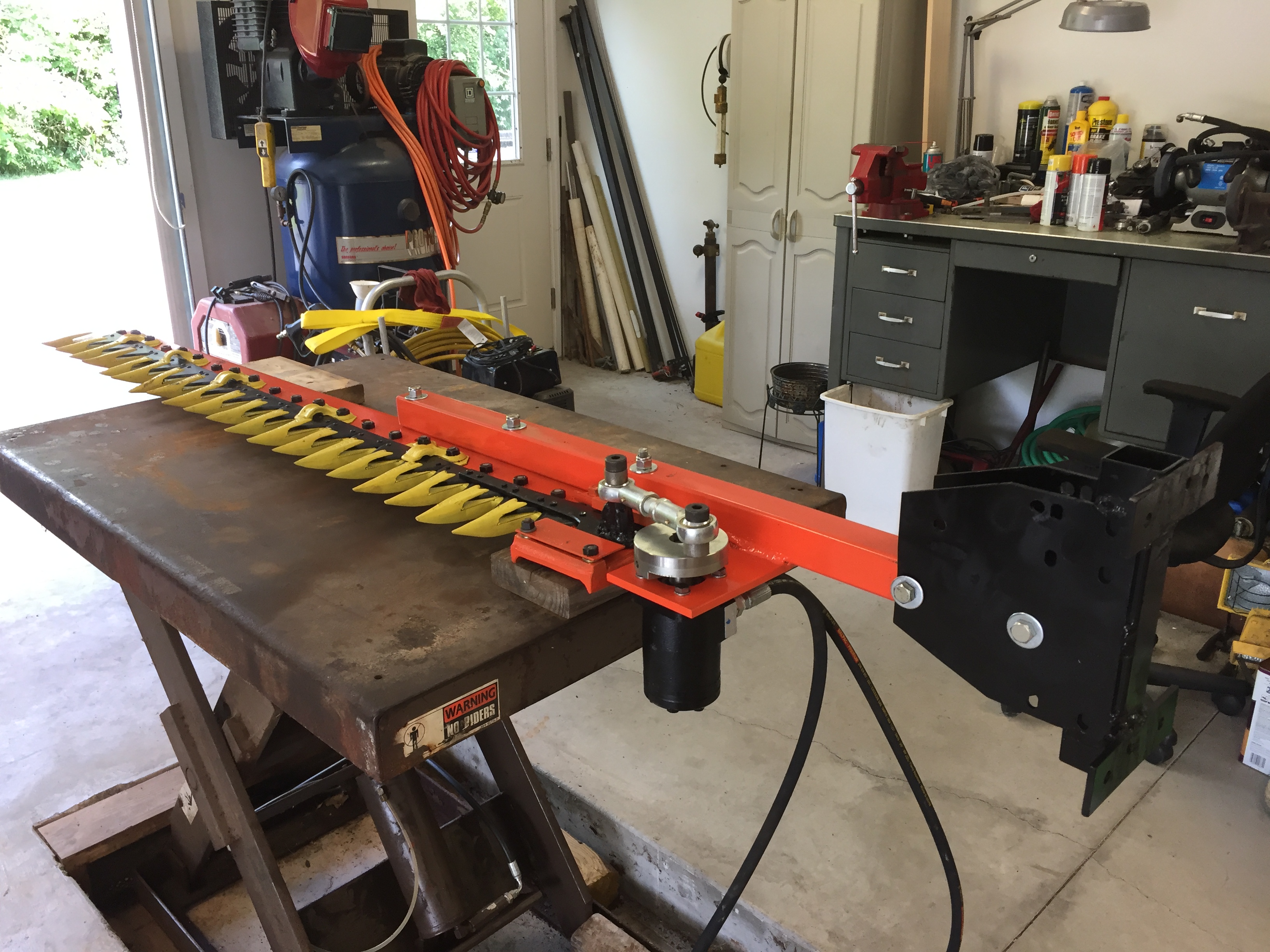

I have a hedge row that is about 250 feet long and it takes me several days every year to trim it with an electric hedge trimmer. I decided to build a man sized hedge trimmer for my Kioti. I went looking for a sickle bar for a Cub and found one. I sand blasted it and painted it then started designing a mount and drive system for it. I bought a hydraulic motor and machined an eccentric flywheel. I took it out for a test drive and it now takes me less than an hour to trim the entire hedge row.View attachment 564482View attachment 564479View attachment 564480View attachment 564481

Very nice! Do you happen to know the GPM that your machine is running through that circuit?
Well according to the spec sheet the pump will do 7.66 gpm. I knew that before I bought the pump. I wanted to run the motor at around 500 to 600 rpm so the one that I bought would be just about right with the lower gpm system.
/ Man Sized Hedge Trimmer #30
Thanks. The reason I ask is I have thought about that very attachment several times. My machine is all hydraulic. I have a hydraulic circuit that I run my brush cutter and mower with that puts out 8GPM@2500psi. Sounds very doable in my situation. Thanks again. :thumbsup:
