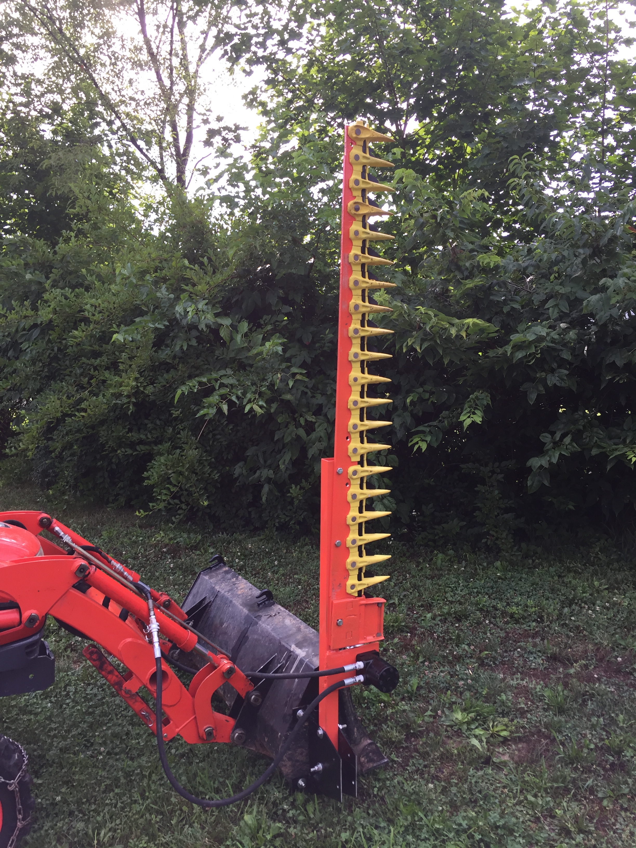

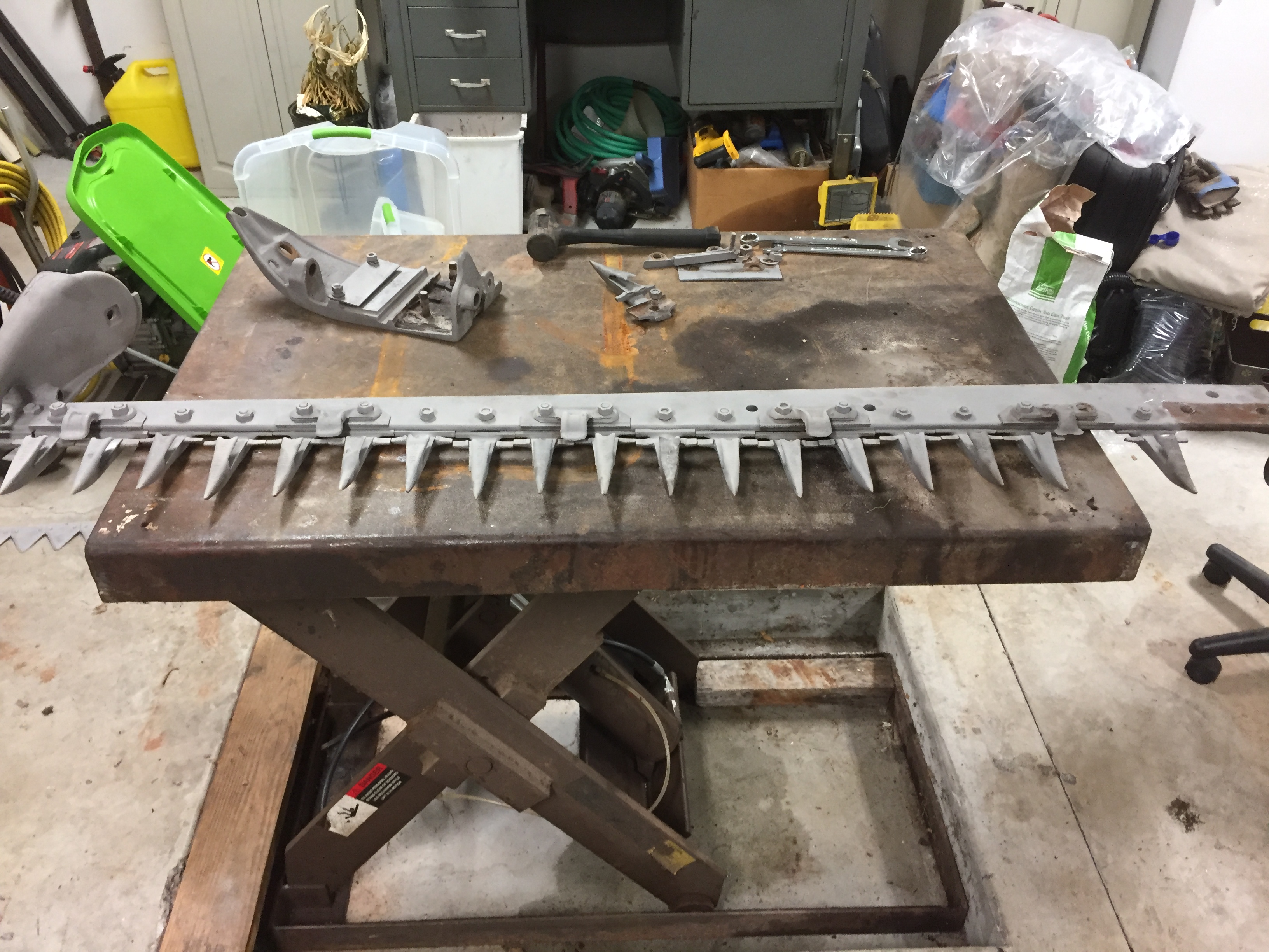

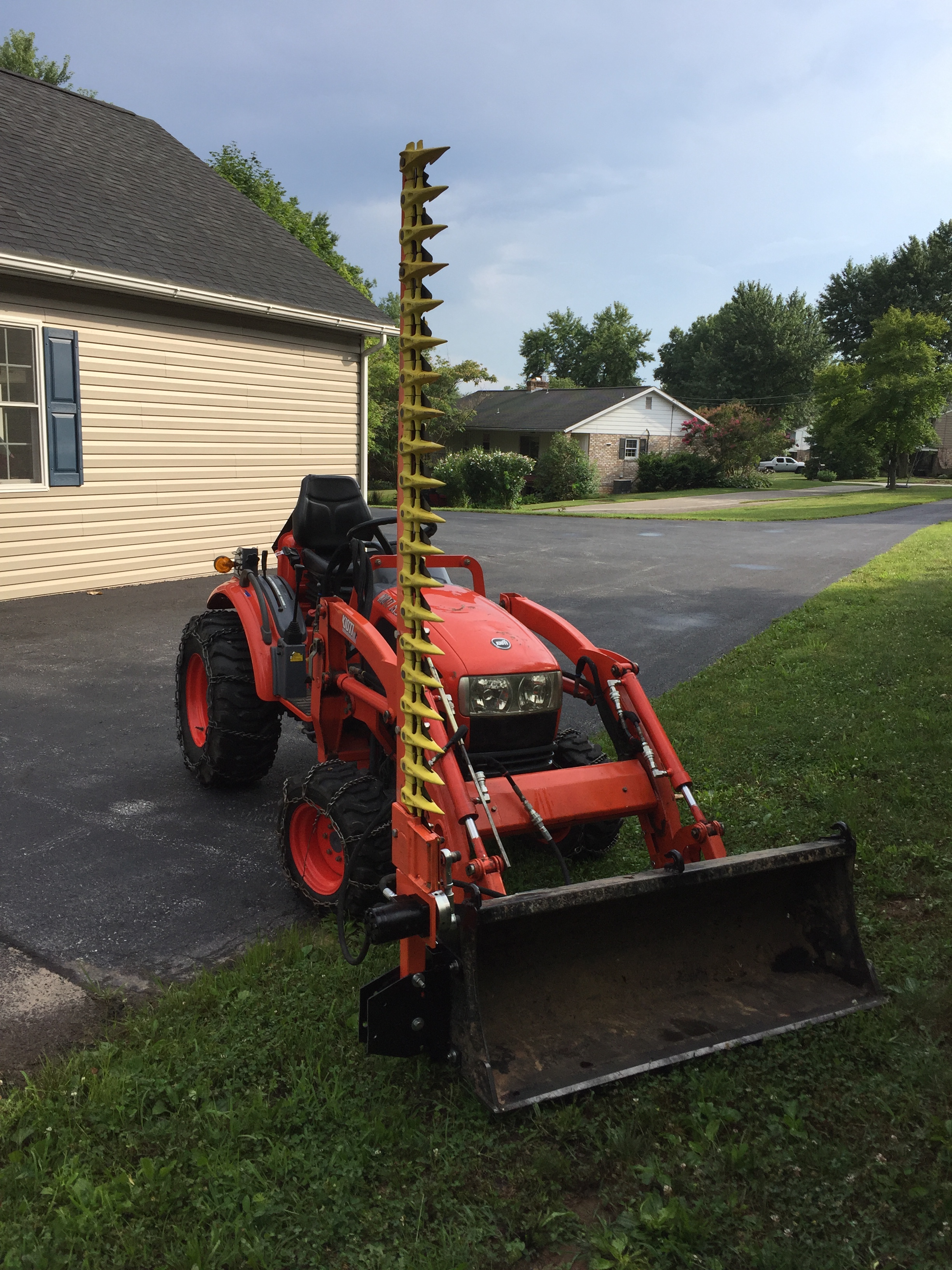

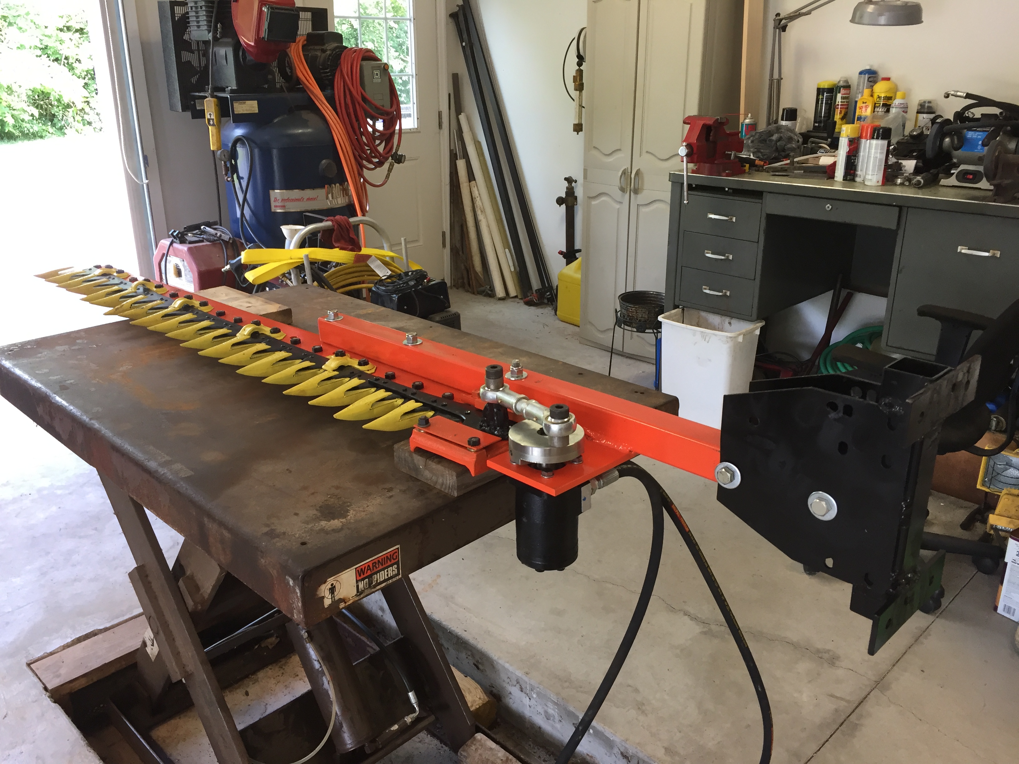

I have a hedge row that is about 250 feet long and it takes me several days every year to trim it with an electric hedge trimmer. I decided to build a man sized hedge trimmer for my Kioti. I went looking for a sickle bar for a Cub and found one. I sand blasted it and painted it then started designing a mount and drive system for it. I bought a hydraulic motor and machined an eccentric flywheel. I took it out for a test drive and it now takes me less than an hour to trim the entire hedge row. IMG_0199.jpgIMG_0223.jpgIMG_0224.jpgIMG_0217.jpg

Very nice. It looks like you have it set up so you can trim either vertically or horizontally.

Thanks
Yes, it has three positions, it will do vertical above and below the bucket so it can trim down to ground level.

Are you using tractor hydraulics to run it or a separate pump?

I am running it with the onboard hydraulics. I added an 12 volt solenoid with quick connectors that is connected to the tilt on the joystick for the FEL. Now when I use the trimmer I just throw a switch on the dash and it changes from the bucket to the trimmer. Now I have the ability to reverse the direction of the motor to unjam the sickle so I can run it back and forth until it cuts through large limbs. The solenoid also gives me the ability to have tilt on my snow blade in the winter.
