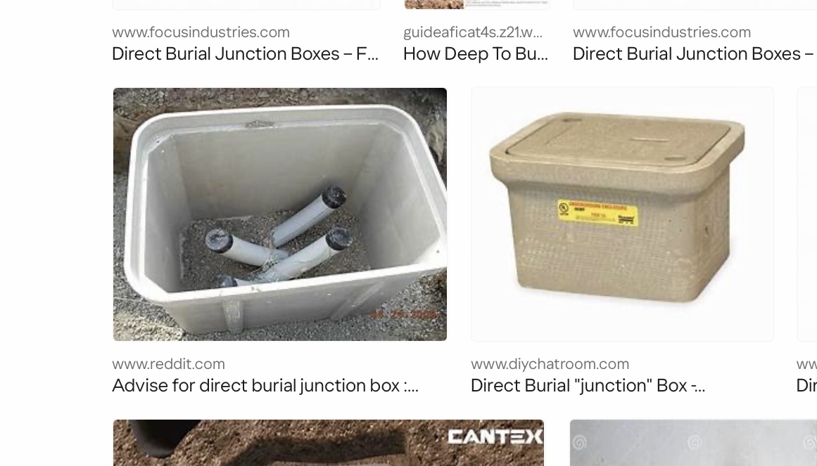

As far as I know it has to be in a box. Unless this will work?

There has to be some place on that 65 foot run where an outlet box would be useful. Closer to one end or the other would be nice (save on wire). But, Do it right! Use a box and wire nuts if nothing else.
Heck! Put in TWO outlet boxes "somewhere" . A good layout might not waste much wire at all, and provide some convenience.
